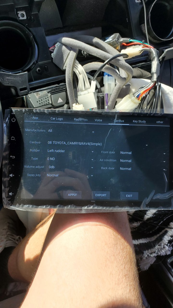

    Sitting here trying to get wheel controls to work. Some everything mentioned so far in here. Any help ?

    what is not working?

    If you wish to flip the next track buttons, last line left side of the pick you posted, change it to swap

    Any steering controls. Got nothing

    Power down. Make sure the brown canbus box is connected correctly. Reseat the connectors on the three main harnesses and then power back up.
