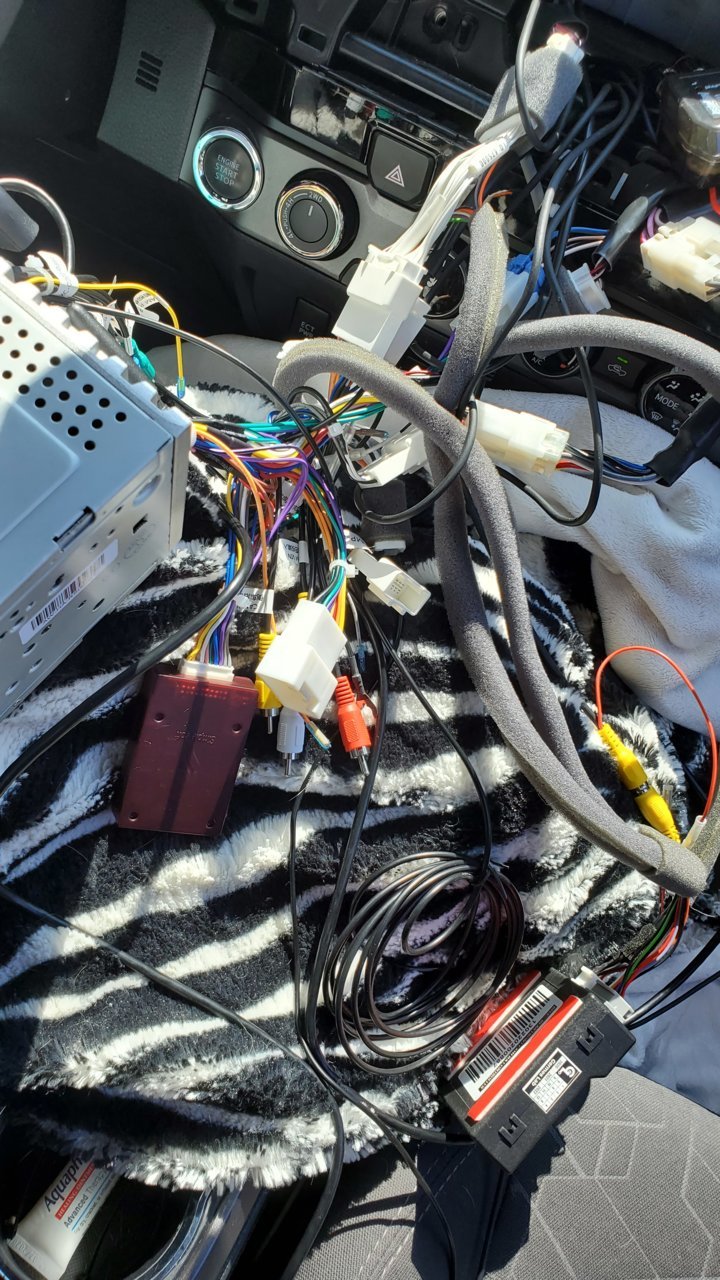

    Tried that. Still nothing. Must be something wired wrong.

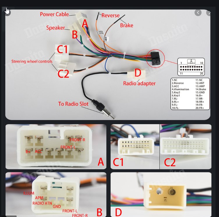

    Your harness looks like this correct? If so, which of the white connectors is not plugged in to your vehicle harness?

    Those two white ones aren't connected to anything.

    For steering wheel controls to work both C1 and C2 must be connected and the Canbus module must also be connected.

    Additionally, is your anytime camera controller powered? That controller has a jumper harness that is inline with the steering wheel controls. They may not work if the front/rear camera controller is not powered. To test this, disconnect that controller jumper and put the vehicle wiring direct to the headunit wiring.

    will try this. was hoping i would still be able to use my front and rear cam controller. but ill rewire..appreciate the map

    This was the problem. I connected to the controller to a 6V line and everything worked.

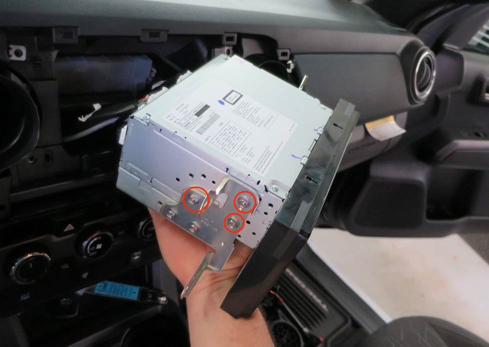

    -The oem brackets did not line up. I bought another set for this install and used the template method noted above.

    If you can, post a pic of the bezel fitment. I have two people asking about my PX6 system so this may be an easy swap.

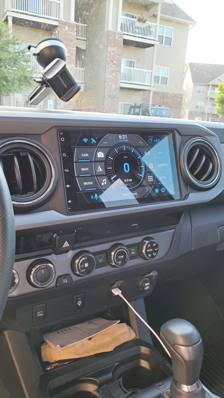

    so a couple things ive noticed so far..
    1. This thing is almost impossible to see in the daytime, its basically just a mirror for my left rear window. ( gonna need to try an antiglare film, although i think the brightness at 100% just isnt enough)
    2. whenever i reverse the back up cam comes up but then it doesnt shut off unless i press home. (also the cameras seem to have a lower quality, maybe its just the stretched image on a larger screen)
    3. I get little audio static when switching songs, this just started today.
    4. is there any other bluetooth player besides A2DP? I hate it doesnt autoplay when i get into the truck.

    1. I would not say mine is that bad but even with my stock radio I could see anything so this has been better. I do need the anti glare as with polarized sunglasses you cant see much.
    2. Likely this is the issue. You can always look into a different camera other then the stock one if it bothers you. Its def less res then the HU wants on the rear. I have not hooked up my front yet.
    3. Try checking your connections. No issue on my part.
    4. You can always download pretty much any android app to use for audio players. There are tons of them. I believe you can set one as a default in the HU similar to the preferred Nav app. I mainly use CarPlay fro audio.
