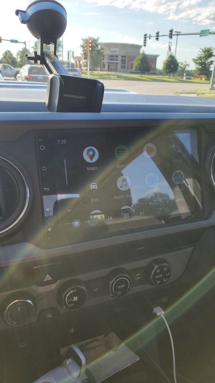

    yeah i just need to get an iphone as carplay is superior. The fact that android makes the head unit but they cant support wireless android auto but i have wireless apple carplay is annoying. Also apple has split screen car view now so thats where I need to be to solve most my issues.

    yah google is a bit of a shit show. If you click on the mode that shows all current open apps (give you have a up to date OS or the Hal9) If you hold the app you can drag if left or right for split screen as well. I still use carplay mostly as I do not have an internet connection on the radio and my hot spot never stays connected long enough.

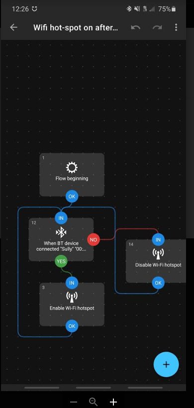

    for my android users. There is an app called automate where you can create automated tasks and whatnot. i downloaded one from the community section of the app (search wifi hot-spot on after BT connected) that enables hotspot when the bluetooth connects to the headunit. (just make sure you select your headunit as the bluetooth device within the flow.) This works and will enable your hotspot without having to manually do it each time.
    iphone users im sure you could do something very similar using shortcuts. Theres a whole community of people that make some wildly advanced ones.

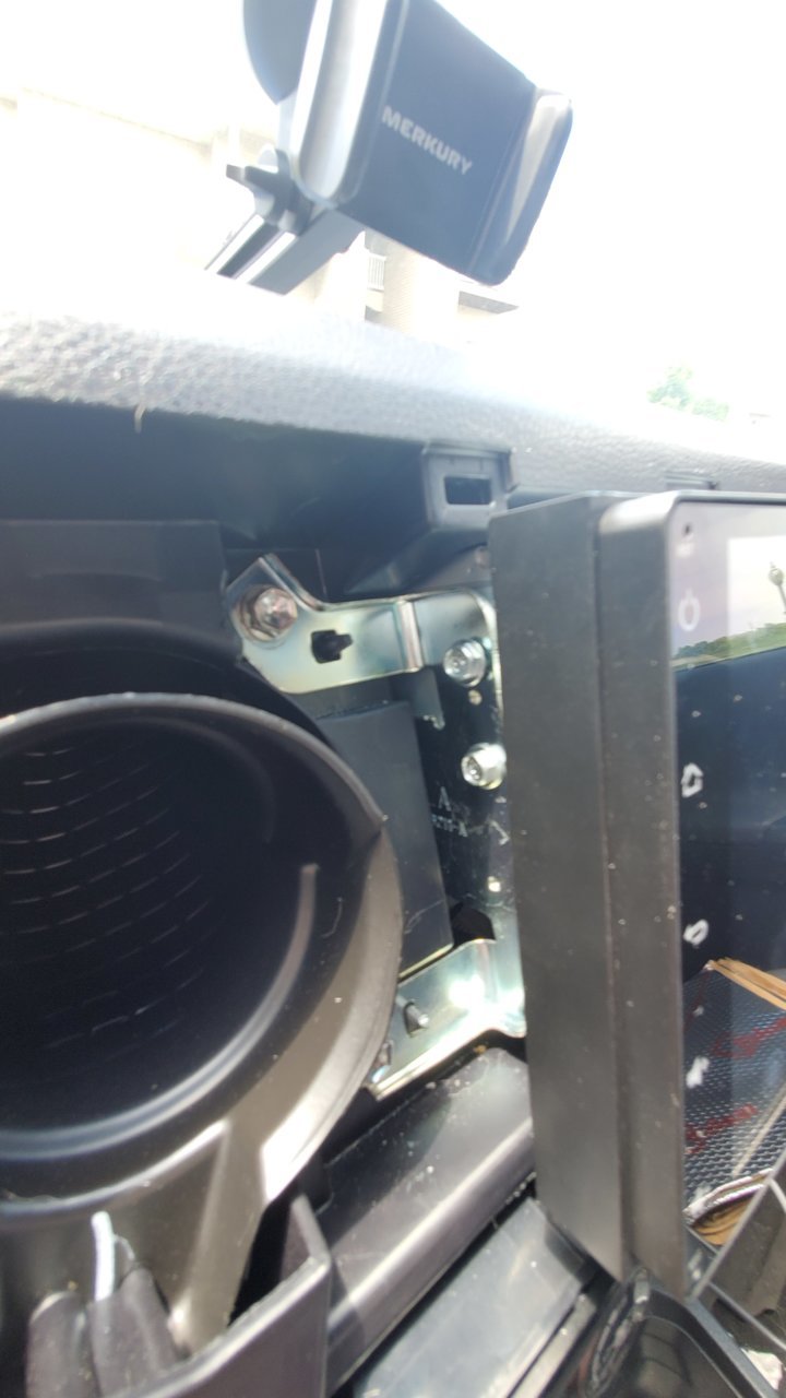

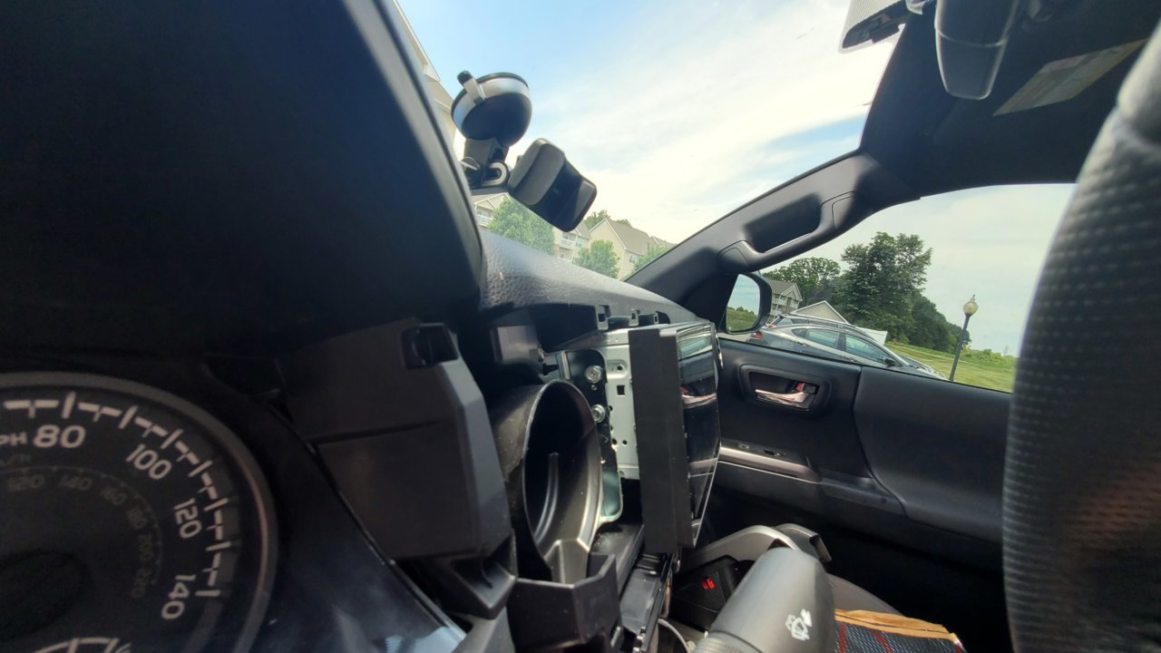

    Here’s a video of my struggles with mounting the premium bezel back on after installing the px6 head unit. Maybe you’ll notice that I have the after market mounting misaligned somehow.
    https://streamable.com/wynka7
    I eventually read through this thread and ended up installing the factory rails onto the head unit. That seemed to Sit better. Still a no go!
    I gave up, let this rock for a little. Then it popped back out :) https://streamable.com/wzwwzr
    Last resort - Feels more secure, but still shit: https://streamable.com/5hbo8l
    Any tips? Video of how radio sits with factory mounts
    https://streamable.com/sczfu4

    ^^^Yeah mounting wasn’t fun, if you look way back I think I posted pix of my modded Schoche bracket, you really need some slotted screw holes to get it to sit just right

    Last resort failed lol. Came into the truck this morning to find the bezel on the floor.
    Honestly, what did people do exactly to get this fit correct?!

    if the bezel popped off then i think your not tucking the harnesses away properly. Sounds like your head unit isnt in far enough. Tuck the harnesses below and off to the side... Have the oem bracket in place with the 10mm bolts hand tightened. Once you do that youll see one area where bolts line up to connect the bracket to the radio. Honestly one bolt on each side is all you need, its all i have on both sides.
    if your using the plastic crutchfield bracket then you have to shave a bunch off to make it work.

    2019 Taco SR5
    MMM, THANKS FOR THIS! I'll have to check mine out again in the morning. I rewatched my video just to get a quick look of my placement and it looks like I have the top spot of my bracket much higher than yours.
