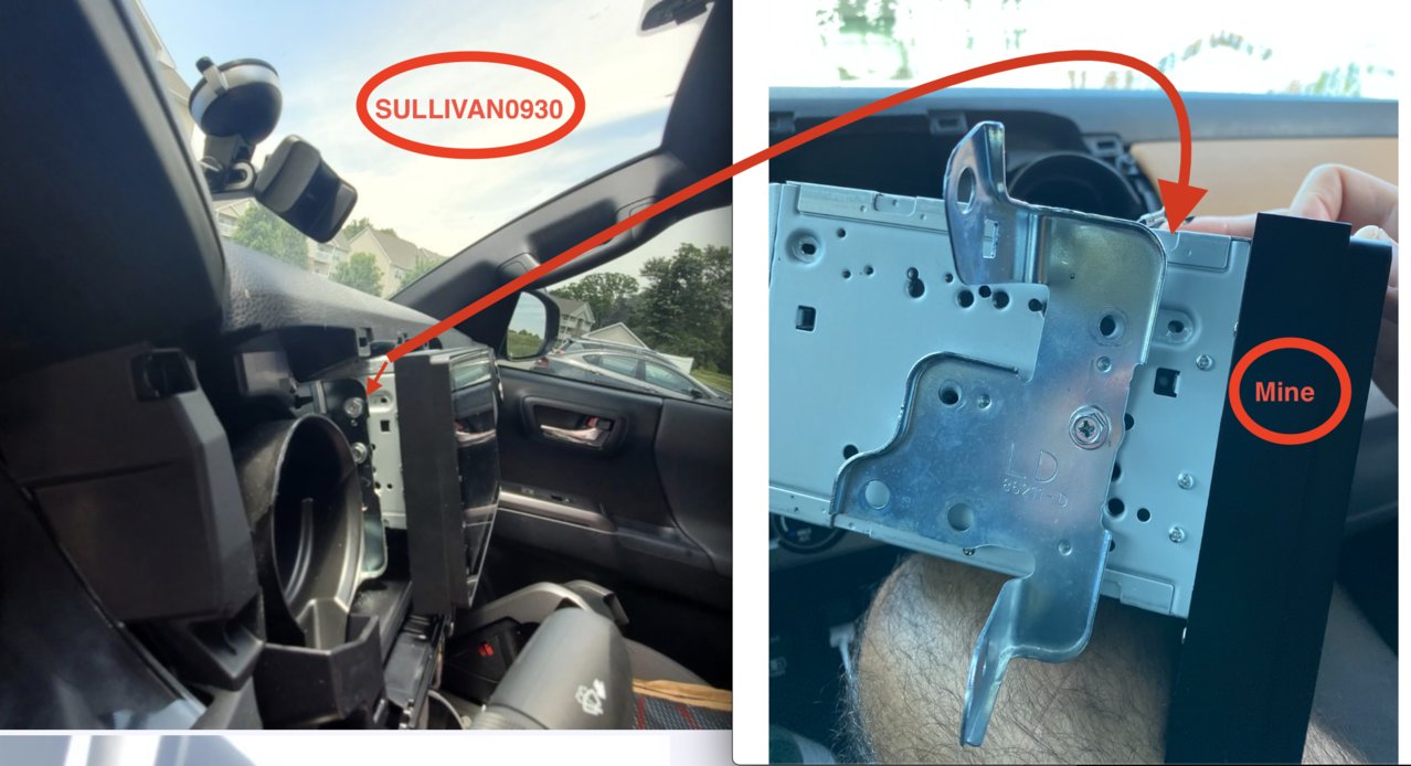

    @Capitol_Taquito Thank you! I figured, I'd compare my bracket to @Sullivan0930 after he was kind enough to share his photo.
    I noticed that the [top] portion of his bracket sat much lower than mine. I went out to the truck this morning, and 2+ days of work, only took me 5 minutes after seeing that photo! My Dash Bezel and PX6 are now perfectly installed / flush.
    - Dropped the bracket slightly to match Sulli's install, using only 1 screw on each side locks this in place just fine.
    - All four panel screws used to mount radio to dash
    Thank you both for the help @svermilyea and @Sullivan0930

    Glad the pic helped. The brackets aren't nearly as bad as this thread made them seem. You could also sneak a second screw on that bracket. I have two on my sides. But one or two screws the thing isn't gonna disengage from the bracket.

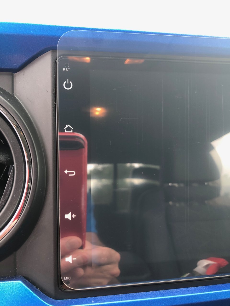

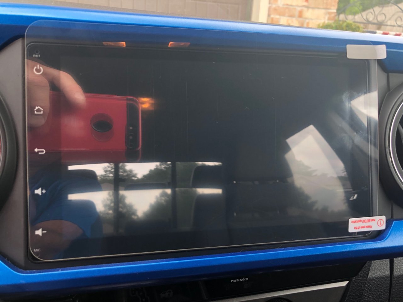

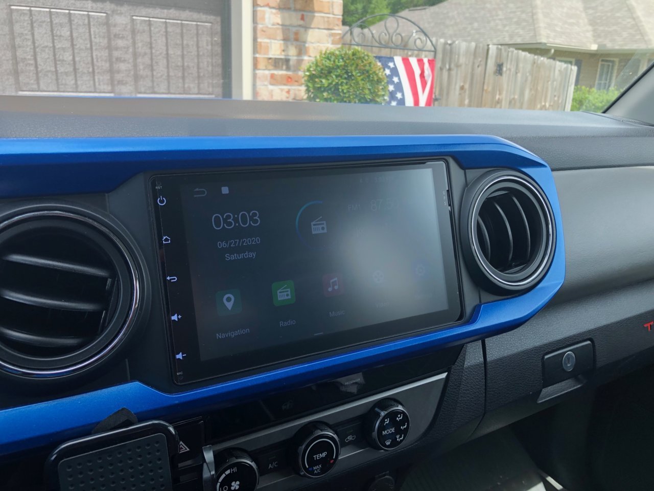

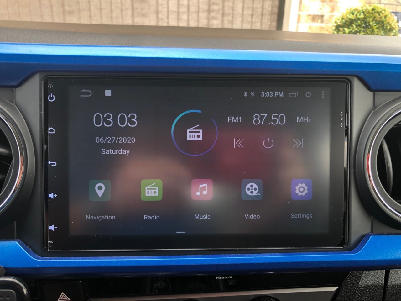

    Got in the DMax Armor screen protectors today, had to trim this thing big time, used a flatbed paper cutter. I'm not thrilled with the results either as the screen still has a ton of glare, see pics. I almost prefer the super clear screen with fingerprints as opposed to this. I had ordered a pair of ShadyRays unpolarized to keep in my truck to get around the issue of not being able to see the screen from side view with polarized shades...just thought I'd share my .02
