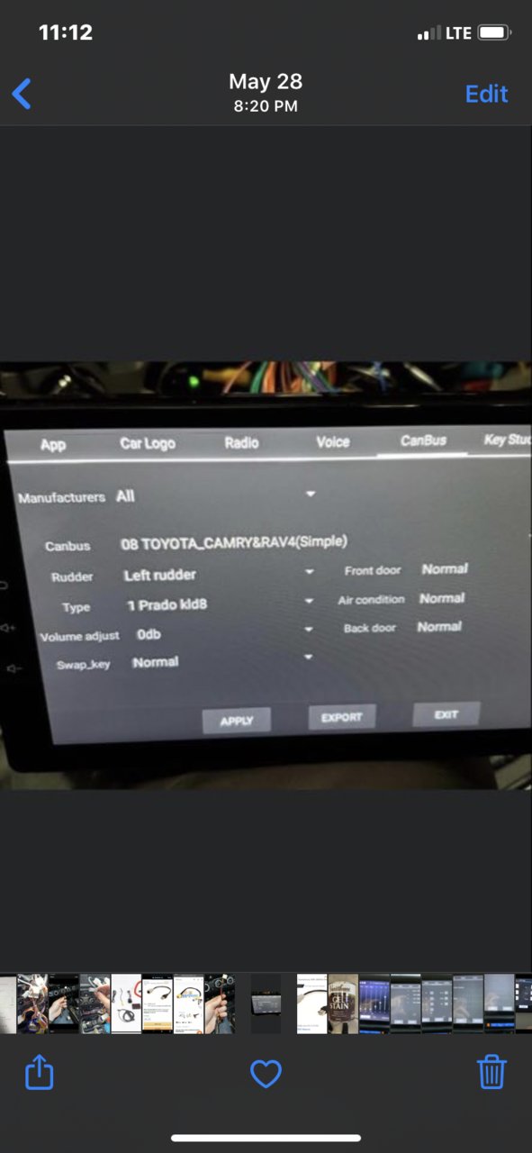

    So got everything hooked up and everything works (GPS, radio, WIFI, Phone/Bluetooth, Navigation, rear view camera) except steering wheel controls (2014 Tacoma). I went into settings and it showed a screen with reset and save tabs and it said to press the steering wheel controls. Tried them all and nothing works. Am I doing something wrong here???
    Slogging through everything in this thread. Where do I go to enter the 126 code before going to car setting??? Very much appreciate the help.

    Settings-car settings-factory-126. Look under the canbus tab. Try these first to see if it works. Make your screen match this. Then apply then exit. Unit should restart and new settings stored.

    That worked and thank you very much. Need to change one of the buttons but good to go for getting there to do so.
