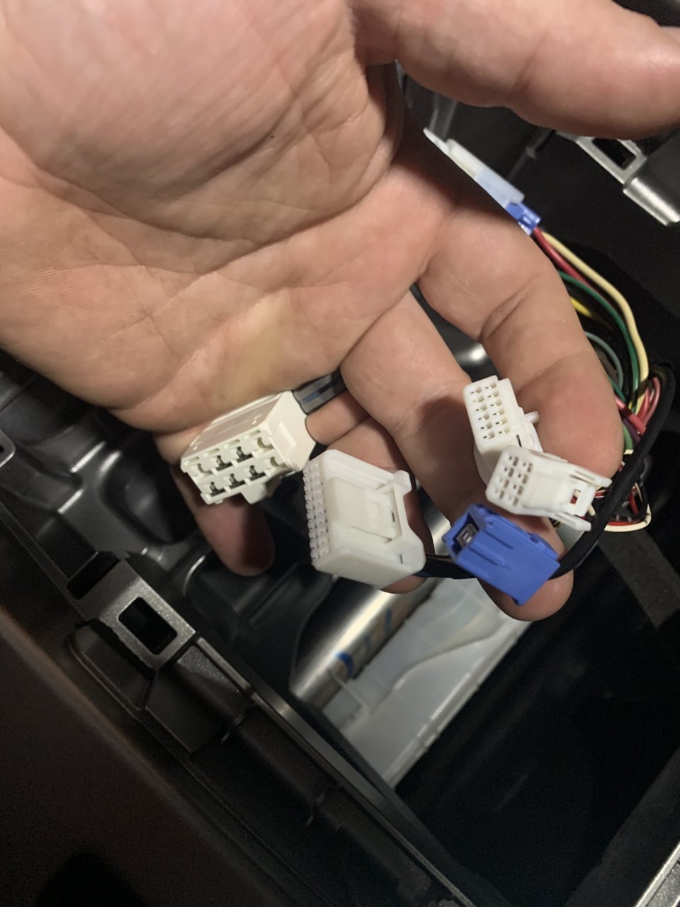

    DarthR2D2 Well-Known Member
    Jan 30, 2017
    #209068
    83
    Jason
    17DCLBSPORT4X4
    When using the male sma adapter into the female OEM GPS connection, is it suppose to snap in? Mine just slides on without hearing a click or snapping together. My gps does not work when testing in the menu, nor does the Speedometer on the screen change while driving.
