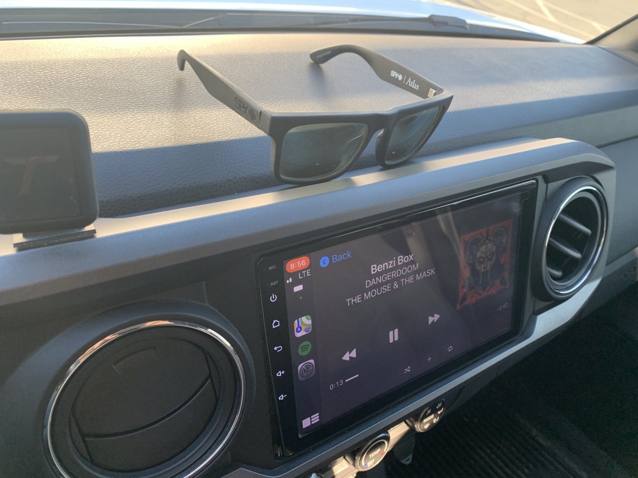

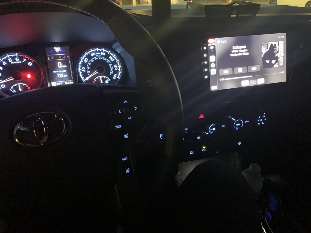

    *Car trim edition
    Just did this mod and love it, sound system sound 200% better. Bluetooth doesn’t drop off anymore. CarPlay is flawless and i love the multi functioning of this unit
