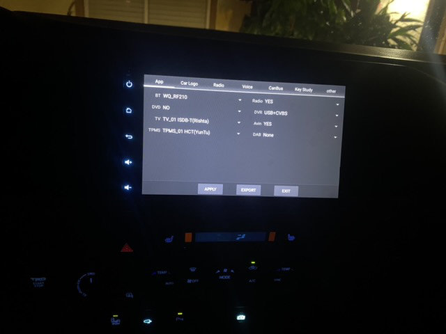

    I almost wonder if your canbus module is bad.

    Have you gone into the the setup mode, factory setting and ensured the Canbus adapter is programmed to the correct model?

    Yes. Select the Canbus Tab. Ensure you are set to the Toyota Camry setting with all additional canbus settings as default.
