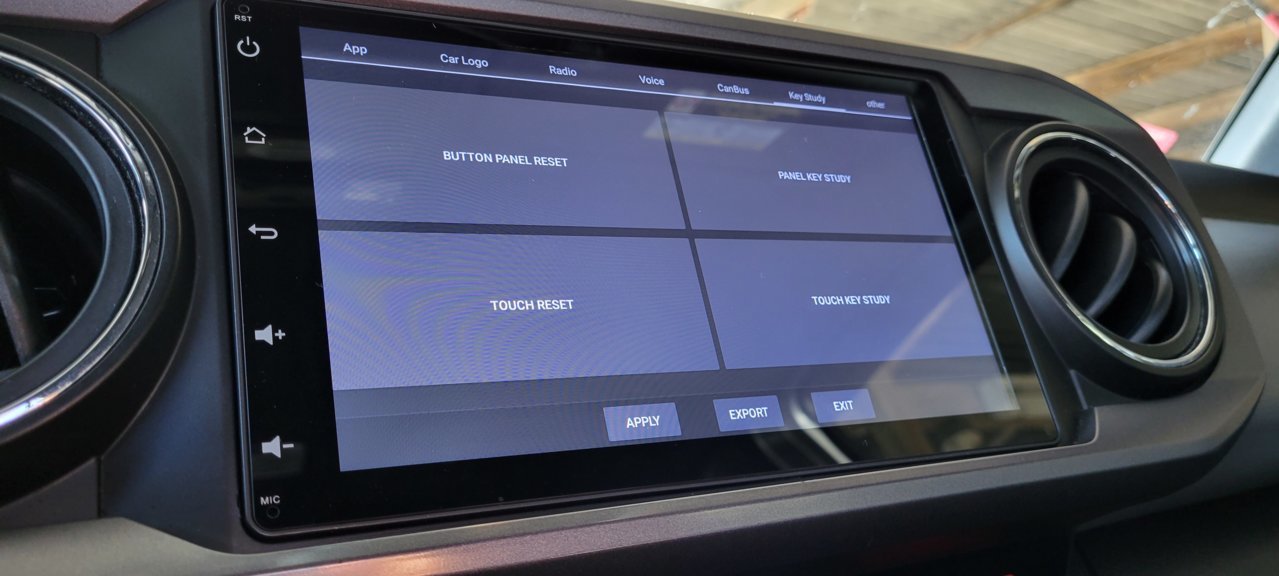

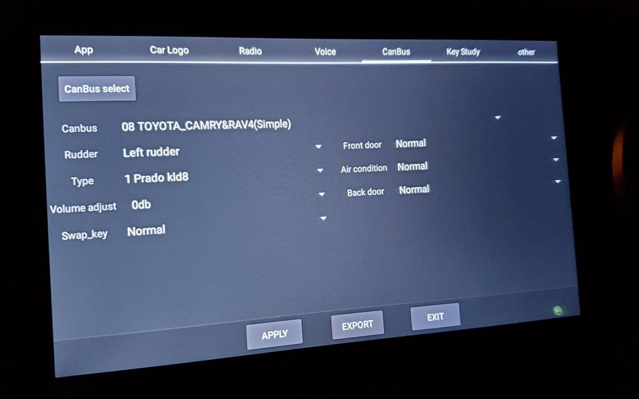

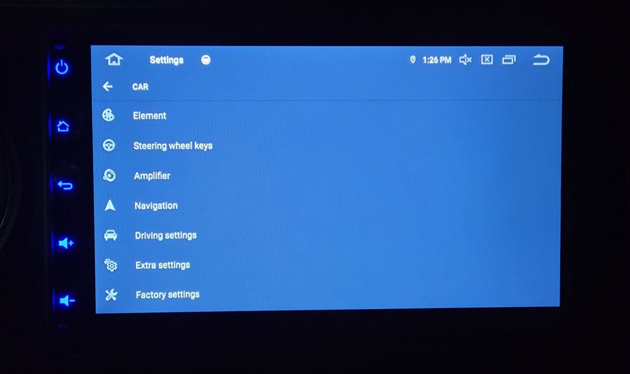

    Kind of stumped here, if anyone can help, I have the ability to get to the 126 factory settings and I have matched everything in the canbus tab to a previous posters screenshot. However, my steering wheel "previous track" and "next track" buttons are still backwards from the factory settings. Volume up and down works fine. It's just that skipping to the next track actually restarts the current playing one for me. The screen where it should allow me to remap is still blank.

    Check out the "key study" tab. You can assign a SWC to any action you desire.

  10. Oct 12, 2021 at 3:24 PM
    #1490
    SxDx
    SxDx Well-Known Member
    May 19, 2011
    #56904
    441
    TX
    This is what that screen shows me.

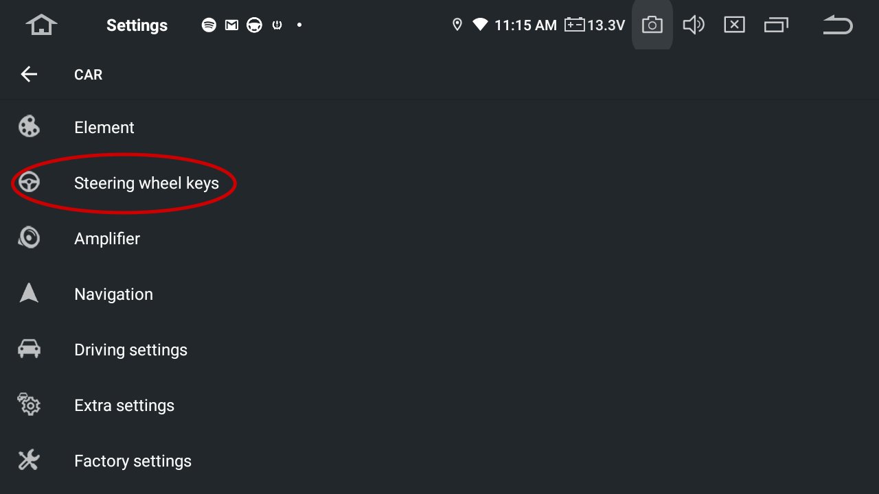

  11. Oct 14, 2021 at 10:34 AM
    #1491
    TheTacoAbides

    Let's try this again. Select the Key Study from this screen:
    You will be able to assign actions to the various steering wheel controls. There is a short press action and a long press action for each recognized steering wheel control. You want to press the SWC and then you can select from a list of actions that you want the key to send.

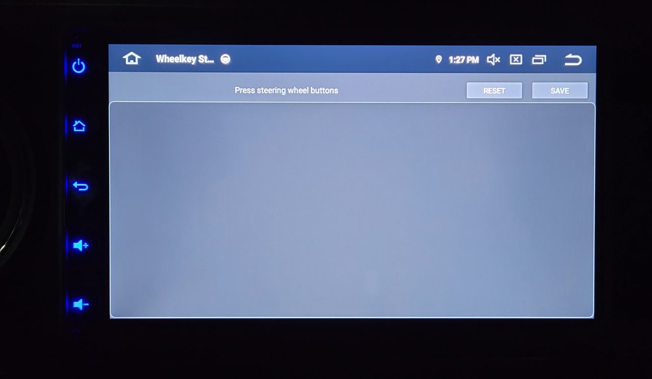

  12. Oct 15, 2021 at 12:48 AM
    #1492
    SxDx
    May 19, 2011
    #56904
    441
    TX

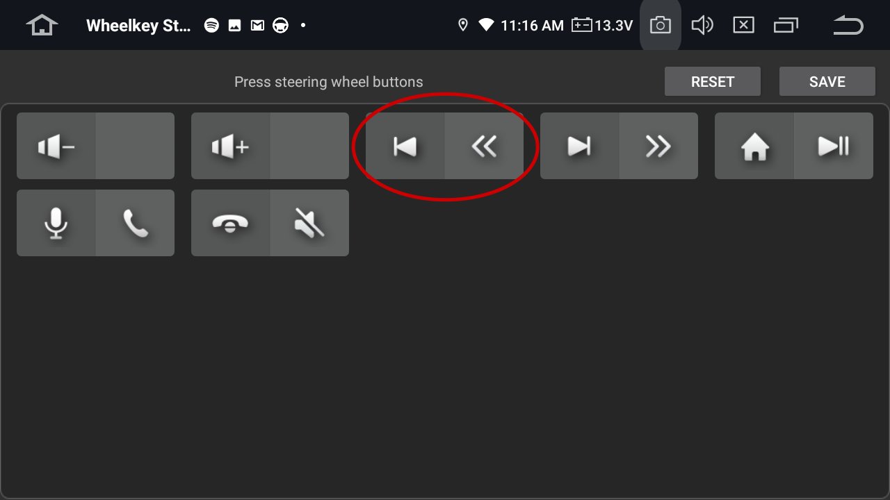

    This is what I get when I do that.
  13. Oct 15, 2021 at 10:52 AM
    #1493
    TheTacoAbides
    TheTacoAbides Well-Known Member
    Nov 4, 2017
    #235007
    127
    Randy
    2013 Black Tacoma SR5
    Rough country 3" lift and level. Tuff AT 20" rims. Nitto Terra Grappler G2.
    When you get to the second screen, you should then be able to press any of your steering wheel control buttons. It will give you a two part box that allows you to define a short press and long press action for the selected button.
    If you are not getting a response from the steering wheel controls, then you need to make sure that your harness is correctly identified. For the CANBUS users, it needs to have the appropriate harness adapter and then when the CANBUS is activated you need to select the right vehicle family on the Dasaito (I believe it was the Camry family IIRC).
    My experience with the 2013 non-JBL flavor was that I was able to use a CANBUS adapter approach and activate all the steering wheel controls. However I did not really require the aux backup camera input so I ended up removing the adapter and using the basic resistance mode of SWC. That worked for me and simplified the wiring.

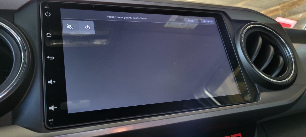

  14. Oct 15, 2021 at 11:50 AM
    #1494
    SxDx
    May 19, 2011
    #56904
    441
    TX
    While on that screen that says to press the steering wheel buttons, it does nothing. No response from the skip track buttons, volume + - works as normal on that screen. I do have the Canbus identified as Toyota Camry as suggested. I believe the harness is correct because the volume buttons are working and the skip track does work while playing USB music or Spotify but like I said they are reversed in what they do. I guess I can get used to it, I was just trying to retain the original functions.
  15. Oct 15, 2021 at 12:19 PM
    #1495
    TheTacoAbides
    Nov 4, 2017
    #235007
    127
    Randy
    Dude - sorry you're having to go through this. It's no fun trying to find the secret code to just make things work.
    If you have the stomach for it, I would recommend the following: Just to help in isolating the potential problem area, remove the CANBUS harness from the equation and restart the unit (the default harness should work fine - even on CANBUS audio enabled trucks). Go into settings and change the CANBUS setting to none. Go into the Steering Wheel Key section and press a SWC to see if it presents the option to program it. If it does, then proceed with all the keys that are available. Then you can go exercise with the application of your choice to see if you get the actions you expect.
    If this works, then it means something is suspect in the CANBUS harness area and there are some diagnostics to try in that area. If it doesn't work then I would focus on the radio interface point itself. Something in the family of bent pins or poorly terminated wiring.
  16. Oct 15, 2021 at 1:12 PM
    #1496
    SxDx
    May 19, 2011
    #56904
    441
    TX
    Thank you for your detailed help, I really appreciate it. I'm actually going to pull the unit sometime next week so that I can plug my original in because I forgot to remove a CD before I swapped the head unit. I will definitely take advantage at that time and fully inspect wiring and other options. Thanks again!

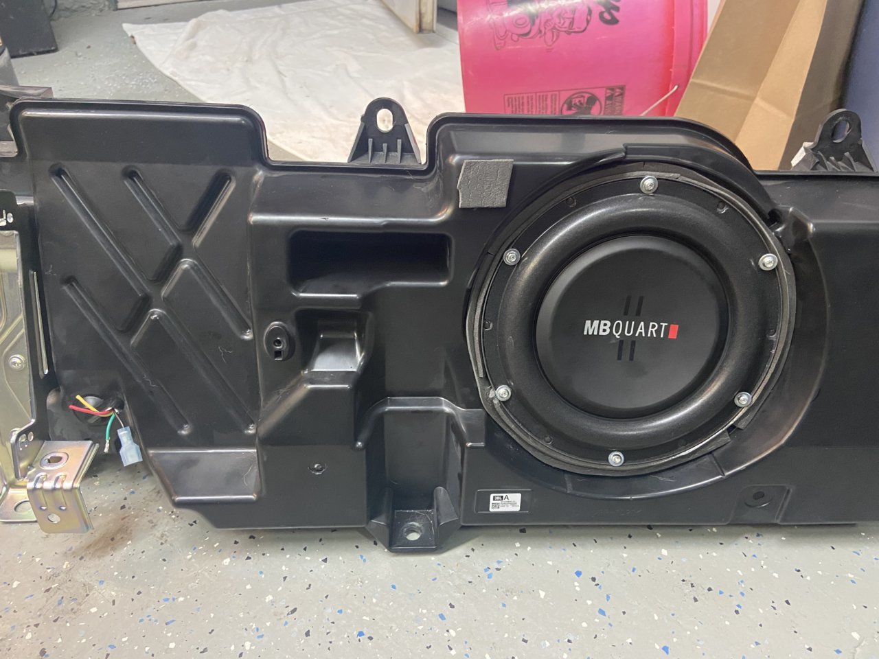

    Hi all, I just finished my stereo instal today, I yanked a perfectly good Dasaita out of my 2019 Pro. It had all the connectors, canbis, steering wheel controls adapters and connections for the USB’s, and audio ports. All the gps antennas. It worked well but I wanted something that played nicer with Apple. It does have wireless CarPlay. it just works better with android.
    Anyway, I’m selling it as is with all the parts minus the mounting bracket because I reused it for the pioneer.
    If you’re interested, pm and we can talk about pricing.
    I also have the oem sub box, and rear cab panels for sale. Sub box is loaded with an mb quarts shallow 8”.
