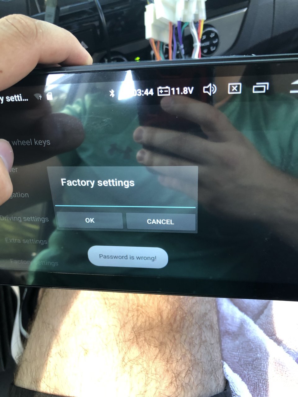

    I can’t get the steering wheel controls to work, the back up camera or carplay with the dongle anyone know? As far as I know I have everything connected. Is there a separate connection for the back up camera?
    Also what’s the password?

    i believe the code is 126

    Alright that worked. Which one did you guys choose? Thank you! now just need carplay to work

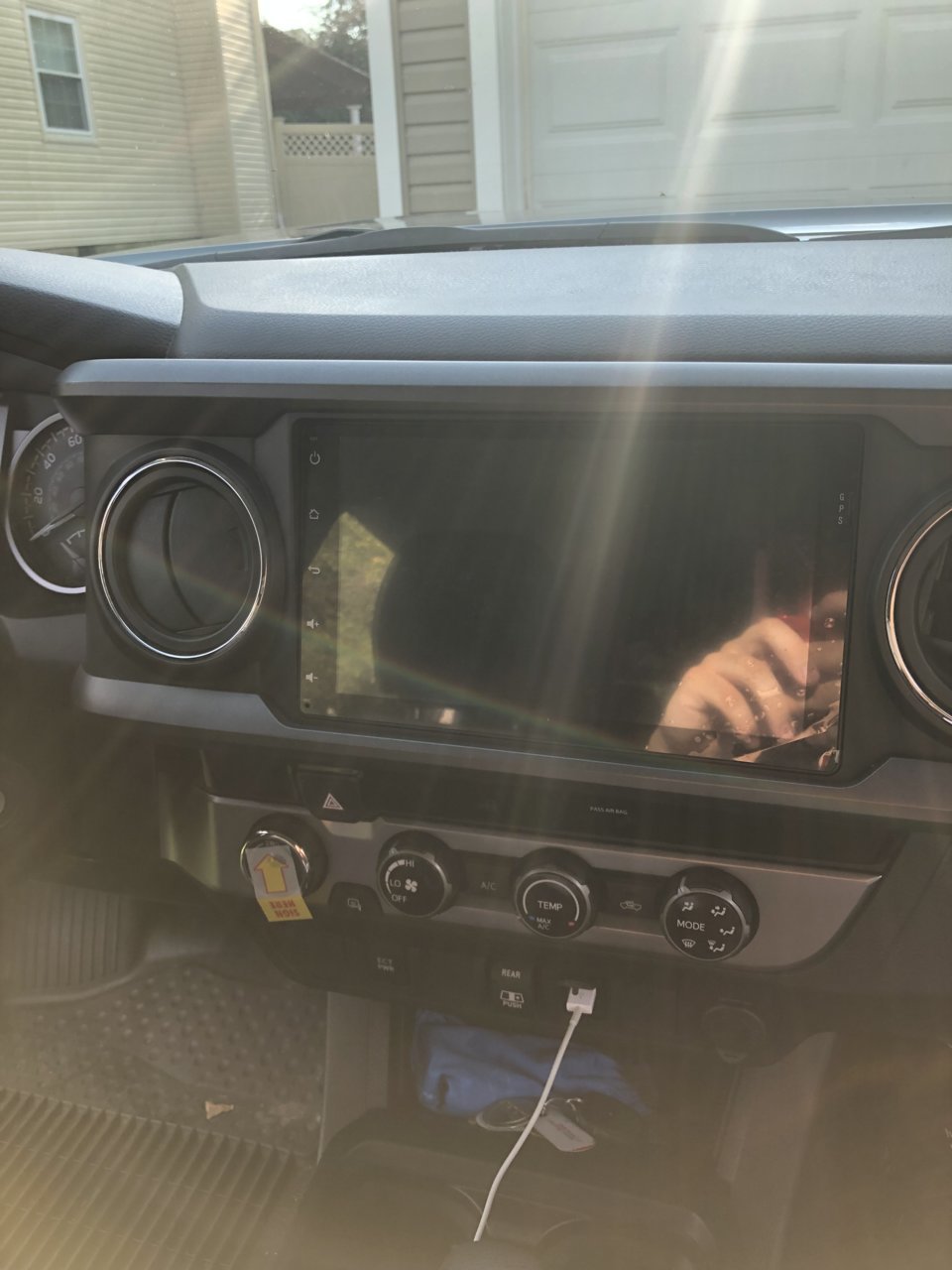

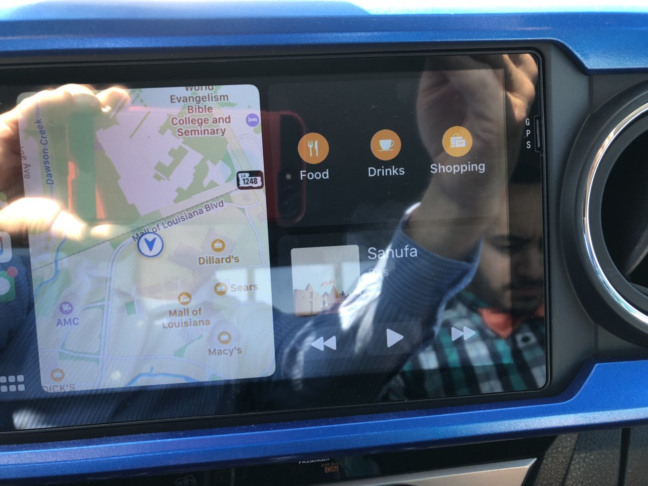

    This is like the radio install from hell, the car play dongle is in the line with the purple usb connector, still no car play, and the fit is off i can't get it to sit in the dash right

    Got a pic? You cut your bezel to fit it?

    FYI the CarLinkIt dongle from Amazon posted in this thread works with iOS 13, just verified on my buddies phone who is running the GM of the beta.

    Not yet it’s just hanging in there. Gotta cut the bracket to make it fit better Still no carplay going to finish it tonight after work. The radio seems to have a little more static now. Where did you attach your ground wire from the harness thinking that might be my problem.

    You definitely have to modify the bracket to get it so sit far enough back and get the angle correct

    I can’t get the damn Fitment right I’m about to throw this thing through a wall

    I put the screws just tight enough to hold the unit and then popped on the bezel which can also be tricky, with the screws loosened the unit can move a little to heal it seat with the bezel. Then once you have the bezel on and it looks good and we’ll seated you can tighten the screws down all the way. Not sure if this helps but try it and make small adjustments

    It seems like it’s not sitting high enough no matter what. I can’t get the bottom of the bezel snapped in

    Move the bracket down on the unit so it sits higher, look at my side shot photo of when I have the bracket lined up on the unit

    I put it in the same screws you did it just doesn’t seem right I took the brackets out and just put the radio in the hole with no brackets just to make sure it even fits. Gonna put the bracket in and see where the holes line up on it now

    Mines in, I didn't screw in the bracket bc no matter where I put it it just wouldn't seat right with the bezel. I'll adjust it more when I have time. Right now the bracket Is in there so the radio can't move side to side but it's not screwed to the radio, just to the dash

    Honestly @DoubleD.17BlazingBlue 's fitment picture saved my ass some heartache. Matched his pic with a few measurements of the Entune bracket.
