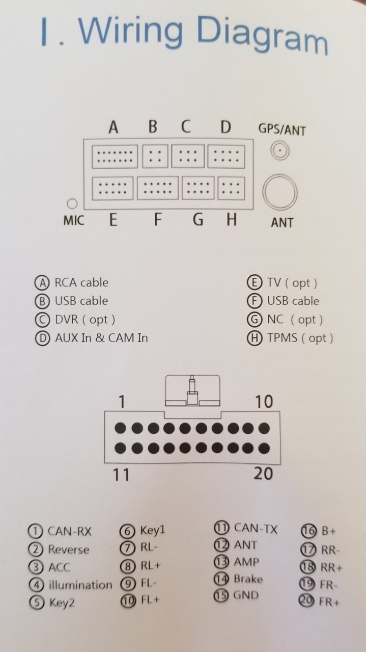

    Ok, so I’m trying to compile a list of parts (and decide which version of the headunit) I need to order to pull off what I want out of this radio uograde. So far all I’ve ordered is the canbus wiring adapter to allow the headunit to control my factory JBL amp. Other than that, I’ve got a pretty good idea of what I need to get a USB connector mounted in my dash for wired CarPlay usage.
    The biggest question marks now are going to be around the cameras and how I wire them to do what I want. I want to display my factory rear camera on the headunit and I’m going to add a front camera that I also want to display on the headunit. My factory rear camera displays in my mirror currently and the tiny 2” x 2” screen doesn’t do much for me. I’d be fine with having a dual display when backing up or even disconnecting the screen in the mirror. I know Car Solutions sells a kit for adding a front camera but I need to figure out where to tap into the factory wiring to get the rear camera display on the headunit and make sure I order any necessary wiring harnesses or connectors. Based on the limited research I’ve done so far I don’t think I’ll need to worry about powering either camera from the headunit (I should be able to tap into the factory harness) but I’m not sure which headunit is properly equipped to handle video feeds from two cameras and what wiring is needed to do it. Has anyone done anything like this using this type radio? Any and all help would be greatly appreciated.

    So here's a couple pictures of the owners manual. Hopefully this helps :thumbsup:
