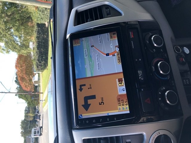

    How do I make the unit homescreen look like this? I ordered the Seicane unit and I like this a lot more than the default home screen.
    theolee likes this.

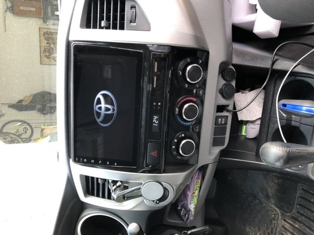

    42452869-70C6-43F7-9DE6-A841230B401D.jpg First post! I installed the dasaita unit on 12 good fit, but I bought the usb retention extension and can’t figure out where to plug it in. Any help would be appreciated.

    That extender should plug into the factory harness coming from the USB AUX and the other end into one of the USB ports from the radio.. Is yous a 2012?

    Correct! It should but I took the dashboard apart, traced the wire back to the radio harness and no plug looks like it can connect to it! I do have a 2012 with the base radio

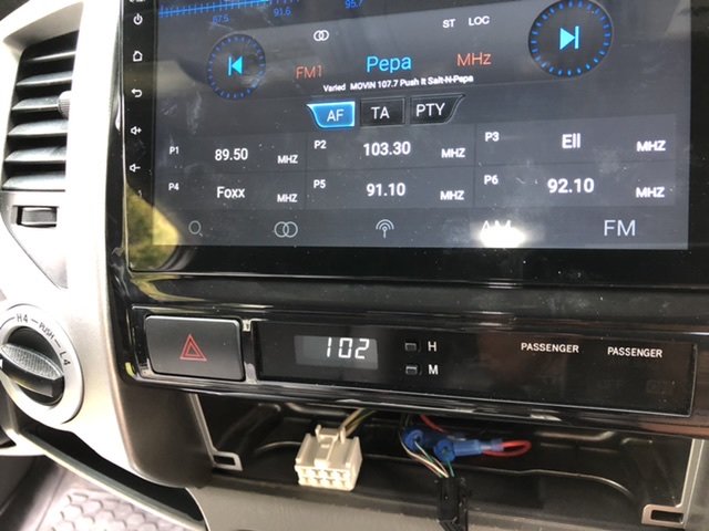

    Update!! I cut about 1/5 of an inch at the bottom lip of the unit to allow for the hazard/clock to click in. It fit snug and the gap actually looks better
    First pic is from before mod.

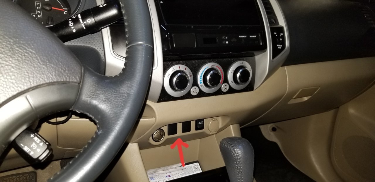

    Reposting if anyone is enquiring about new USB ports
    Silver05Tacoma likes this.

    Did you ever get them? Do they fit down by the cigarette lighter or are they only made for the slots on the left?
    theolee[QUOTED] likes this.

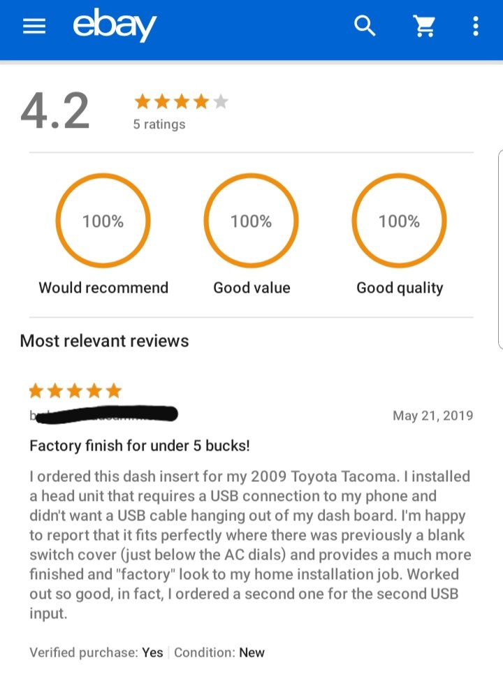

    I did, I wrote about it in the quoted post :thumbsup:

    Crap... I didn’t realize that was your own review. I don’t want to put them both on the left of my steering wheel (one might be ok). So I doubt I’ll end up using both of the ones I bought unless I can disassemble one of them and modify an existing blank from under the climate control to handle the little inner cable connector and trim piece. Is the female USB connector able to be removed from the switch blank without destroying it or the trim piece?

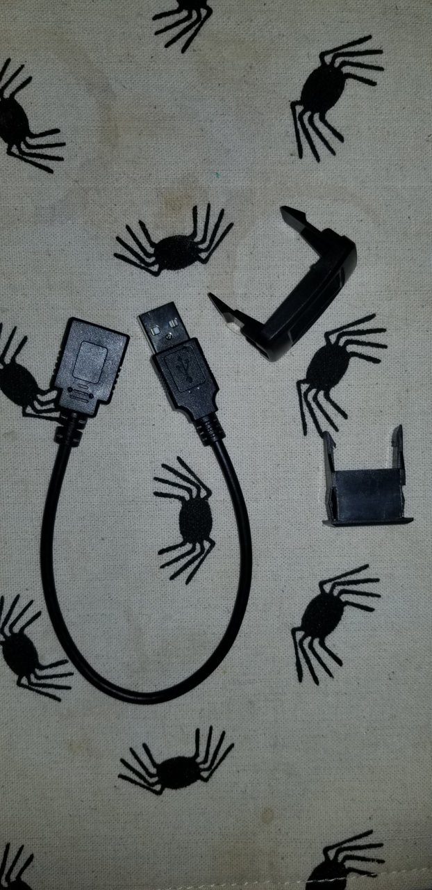

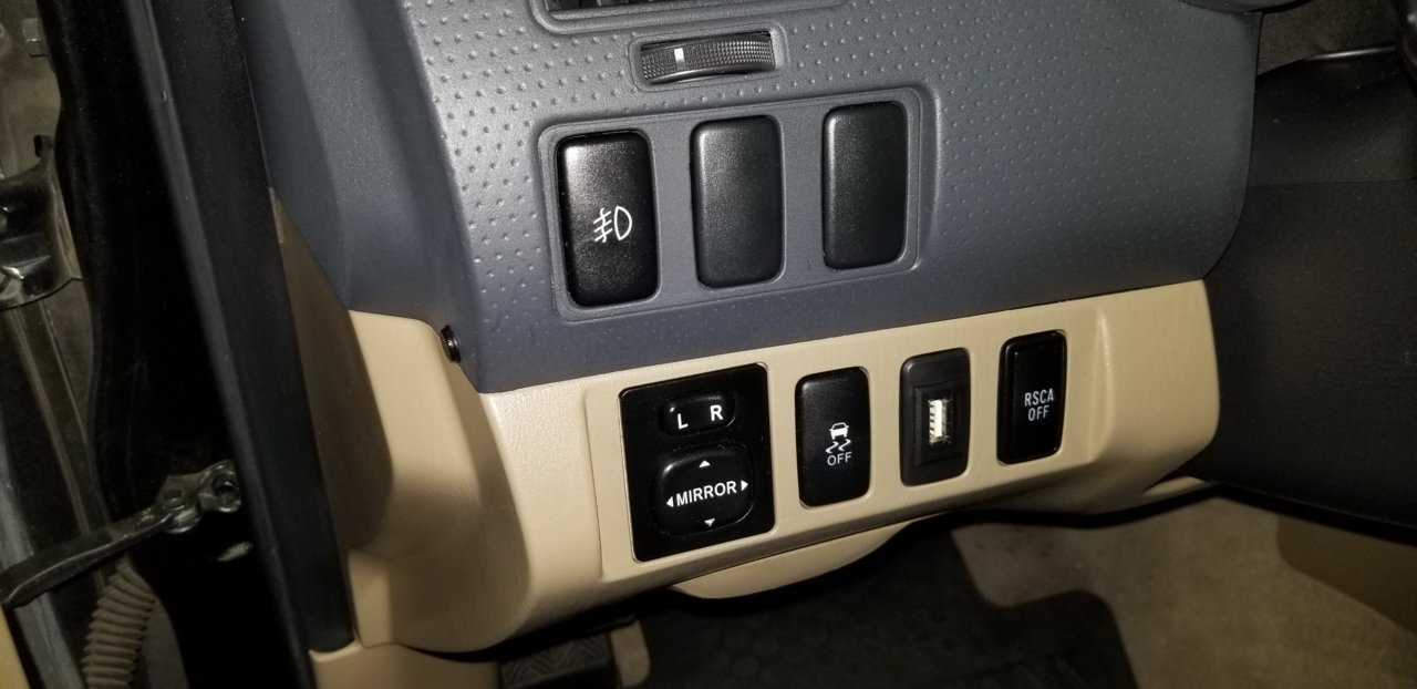

    #299
    theolee
    theolee www.nickleecreations.com / IG @nickleecreates
    Jul 15, 2014
    #134025
    7,085
    Theo
    SAN DIEGO
    Black 09 Tacoma SR5 Pre-Runner AC 4.0
    Ya I wish they would have been more descriptive on which solt they fit it in. Even the review made it seem very promising. I have free extras coming because it took for ever to arrive so I'll take a crack at cutting one down. To be honest, it's not off by much. A simple modification might do the trick. Just don't try and jam it in there like i did lol. Another thing to note is that wiring it to the left side was a freaking breeze. I hear the slots next to the 12volts are a bit out a headache to replace.
    Edit: yes the entire piece can be disassembled. I'll post some pictures
    Sorry about the stains and spiders :rofl:

  20. Oct 30, 2019 at 12:04 PM
    #300
    09TRDSport4x4
    09TRDSport4x4 OCD Approved!
    Oct 13, 2014
    #140292
    1,093
    Nick
    Southwest Ohio
    Perfect! Thanks for posting that. If the unit can be disassembled like that then I should be able to modify one of the blanks under the climate control to fit the cable and adapter trim. It’ll just take some patience and finesse. And haha, no hate for the spiders.
