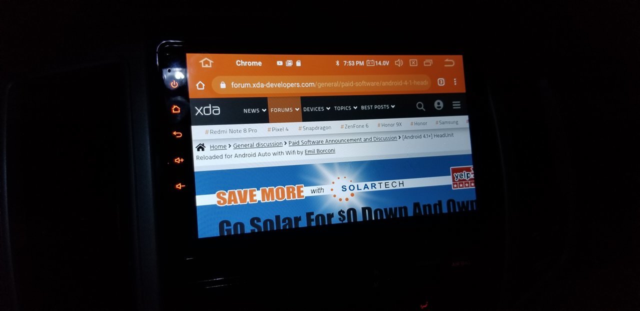

    Anyone else start their truck today to this window magically starting up to the file update website? Weird...

    Never had that happen. Though it'll usually start at whatever I was on last

    Ya that's the thing, I haven't used the browser for xda website haha

    Strange, I am due to update mine though

    I think it might have been headunit reloaded. Maybe I hit something? I'll have to look into it.
