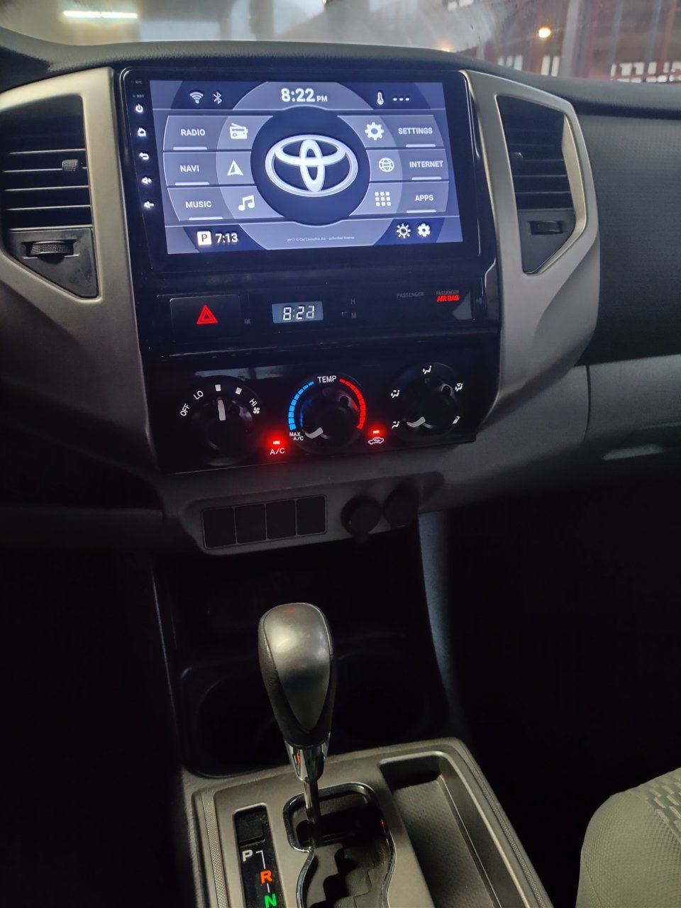

    I got everything connected and working. Sounds way better than expected. Works with my Alpine 5 channel amp and the DSP is definitely the way to go. Steering wheel controls work with the harness thats provided and you can program all the buttons to do basically anything.
    I downloaded headunita reloaded and everything seems to be working well there as well. Already dark here so I'll have to wait until tomorrow to get better photos and play with the settings a bit more. There are very small gaps on either side (maybe .5mm) I plan on putting a layer of tessa tape on the outside edges to snug it up and close the gaps. I have done this with previous aftermarket dash kits and it works well and is easy to hide.

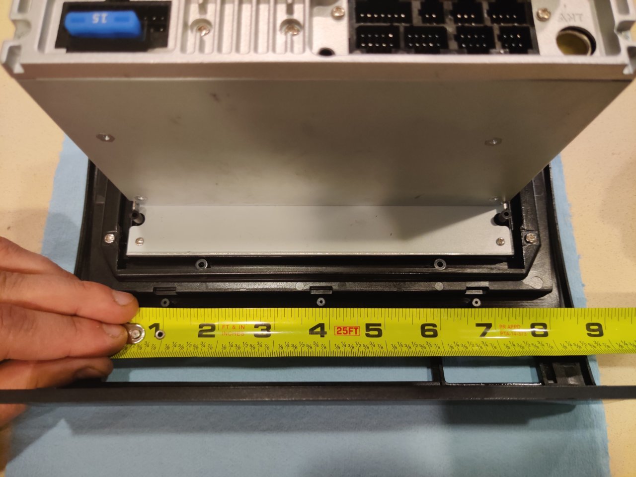

    So I was able to get the factory brackets to fit after drilling some new holes in them and I have the radio mounted up nice and solid. It did take some time fiddling with hole position to get it just right. I ended up just making slots and leaving the mounting screws loose until I got it in position. I did have to use extremely short screws though as one screw was hitting the electronics on the inside and causing a short.

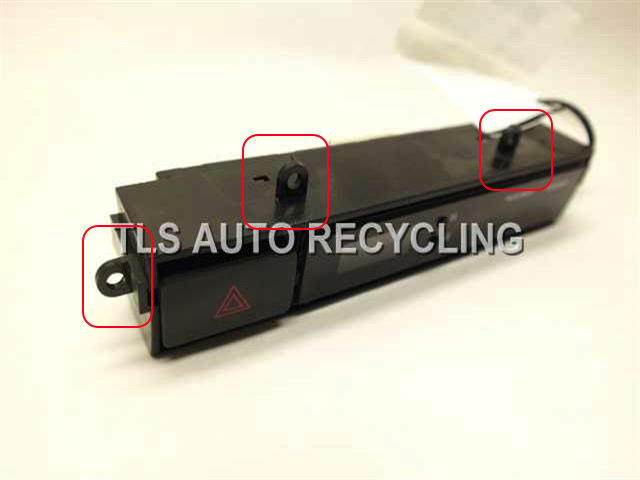

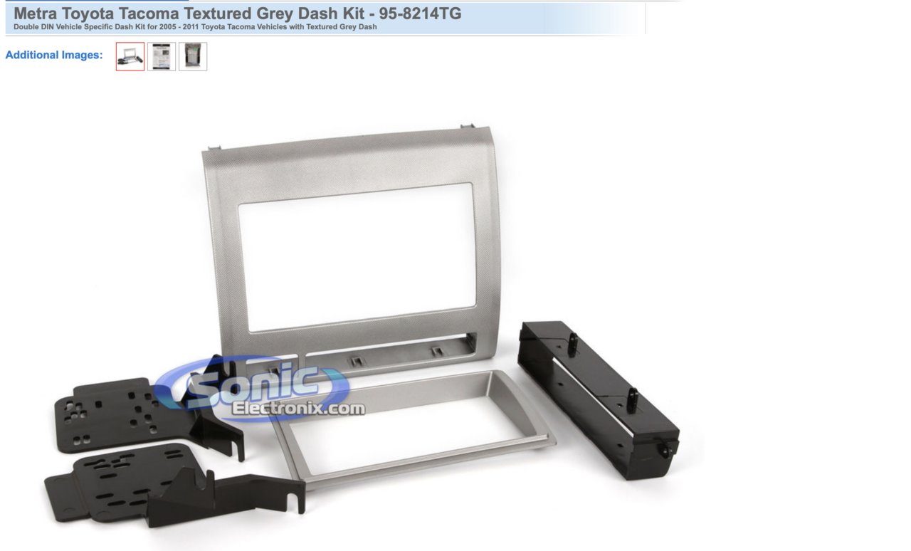

    It looks like you need the hazard switch with the clock.

    I just seen yours has the clock also. That picture of the clock I posted is from a 2011 tacoma.

    this might help

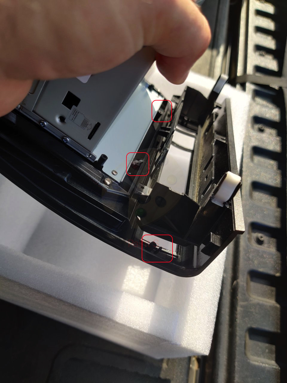

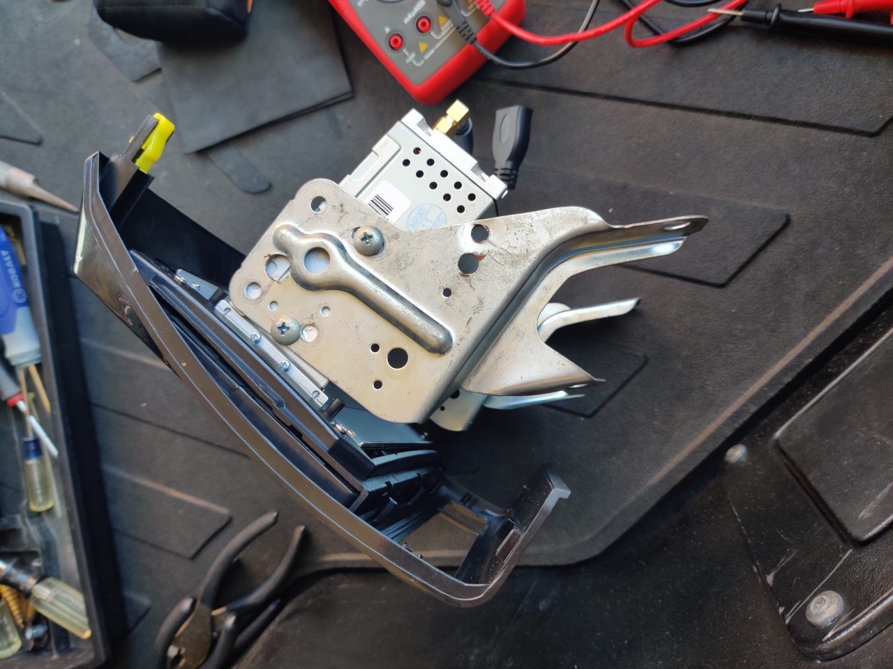

    So I should have posted a better picture of the mounting location on the back. It actually has three screw posts on the top and one on either side. That's why it's confusing.
    The posts in the photo @arcenik posted above are actually used for the screen. The posts that I assume are intended for the hazard / clock bar are underneath that bracket I set in then. I'll try to get a better picture in the next day or two.

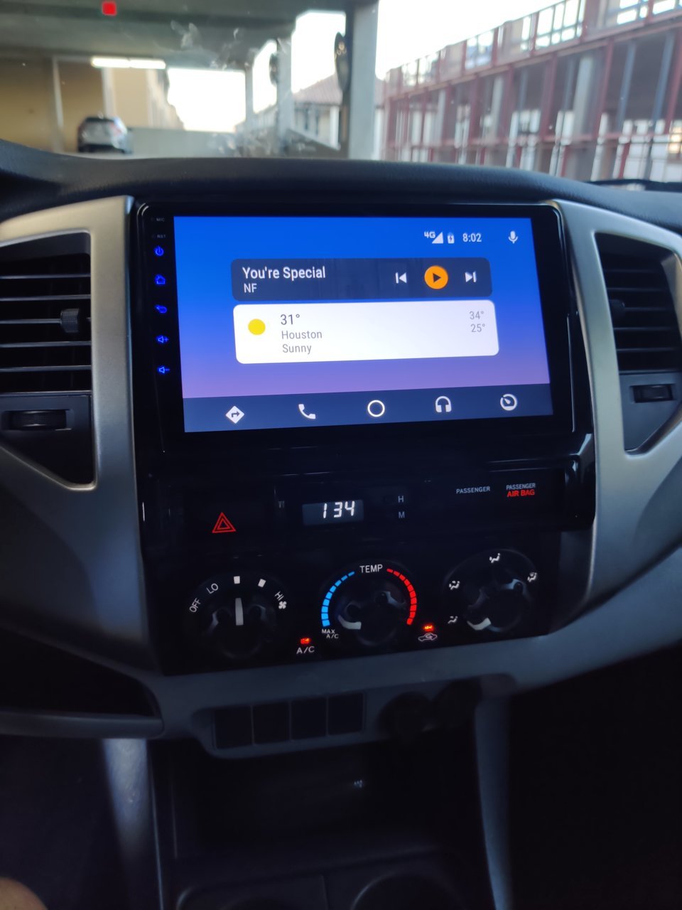

    I have been using the stereo and haven't had any issues so far. Been running Android auto with headunit reloaded and it works great. Sounds great and the steering wheel controls work as well. Just need to get this D*@n clock mounted. I'm getting close to breaking out the epoxy

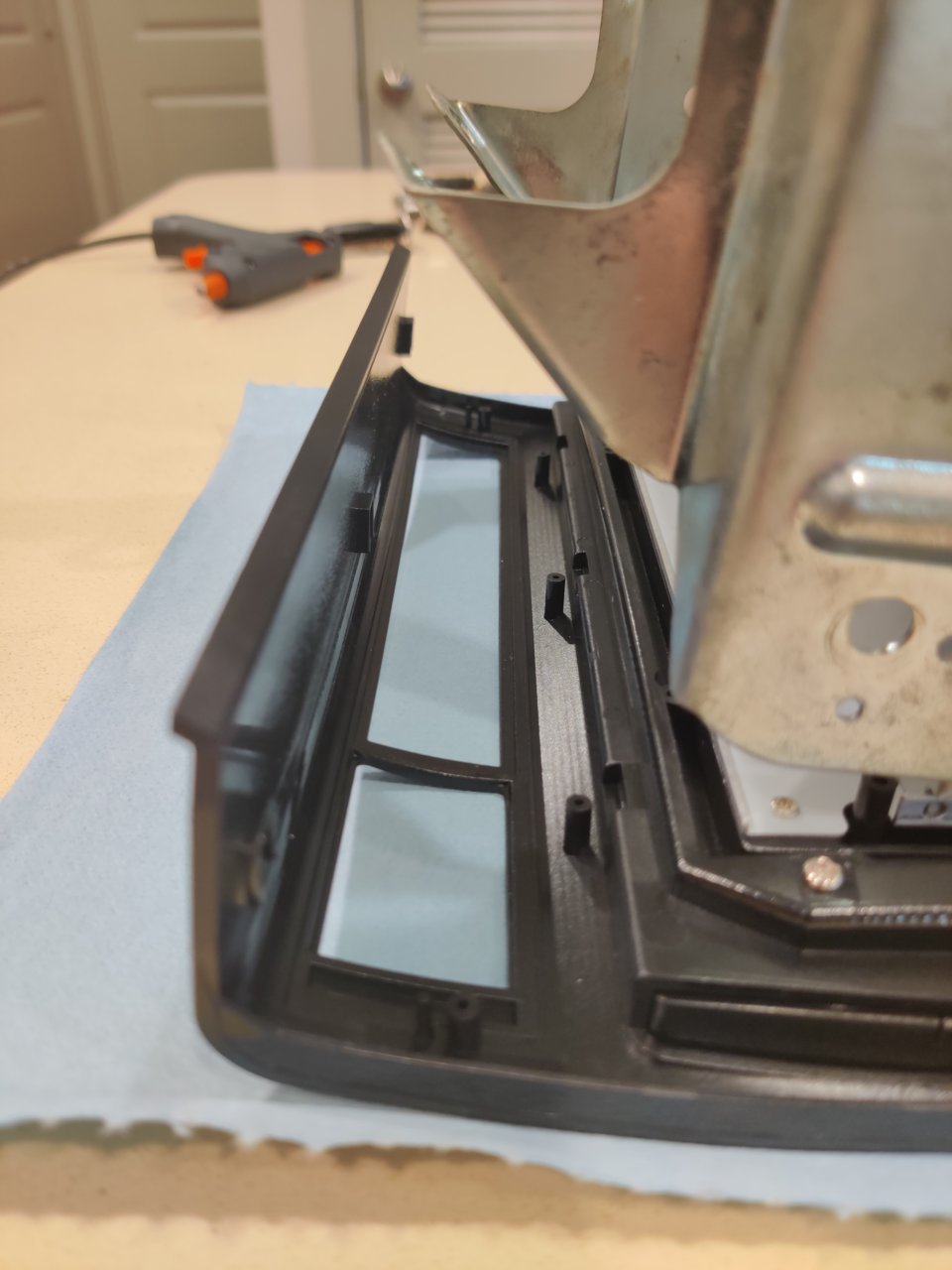

    So I got the clock / hazard glued in with hot glue until I figure out a permanent bracket solution.
    I also got some better pictures of the back of the unit where the clock should be mounted. They just don't like up with the original bracket and the other 2nd Gen version doesn't look like it fits either.

    Here's one side. I just measured 7 or 8 times then drilled new holes. I had to slot the rear one because I didn't get it just right. I have other holes left over from a previous install as well.
    I'm not sure which unit you bought but on mine there was what looked like an electronic noise suppressor that was close to the frame and the passenger side rear bolt was touching it and kept popping the fuse. I cut about 1mm of the screw I was using and that fixed it.
