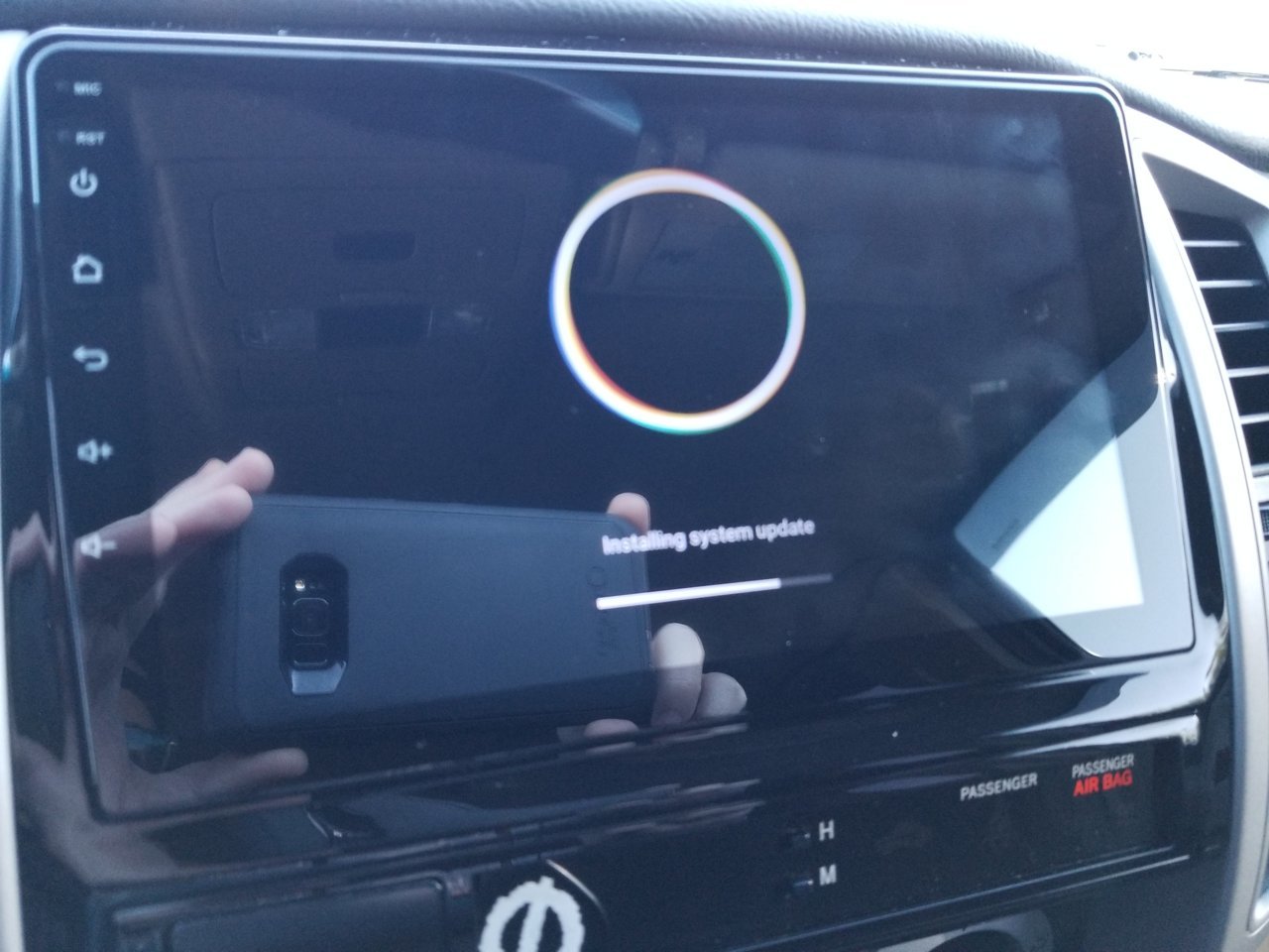

    I tried mine this morning with this IMG and same thing, it launches the music player first, I close that and go to MCU update and then it tells me not find MCU..

    Alright I figured it out, all updated. "Formatting" the usb drive was the issue. Make sure you do that each time. The update.zip file is the file you move over after you extract the downloaded update file. I was doing it through my phone and kept forgetting to follow all of those steps lol. :thumbsup:
    You don't have to go to settings. A menu will pop up prompting an update.

    Theo, was that the MCU / .IMG file or the Update.zip? Trying to do the .IMG file I get the IMG file not found. I've formatted the USB and tried a different USB.. The update.zip file loads with no problem for me..

    Ya I only got the .IMG file to update once, then afterwards it kept saying "not mcu file found". When you unzip the download and open the folder you'll see that first "update.zip". That's the one you move over.

    OK, I've got another error that is popping up a couple of minutes after start up..
    Doesn't seem to affect operation.. I'm going to email Iris, give her the errors from the IMG and this error and see how their Tech support really is.. :)

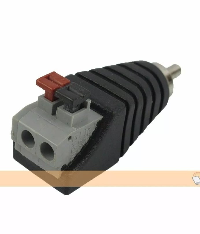

    I have a 10'' sub and a 250w amp laying around collecting dust and I'm thinking about hooking it up. I'm debating deleting the passenger seat behind me in my access cab. I had it placed there in my 1st Gen before and liked it. (don't allow anyone to sit there anyway lol)
    I was wondering if anyone has connected a sub to the HU? I know it has a built-in amp. Do I need my external amp or can I wire the sub up directly to the HU?
    I was thinking of purchasing one of these adapters since the sub uses speaker wire and connecting it to the green sub rca cable.
