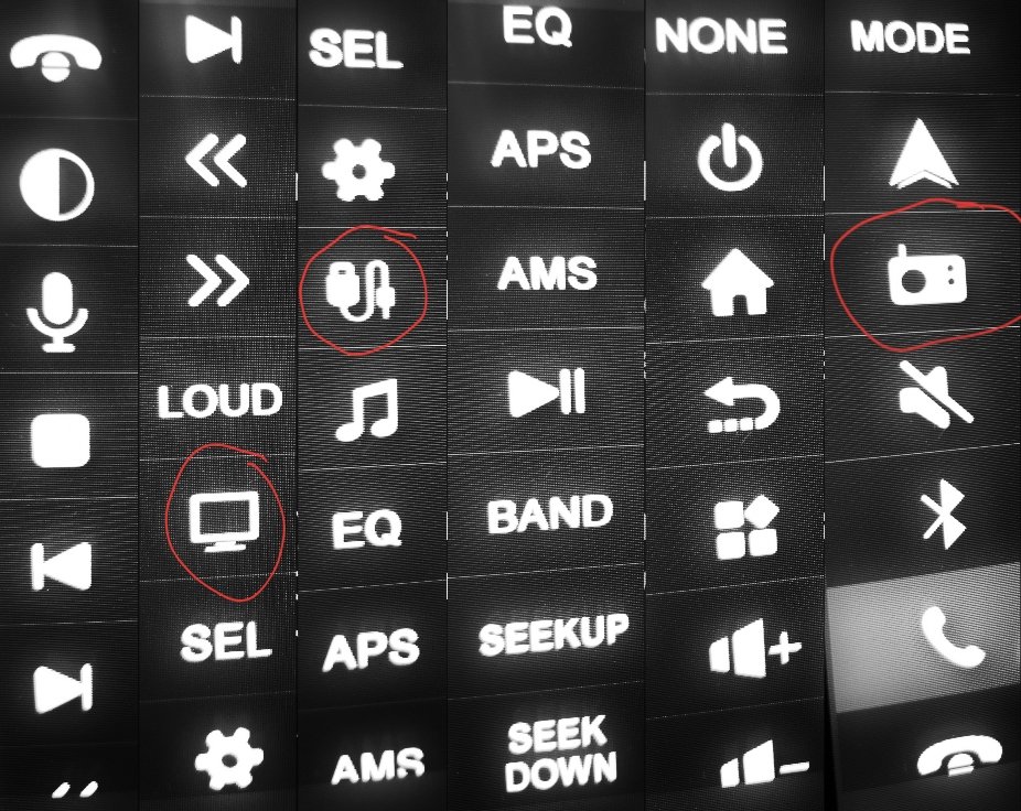

    Hmmmm... you think that camera icon three above the phone icon the aux camera???

    Maybe! AV app also? One of these three I circled has to be the dash cam. (Probably stupid question here but) Did you look through your manual yet? The dasaita manuals are not very descriptive.

    This is the fcam button

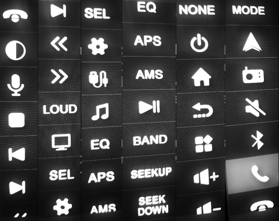

    I think it's the same, maybe the icon changed with the update?

    That’s the radio button

    Are you using the canbus? The buttons change for some reason when using the canbus vs not

    Yes, I’ll be using can bus

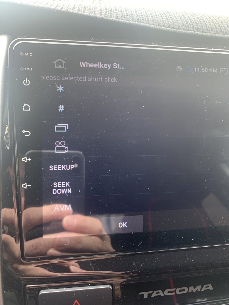

    Has anyone ran into the issue with a Seicane HU that evening though everyone claims the steer wheel controls are plug and play, I cannot get my volume and skip buttons to work with the HU? Only the “Mode” button¿

    Did you change the vehicle settings to rav4?

    I don’t think so..? But then again I don’t remember coming across an option to change it to rav4 to begin with, am I overlooking something?
