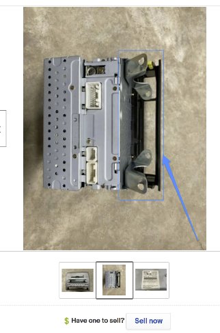

    Close to pulling the trigger. Anyone have an updated link of where they purchased theirs?
    edit: for a 2014 base non JBL. I’m assuming they haven’t fixed the bezel for the 2.5 gens as well for the hazards and clock

    No they have not. I picked up an old 05 radio on ebay and ripped out the lower part and that worked on the setup.
    Check Aliexpress or ebay. Those are the best places. Same seller, they do sales from time to time.

    Could you clarify what part of the radio you need to get the dash kit to fit?

    This part. It is different on the older ones. Its a black frame that holds the hazard/clock

    ah, so it's actually apart of the older radios and not part of the older bezel? interesting. is everyone's hazard clock still holding up after gluing it on?

    the older radio bezel and radio are one piece so they are one ad the same.
