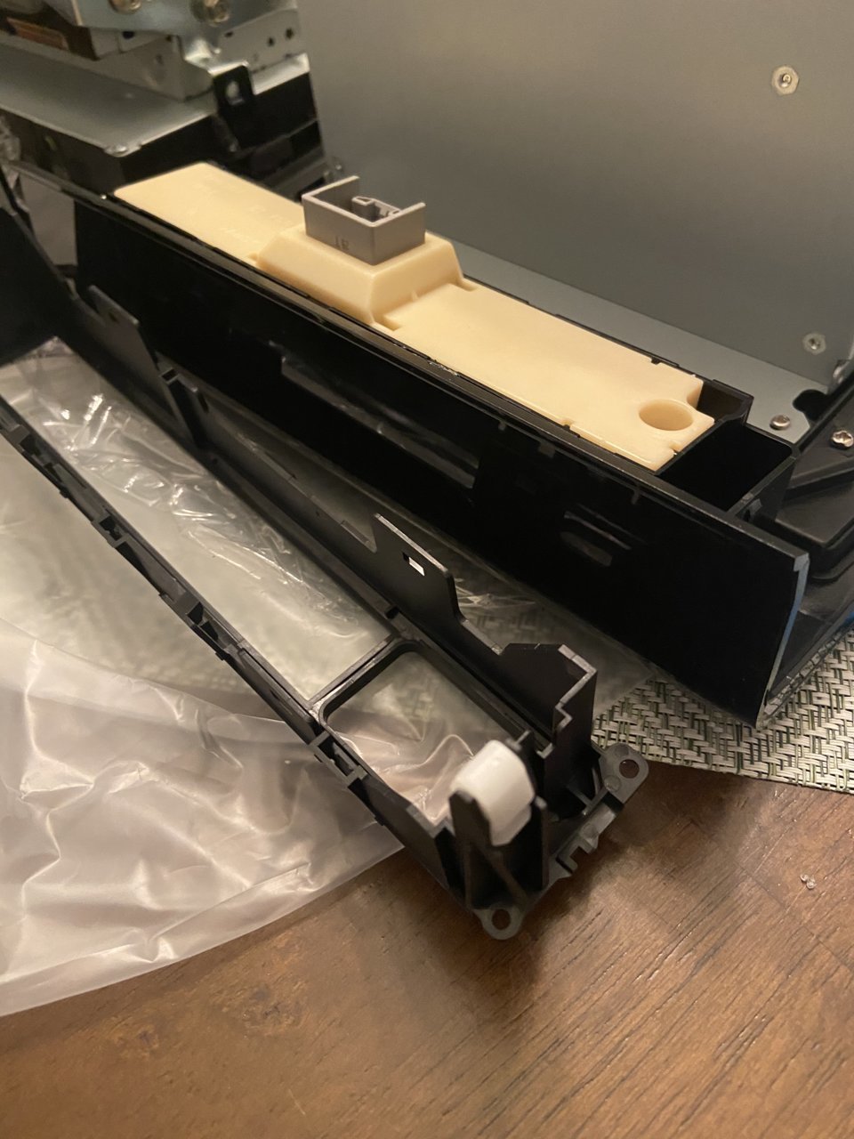

    Mounting the stock mount brackets onto the dasaita...any tricks??? Can’t seem to find a way to line up, Mark, and drill holes to make sure it’s flush with the dash.

    Currently here. Also, there’s dimples that line up to the stock radio holes. What’d everyone do?
    EDIT
    ah, I see most people didn’t use the brackets. Must have read right past that page. Thanks!!

    @kamakazie_1 I will not have the bottom bracket clips from the hazard switch bracket. Is yours still secure enough with just the top three clips? Feel like I should probably put something down there to secure the bottom...thoughts?

    Suggest you get creative. Find a way to mark the holes that need be drilled. Others have done it, so it can be done. Other thoughts may be to head down to a hardware store and find a metal bracket you could use in place of the OEM one. I'm wanting to do this. My 09 has the bottom clips and that's all I have securing it. I was doing some wheeling a few months back and the whole damn unit almost popped out lol.
    So with that said, I am planning on tackling this very thing Monday, if I figure this out I'll walk you through it if you hadn't already :thumbsup:

    Hey Rob, why are your bottom clips not holding? I had to make a notch in the bottom of the head unit panel to allow the clips to click in, but yes, even with my rough arse dirt road to the house it has held good without the bracket..

    Because with the actual hazard bracket on it doesn’t sit flush to the bezel.

    got it. ended up drilling holes after multiple measurements on the OEM brackets. good to go! nice and sturdy.
