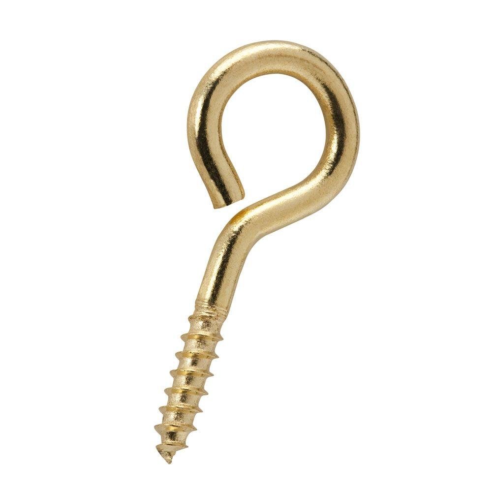

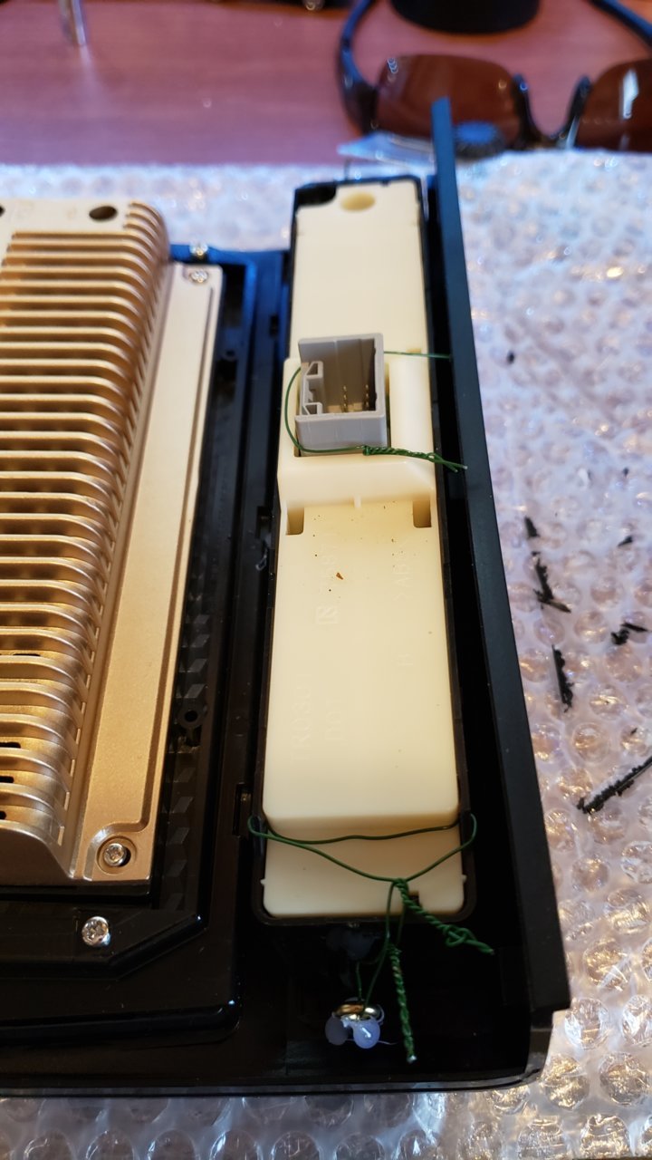

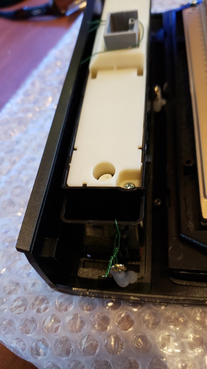

    My OEM mount for the hazard lights button and clock didn't fit either. So using eye hooks for hanging pictures, I screwed those into the stud holes and used 24g wire to secure it in place. The stud holes are small and I doubt the OEM screws would have fit without cracking it. I also used a glue gun around the stud holes to hopefully make them a little stronger. I used a small drill bit to drill the holes needed for the wire, including 2 holes in the bottom of the dash face of the stereo.

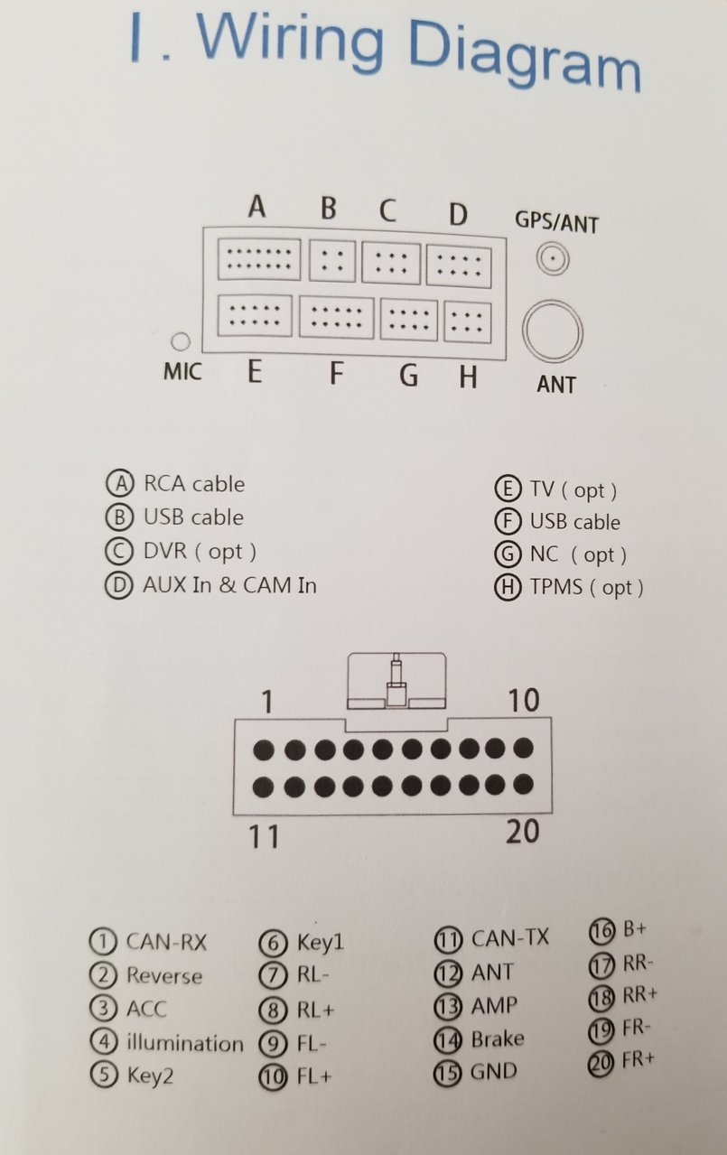

    Handbook? This is the wire coming from the HU. No instructions with it. I think now it's for a Back button for screen navigation.

    Yes the "hand book" (instruction manual). Ill take a look at mine for you
    Edit: is it coming out of the main harness? If so see placement in attached photo.

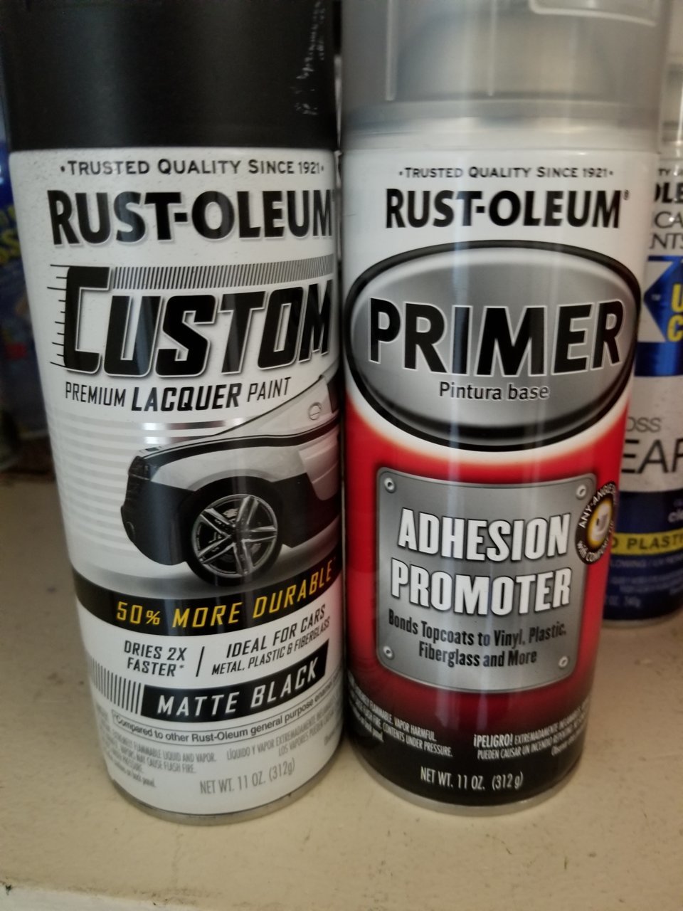

    I ended up not matching the silver and went the other direction. I painted everything black :rofl:20200625_202845.jpg

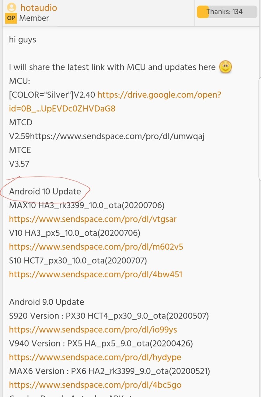

    I see the Android 10 update popped up. Anyone update yet?

    I didn't mean to sound rude earlier, this is my third Android HU and I've never had a manual come with it. In any case, the BACK wire is indeed the reverse activation wire. Many thanks for checking...my nerves are shot today lol

    I might do this. How hard was it to paint everything black to match? Krylon spray?

    Not hard, took my time. It was all part of a chrome delete. I plastidip'd the low traffic area and used Rust-Oleum for the rest. It just comes down to knowing how to take everything apart and a bit of skill with a rattle can.
    If you end up doing it, feel free to hit me up if you need any help. I do recommend plasti-diping things first to see if you like it or not. Then later on laying down permanent paint :thumbsup:
