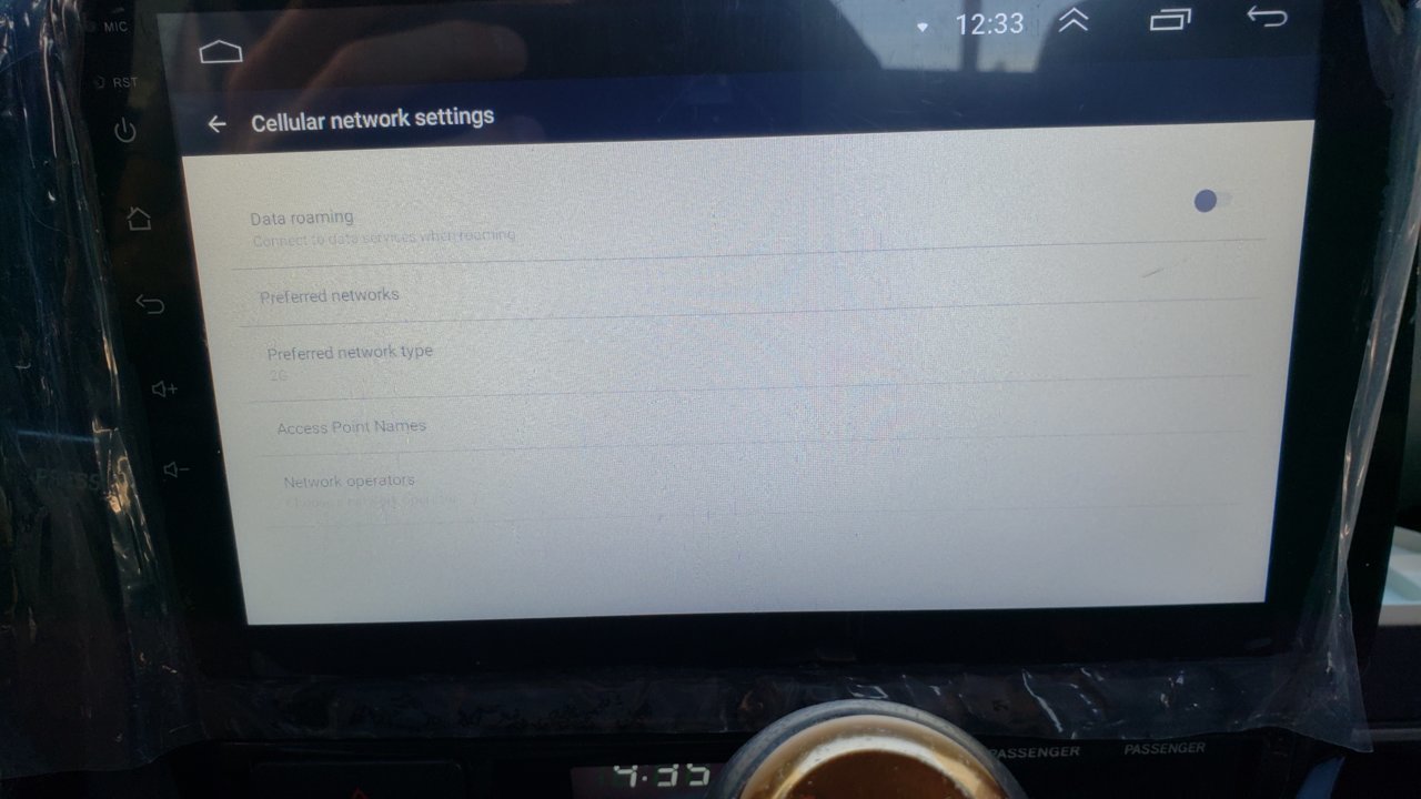

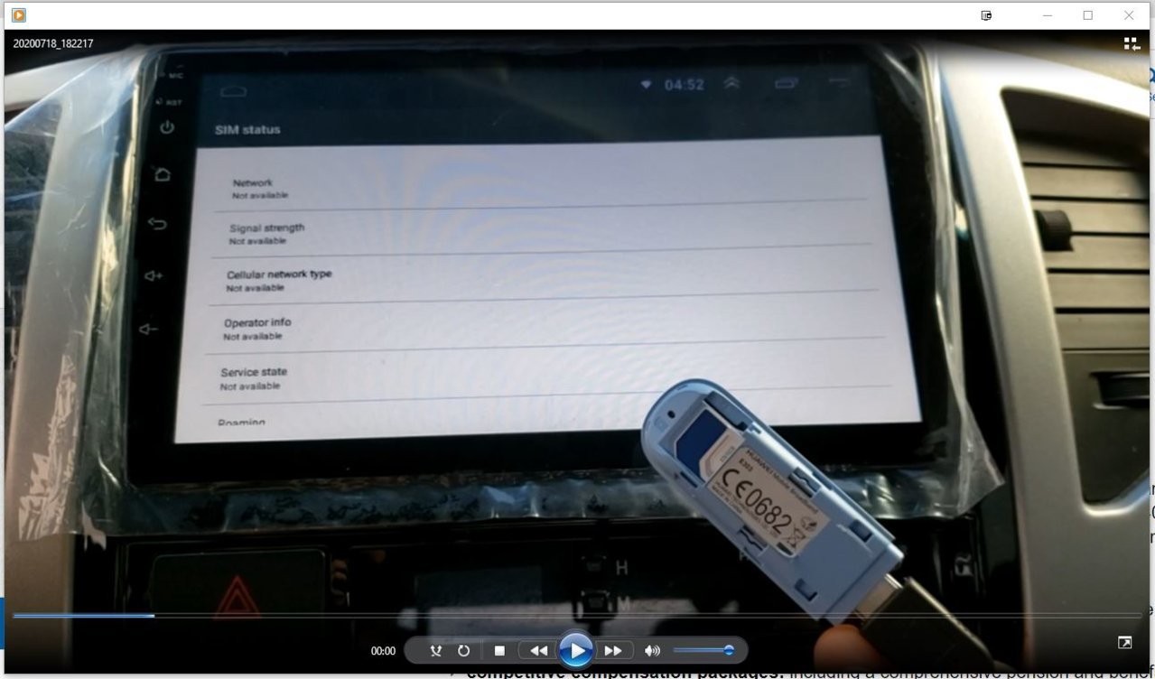

    This HU is my third android HU. I've had 2 previous ones by Pumpkin. I have a Huawei E303 3G USB dongle that worked in both but not in this HU. The Preferred Network Type says the preferred cellular network is 2G but these units should be compatible with 3G/4G. It says so in the HU description. Anyone else using a 3G/4G dongle with these HUs? I was only able to get into cellular settings through a third party shortcut app.
