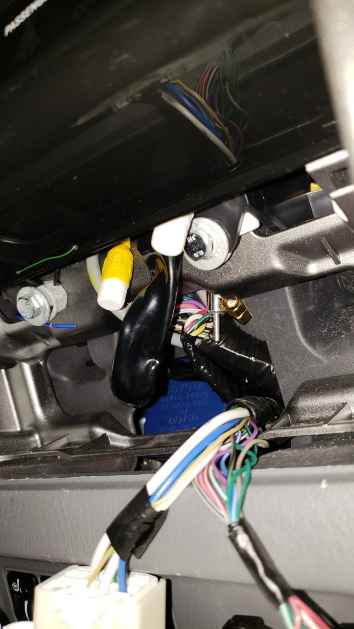

    Planning on fitting the head unit tomorrow morning. Pulled the old head unit out, checked all of the contents of the Dasaita and already ran into a few issues.
    Already stripped one screw :anonymous:
    Most of the wires were pretty neatly prepped, but I found an exposed (orange/black) wire...
    Turns out it was a bad crimp job on the CANBUS harness, and the wire snapped out of the Molex terminal :argue:

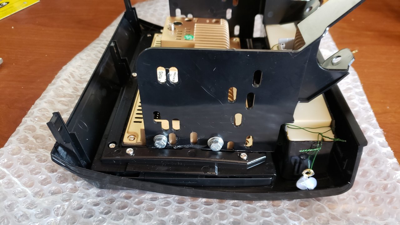

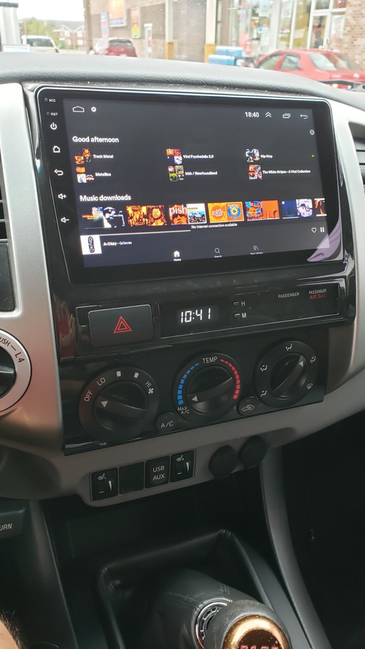

    I've had my A10 unit running now for a week. I've had 2 Pumpkin brand Android HUs prior this one so I can make some comparisons.
    First, the HU looks great in the dash. However, it was not an easy install to get it in the dash. First, the bracket for the emerg flashers didn't fit and even if it did, the stock screws would have broken apart the plastic studs on the HU as they were small on the round making the screw holes were too small. I used eye hooks and wire to secure the bracket in place. Second, the stock clips did not fit well on the top clip holders. They were too small. I only used 2 on the corners which snapped well but the HU eventually popped out at the top. I also had to modify brackets....the ones you see there I had to discard and use a different pair. The bolt holes in the plastic were too far out. The second pair I used jad th bolt holes closer but still needed to insert a make-shift spacer with longer bolts to secure the bottom. All that said, most of the wiring was plug and play.

    First, it's not as loud as previous Android HUs. 45W per channel is not quite enough for stock speakers. My previous HUs were 50w. I ended up ordering an amp and it's on the way. Related to that, I found the equalizer limited. It's hard to get it to sound good. Hoping the amp helps.

    I tried to re-crimp the wire for the CANBUS harness and I guess I failed. Unit powers on but I have no sound. Looks like I'll have to wait for a replacement harness from Iris :annoyed:

    Why not get some splice connectors or t-taps and connect the wire directly. My HU has a wire diagram under Settings. Can't remember the speaker wire colours but shouldn't be hard to figure out.

    I guess I could but Iris has already agreed to send a replacement. I also ordered a few male Molex terminals from Amazon and I'll try and see if I can re-crimp the wires myself

    From a previous dash kit I had kicking around. Had to drill new holes in it to get it to fit. Because of the low profile of the amp, the bracket did not fit all the way into the dash, which is why I had to make spacers and use longer screws.

    How did you line up/measure where to drill the holes?

    Used one hole already in it. Measured the distance to the other hole on the HU, then marked it on the bracket. If I was off slightly, just used the drill and the side of the drill bit to elongate it. If the hole is a little big, just use a washer (I also added lock washers).

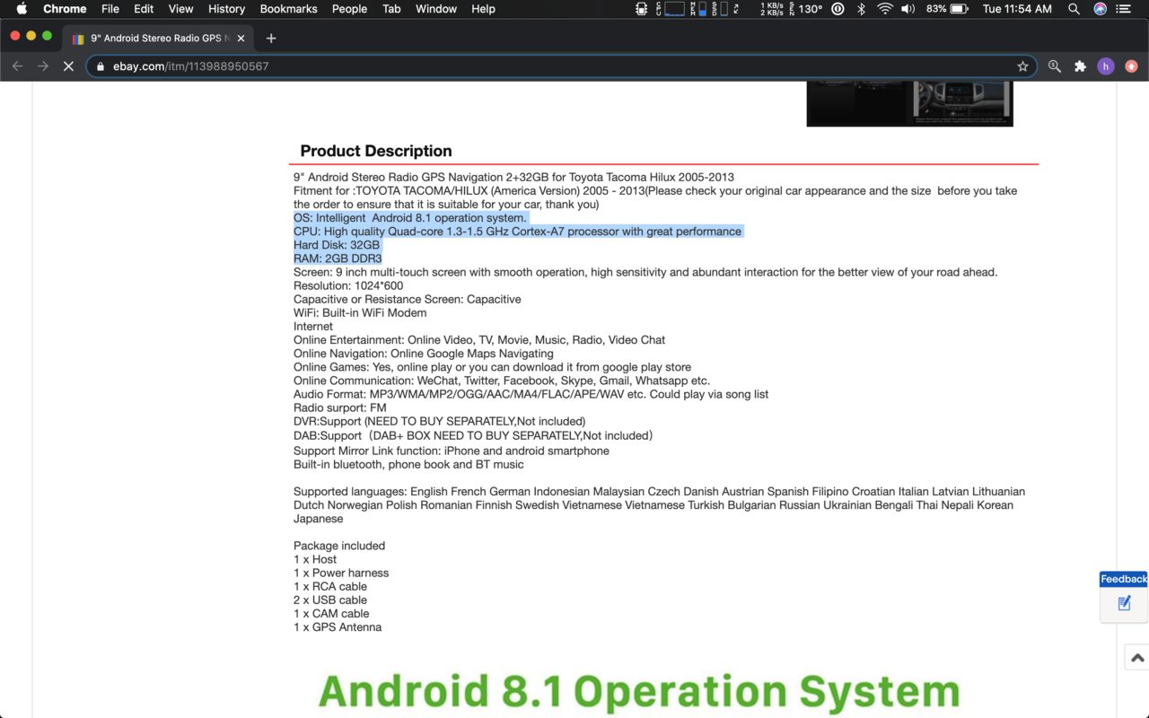

    since there are so many different branded and unbranded units like these that are identical.. whats the difference between the dasaita unit and lets say this one on ebay that looks 100% identical besides the price?
    https://www.ebay.com/itm/113988950567
  19. Aug 4, 2020 at 2:56 PM

    The highlighted areas are a big difference for sure

    but is it really worth a extra 300$ what is one gonna do that the other isnt? i mean if ur just using it for music and nav.. i cant see disc space being a issue unless your trying to store music or videos or tons of apps that never get used lol
