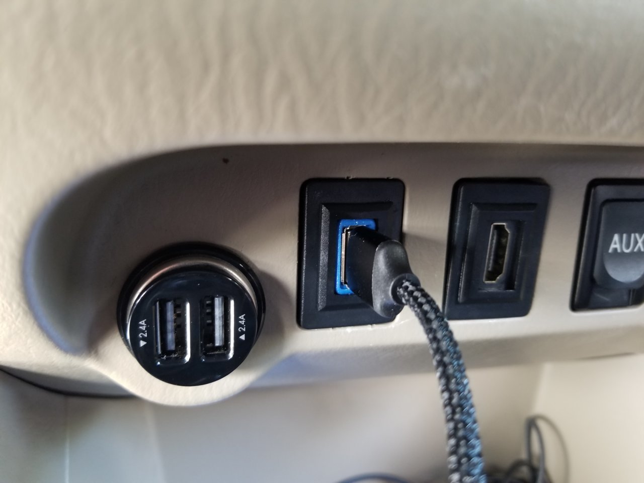

    I don't think our trucks come with stock GPS wiring. I'm sure you could always replace the satellite radio antenna on the roof with a GPS one. And yes the dasaita HU does come with a gps antenna. Does it work with other apps? I don't know..
    I ordered the extra memory too and never really saw where the mini SD card is hiding lol. I'm guessing it's under the dash kit. There might be a slot for a sim card there too. Maybe one of the other guys that took it apart to paint it could chime in.
    There are three USB cables. You need to use one of them whenever a update comes up for your HU. These cables also help with Android auto (with headunit reloaded), hard transfer data, files and music etc. The reason why I chose to match them up with a blank port is because I didn't have a USB/AUX port. Just an AUX. So basically convenience was my reason.
    For those who have the USB/AUX combo port need this adapter I believe.
    https://www.amazon.com/dp/B07BCCK5N3/ref=cm_sw_r_cp_apa_i_DoJlFbFFC41AJ

    The SD Card slot is on the left side of the HU. Mine came with a small SD Card already installed.
    I got the USB extension for the center console, but I also got another two USB ports that replaces the cigarette lighter port. The only crap part is, it looks like I have to pull off 10 different trim pieces to get to it. I can fish the wires behind all the trim pieces but I can't secure the lock ring for the cigarette lighter USB port module without getting a hand behind the trim piece.

    Lol ya. Accessing those ports can be a freaking night mare. But I was able to pull the headunit and HVAC out and reach my fingers in there like this guy did in this thread:
    Beats taking everything apart. :burp:
