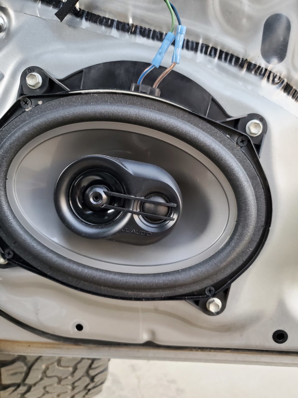

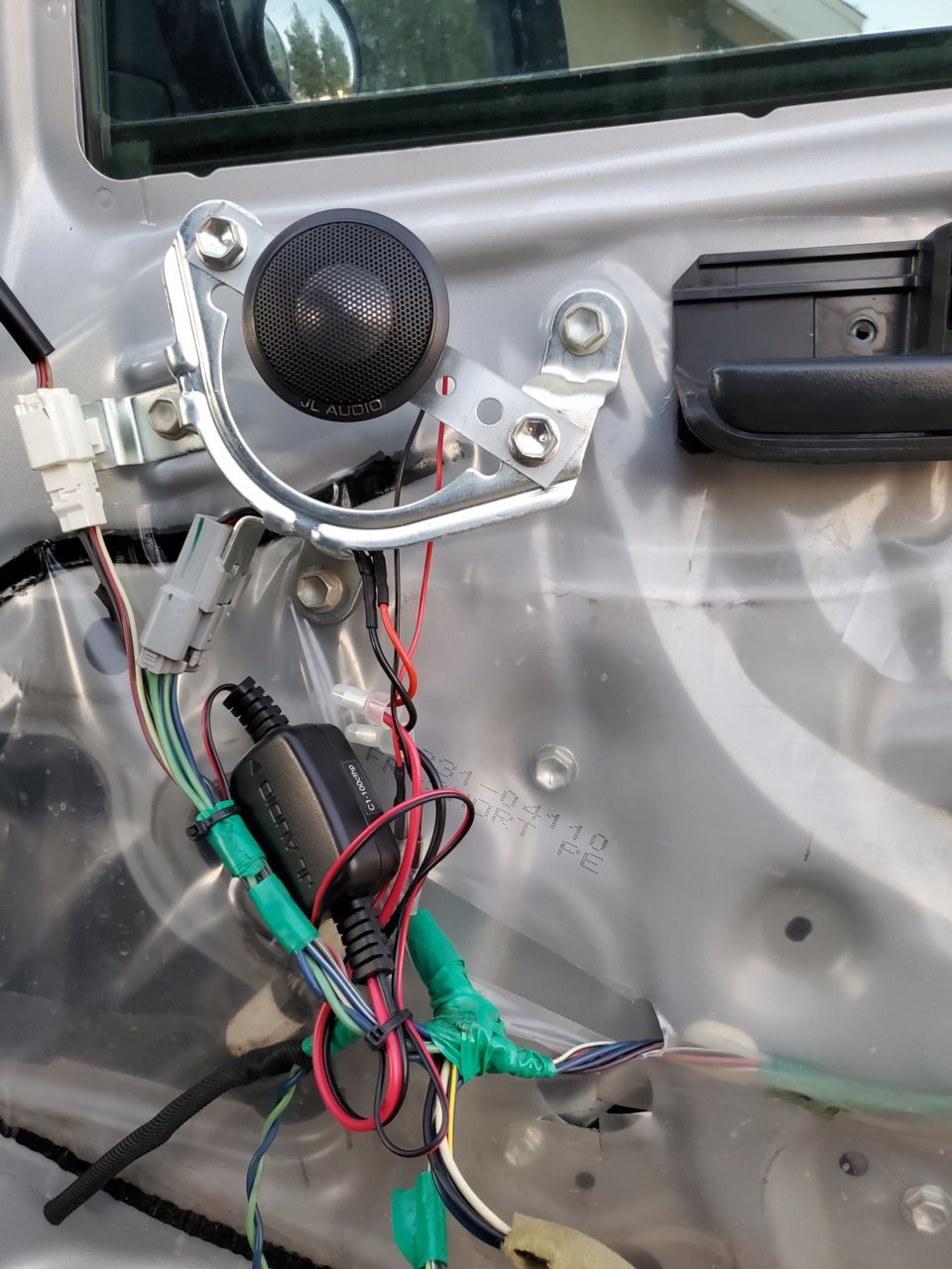

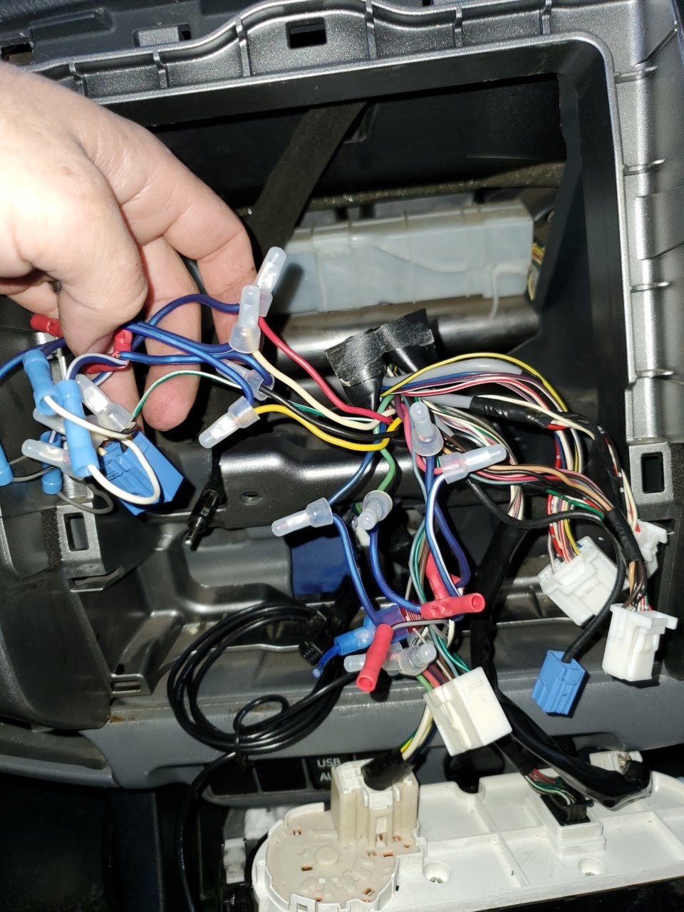

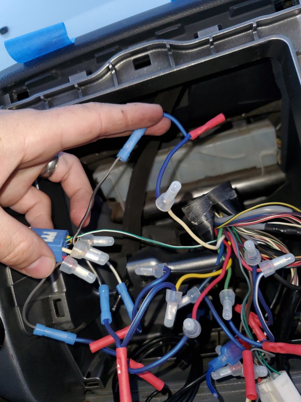

    well the cluster f*ck of wiring this dude put behind the head unit came back and bit me in the ass.. when said it was workin before it was.. but only the fronts.. plug the rears in and it cuts out.. so i was thinking something in the rear speaker wiring was messed up.. took the door panels off and everything looked fine.. so it has to be something in the birds nest he has going on.. so i ordered a new radio harness for the truck.. going to cut all the crap out and put new plugs in.. and HOPEFULLY that will be the ticket lol.. i cant think of anything else it could be... u can see in one of the pix he has 1 wire spliced like 4 times with different gauge wires to.. new harness should be here in a few days so ill check back.20200810_194616.jpg 20200810_194501.jpg 20200810_185556.jpg 20200810_193941.jpg 20200810_193944.jpg Installation-Harness-HA-711761-39-detailed-image-2.jpg
  12. Aug 10, 2020 at 8:25 PM
    #652
    Naszero
    Naszero Well-Known Member
    Oct 21, 2019
    #308621
    228
    2021 Cement DCSB TRD OR 4x4
    Yeah, there is no way he did "nothing" with that rats nest...
