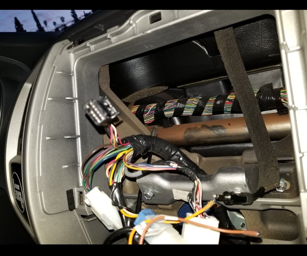

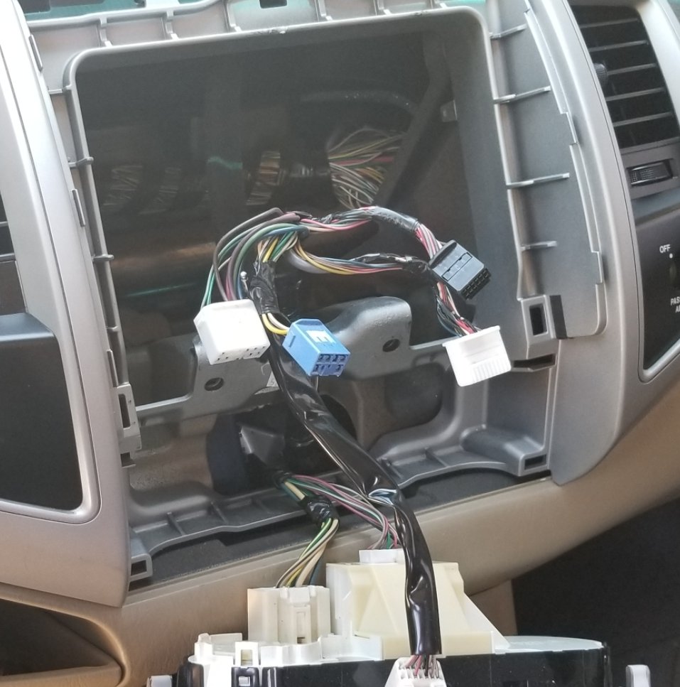

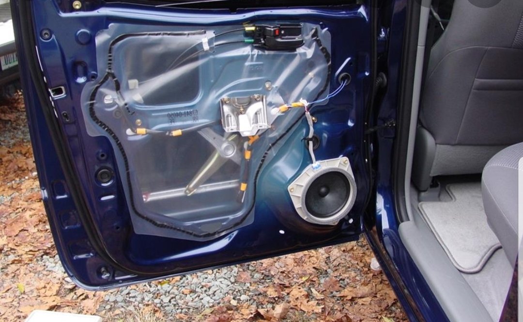

    @Hippiglass most of those wires you have there need to go. This is what your OEM wire harnesses kinda looked like before your friend (with all due respect) edward scissorhands got in there and tried to wire up Frankenstein lol take a look at the OEM wiring versus yours. :)
    Screenshot_20200815-215742_Gallery.jpg Screenshot_20200815-215717_Gallery.jpg
    Like @DG92071 said and suggested, the last guy had everything wired up to a amplifier(s). You'll have to clean up his work and wire the OEM wires back together. It will be some work. I'm still trying to find a solid wiring guide. Stand by on that. :)

    thanks for the stock wiring pictures! lol ya idk what the dude i sold it to was thinking.. he should of just gave the truck back to me with the amps and subs lol.. but im guessing he got some front and rear speaker wires crossed up or some wires where they arnt supposed to be.. gonna expose a little more of the harness so i can see the wires better and figure out what goes where..

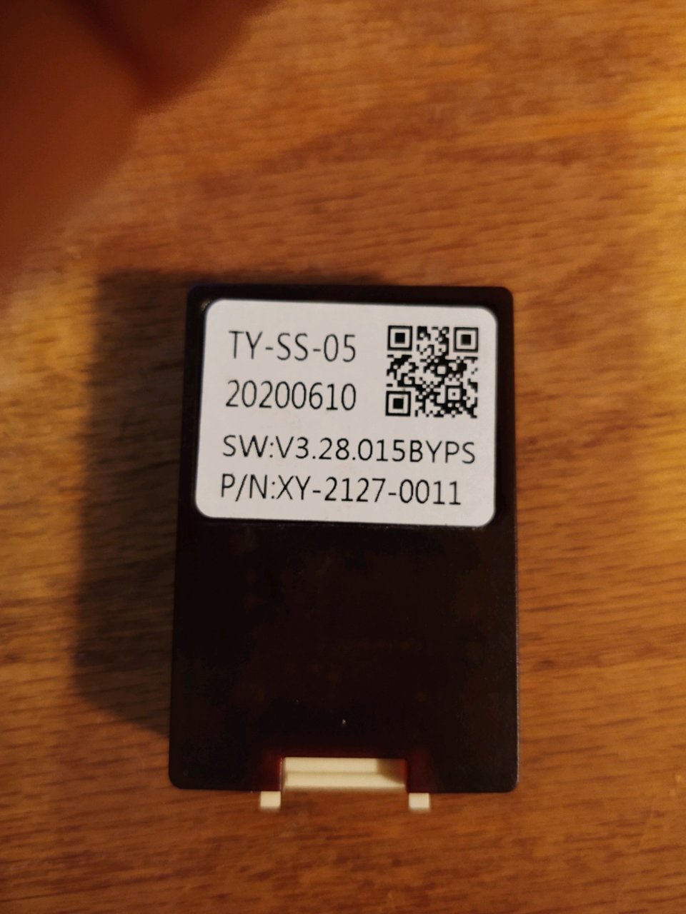

    What's this?
  20. Aug 22, 2020 at 12:34 PM
    #700
    Naszero
    Naszero Well-Known Member
    Oct 21, 2019
    #308621
    228
    2021 Cement DCSB TRD OR 4x4
    That's the CANBUS controller box
