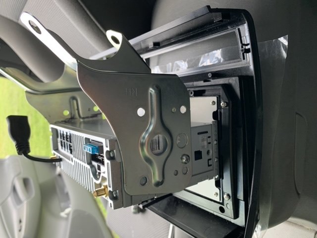

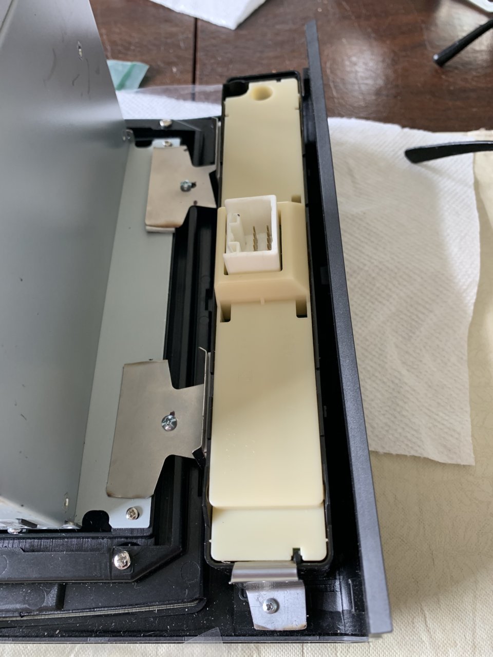

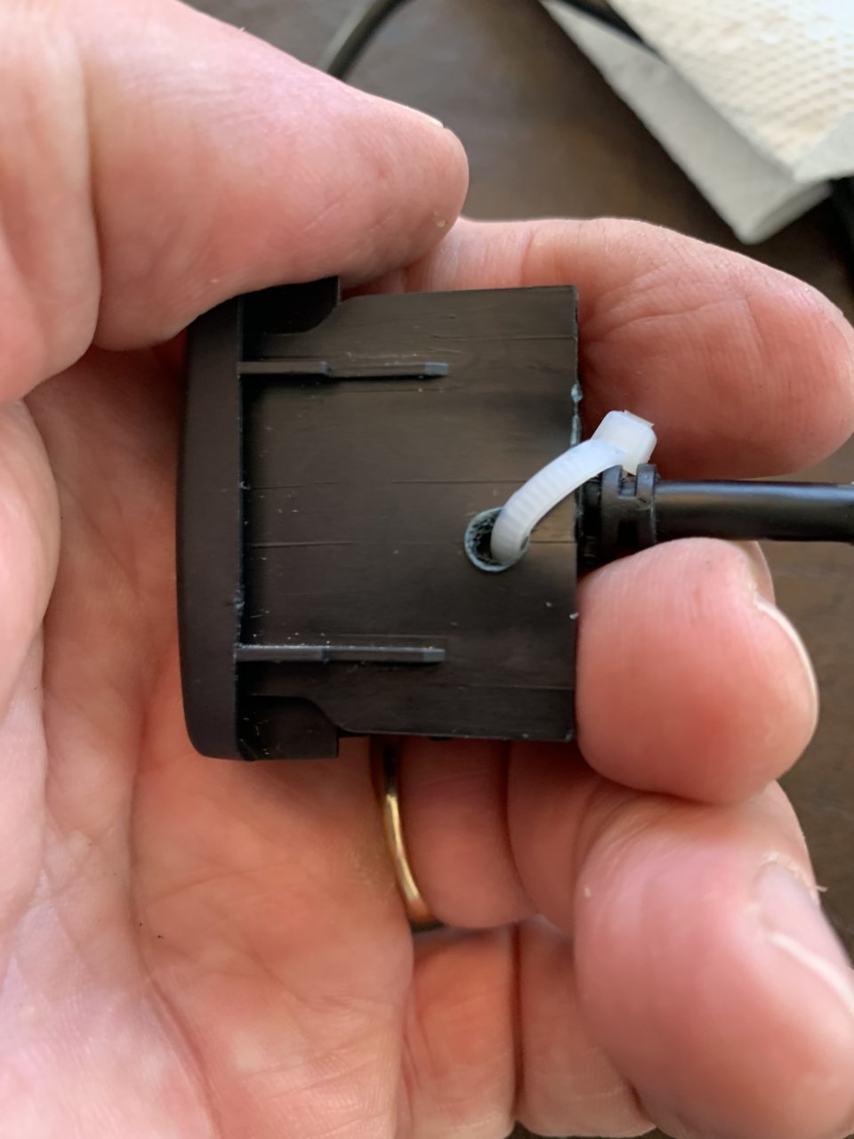

    Just a couple of comments that may help with the fitment issues that might help. My Tacoma is an 05 Access cab. I found that if if the dimples in factory brackets are drilled out with a small bit, the lower one can be used with one screw to install The Dasaita without any need to measure. It’s not perfect alignment but all four 10mm screws will go back and fasten secure. I made some clamps to hold the hazard module which worked pretty well.

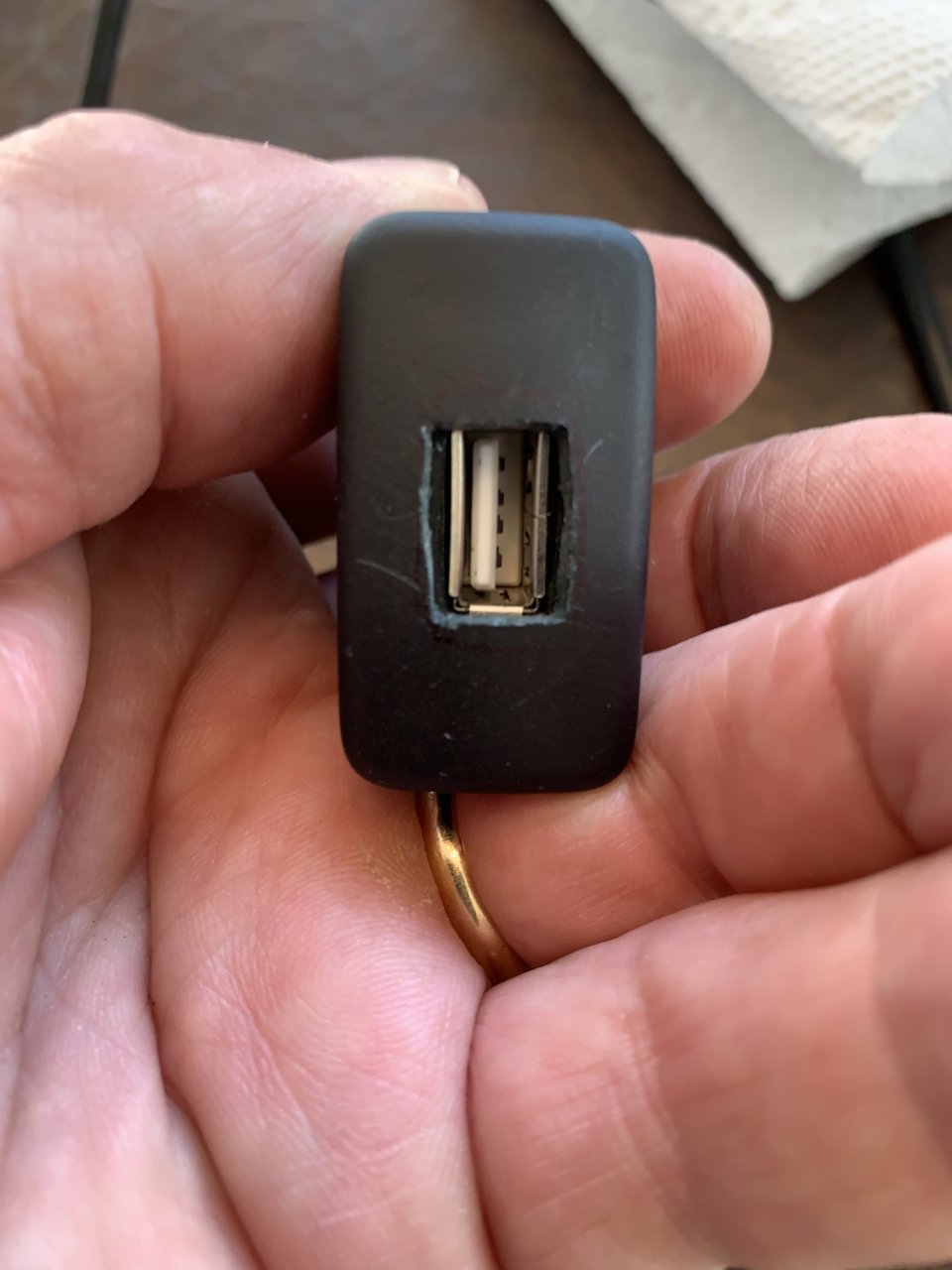

    I used one blank switch insert for the usb connect, used a pen knife cut the opening , and secured with a mini tye wrap. So far no problem with operation and love the Apple Car play.

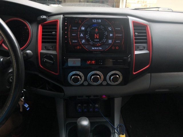

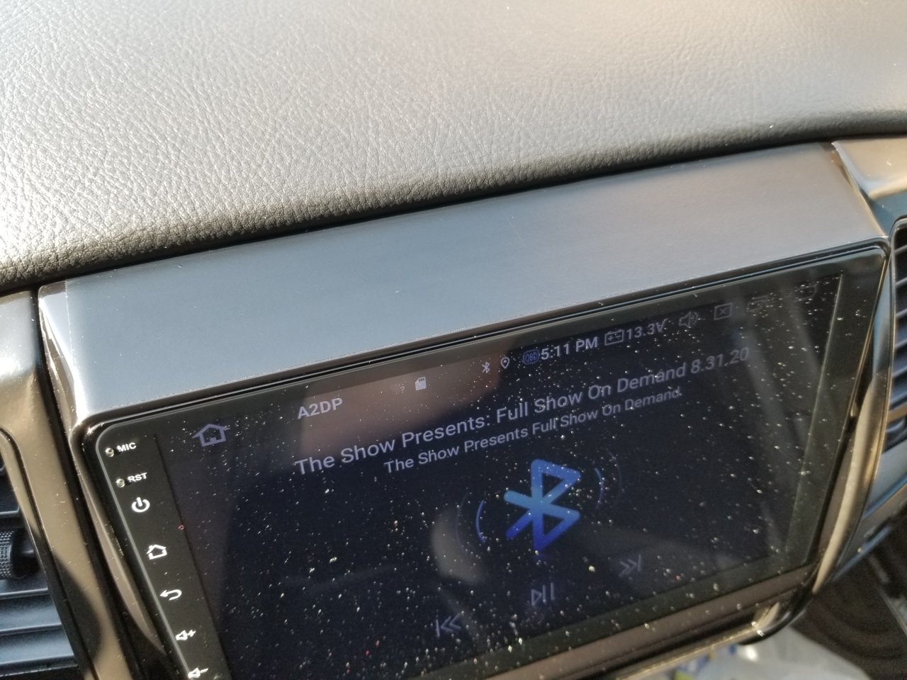

    Just wanted to share something simple. The top of the dash kit was catching the sun perfectly and destroying my eye holes. So I slapped on some matte black adhesive vinyl I had laying around. Did the trick! No more eye hole damage :rolleyes:

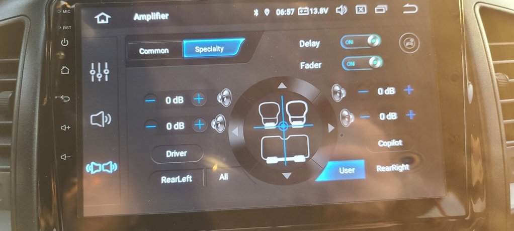

    Here's a picture
    Still can't fade to specific speaker sides but at least it doesn't turn off completely

    Thanks for the fader tip! I've lost a lot of mid-range sound so I think I'm going to bypass my JBL system entirely and just run new speaker wires from each speaker to the HU. I want full control!!! :headbang: I still need to hook up my cameras so that's something to tackle this weekend. Installing a totally new 12v backup camera and I'm planning on simply running new wires instead of tapping into the existing ones and fiddling with the 12v to 6v scenario. I'm still scratching my head on how to hook up my front camera without the HU staying on and not being able to turn off... :confused:

    I really don't think the delay and fader options do anything .. BUT switching it between Specialty and Common does something ..

    what kind of preout voltages are we working with? In whatever DSP settings it has, does it do time alignment? What about crossover points? does it have the ability to run active?

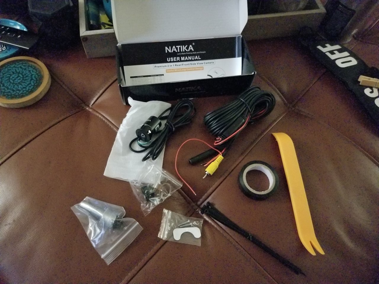

    Going to get this cam set up in my lower grille. Where did everyone tap into for a power source? I was thinking about using the clock.
    Fistgar likes this.

    I did! Worked out really well.
    Tip: one of the rca harnesses has a yellow power wire ready for you to tap into.
    Heres how I did mine:
