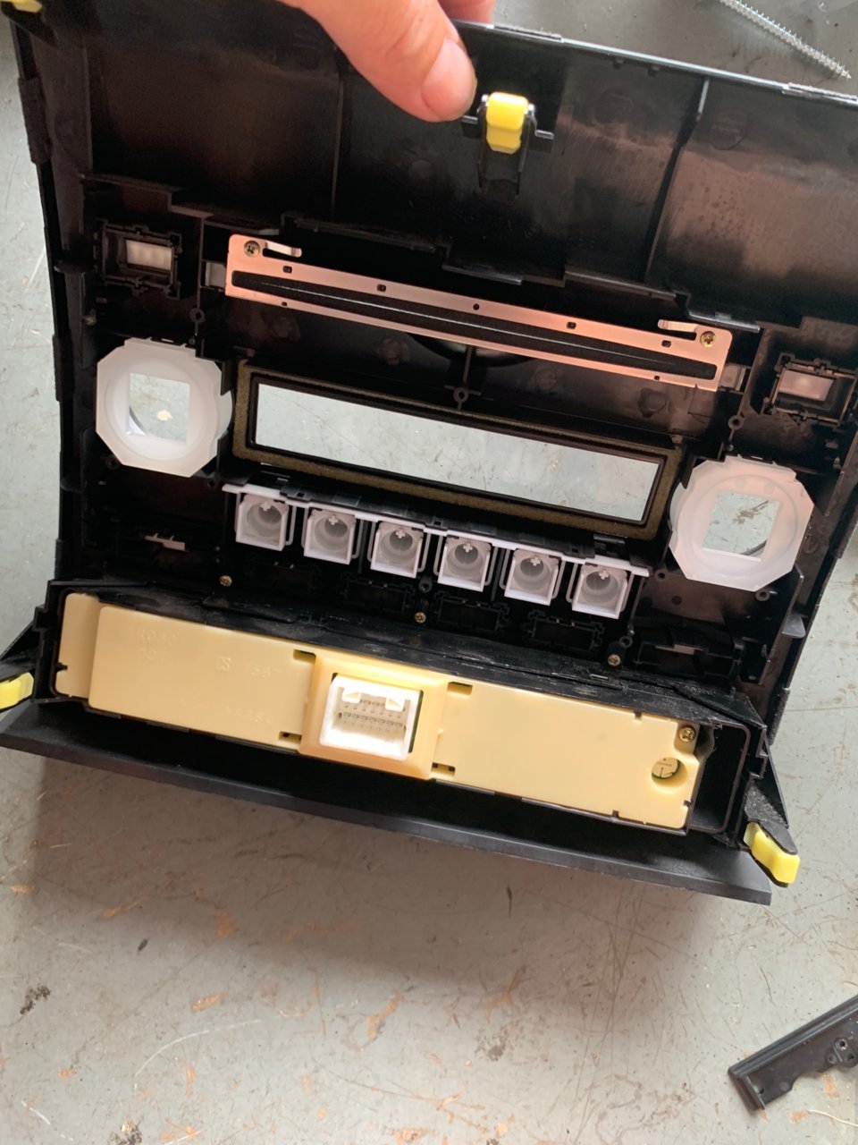

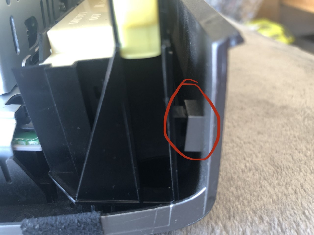

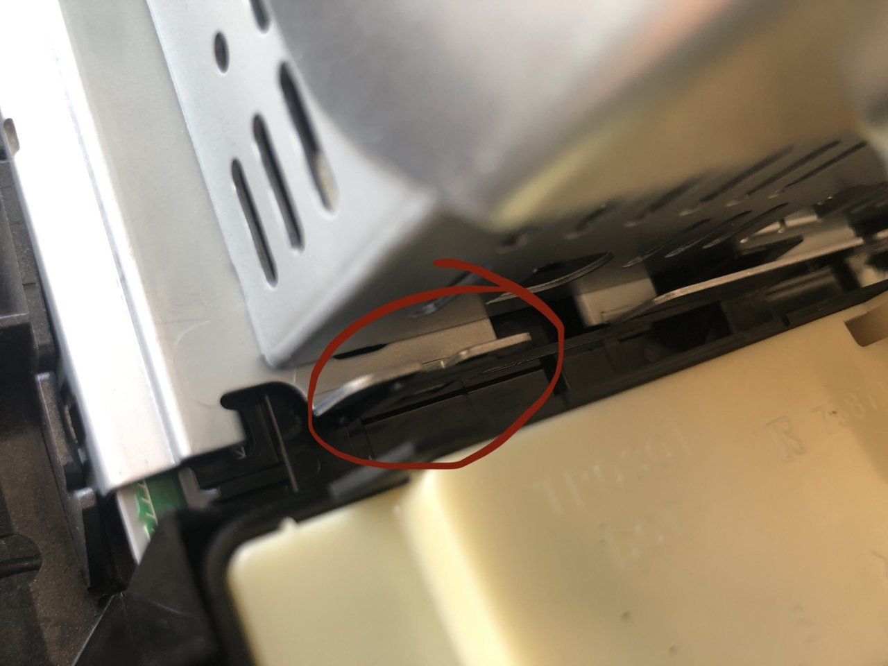

    i’m not sure if this helps, but i finally took my dash apart today to see how that lower hazard unit is held in place on my 2011.
    two small screws on either side.
    three tabs along the bottom.
    three locking tabs along the top.

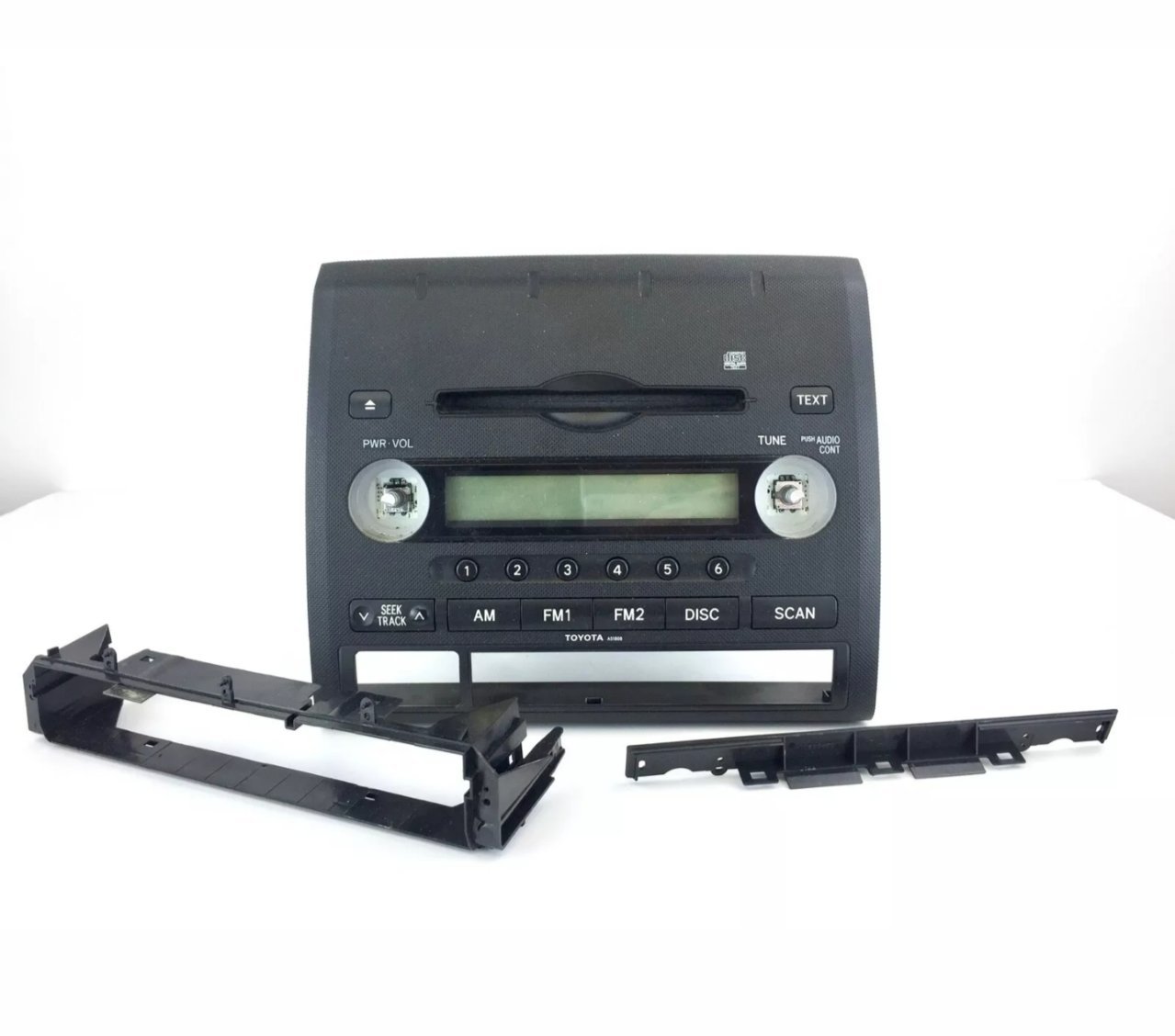

    I think that's the bracket that this radio is designed for. I found a radio on eBay that has the bracket out for a better view. Now I have to see if I can find just that bracket so I can buy one.

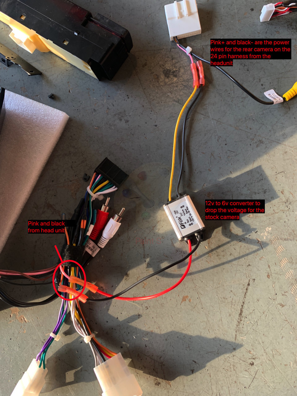

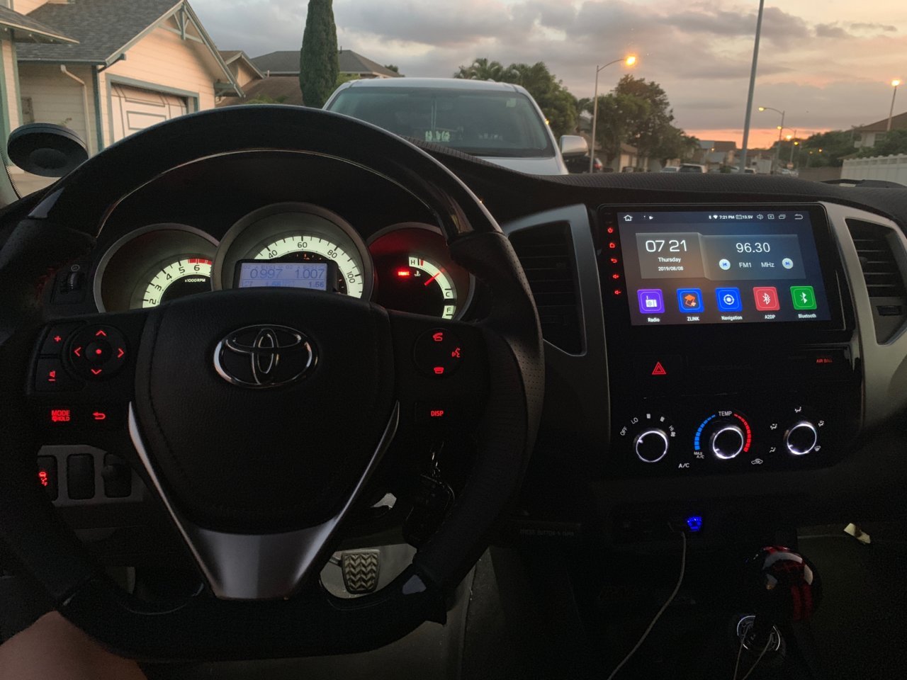

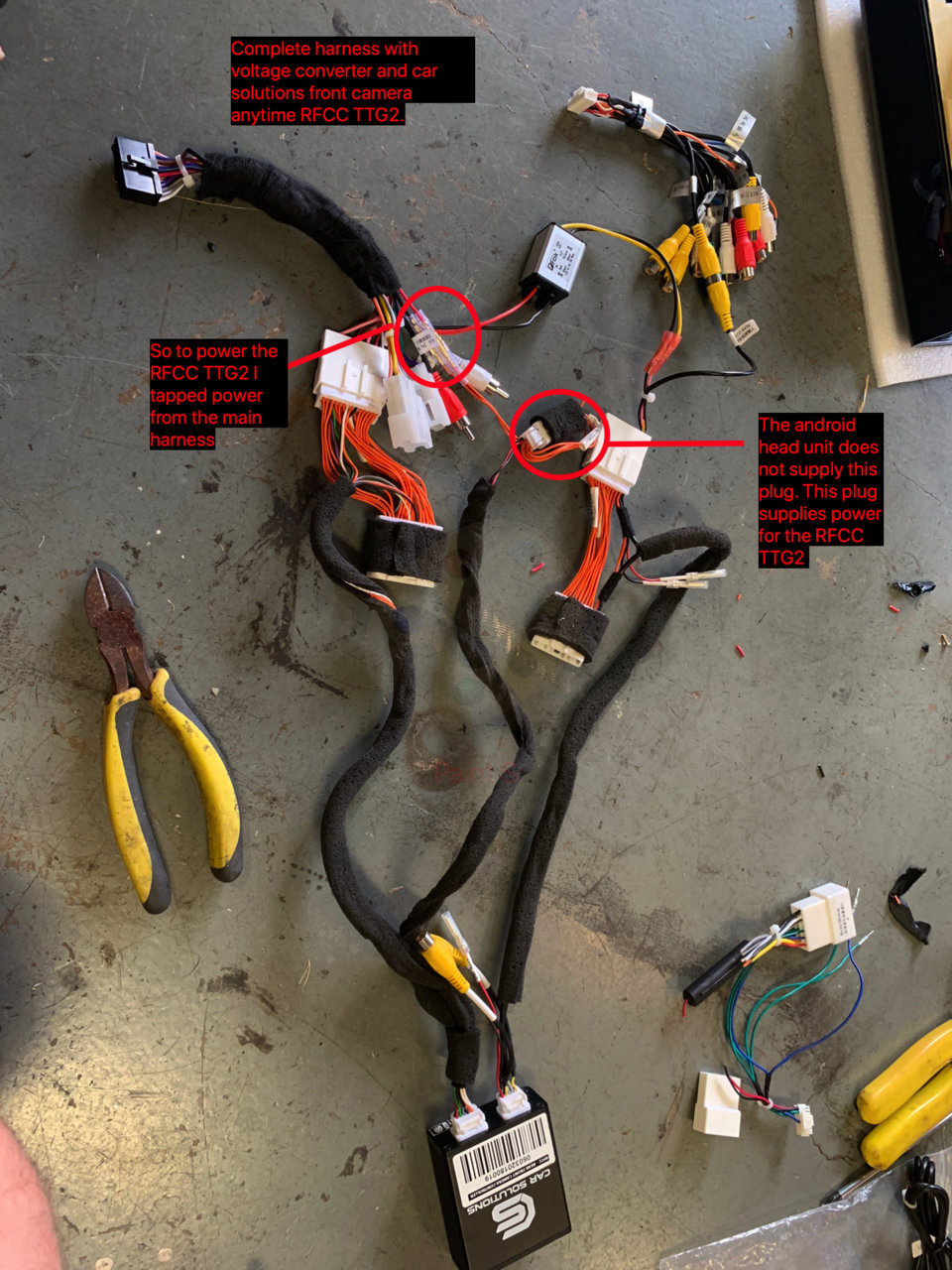

    So I got mine in today and did most of the install also. It is installed into a 2015 tacoma
    I bought the Seicane Octa Core unit.
    Some things to note with this unit. It came with plugs for all the years and there different wiring setups, it also looked to be comparable with the JBL system, I removed the plugs I did not need.
    I had to install a voltage converter to convert the 12v rear camera power output to 6v for the stock camera. I tested this and it works good.
    It would not recognize all of the steering wheel buttons because the 2015 has 3 separate swc(swc1,swc2,swc3) outputs from the steering wheel and the android unit only has 2 (key1, Key2) swc inputs on the unit. I put a 4.7k ohm resistor on swc3 output from the steering wheel and connected it in parallel with swc2. This made all the buttons work but the return/back button and center button of the direction buttons are same. I tried several different resistors and this is the best I came up with in the time I had. I am fine with this setup.
    I have the same issue with the hazard button as the OP. if you find a source for that bracket let me know it looks like that would solve the issue.
    I will post some pictures tomorrow, I still need to do little more work on the install.

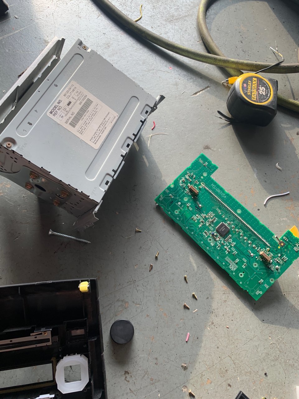

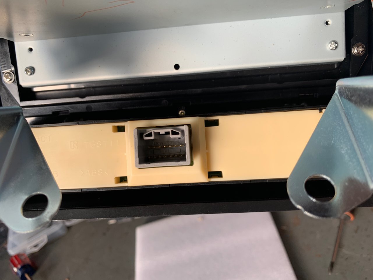

    So I have a 2005 sitting in my driveway with a blown head gasket. I decided today to pull out the radio and see if it has the bracket the op showed above.
    It does have the bracket the op showed.
    you need to break down the whole radio to get it out. I doubt that they will sell it as a separate piece.
    it does fit but I was only able to get the center one of the 3 screws at the top. I had to break off the other tabs as they would not let it mount flush and they did not line up anyway.
    some photos of the radio installed
    lights on

    Some wiring I had to do, this might be slightly different from the OP's unit.

    @arcenik how well does that bracket hold the hazard/clock in?
    If it's solid enough I can find a radio for cheap at a junk yard and just pull the bracket apart. If it's not great I'll just leave it glued in with the hot glue until I have an issue.

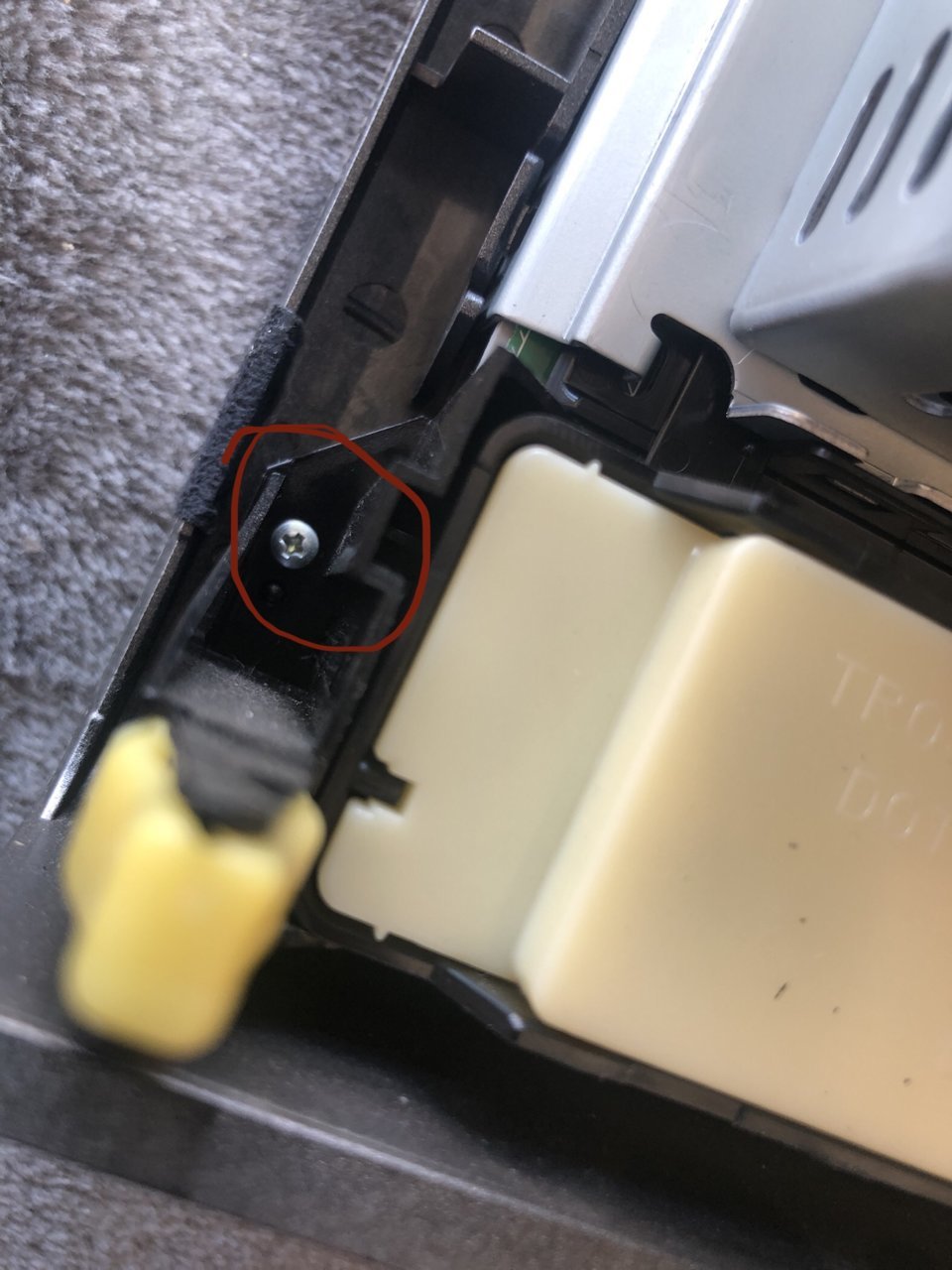

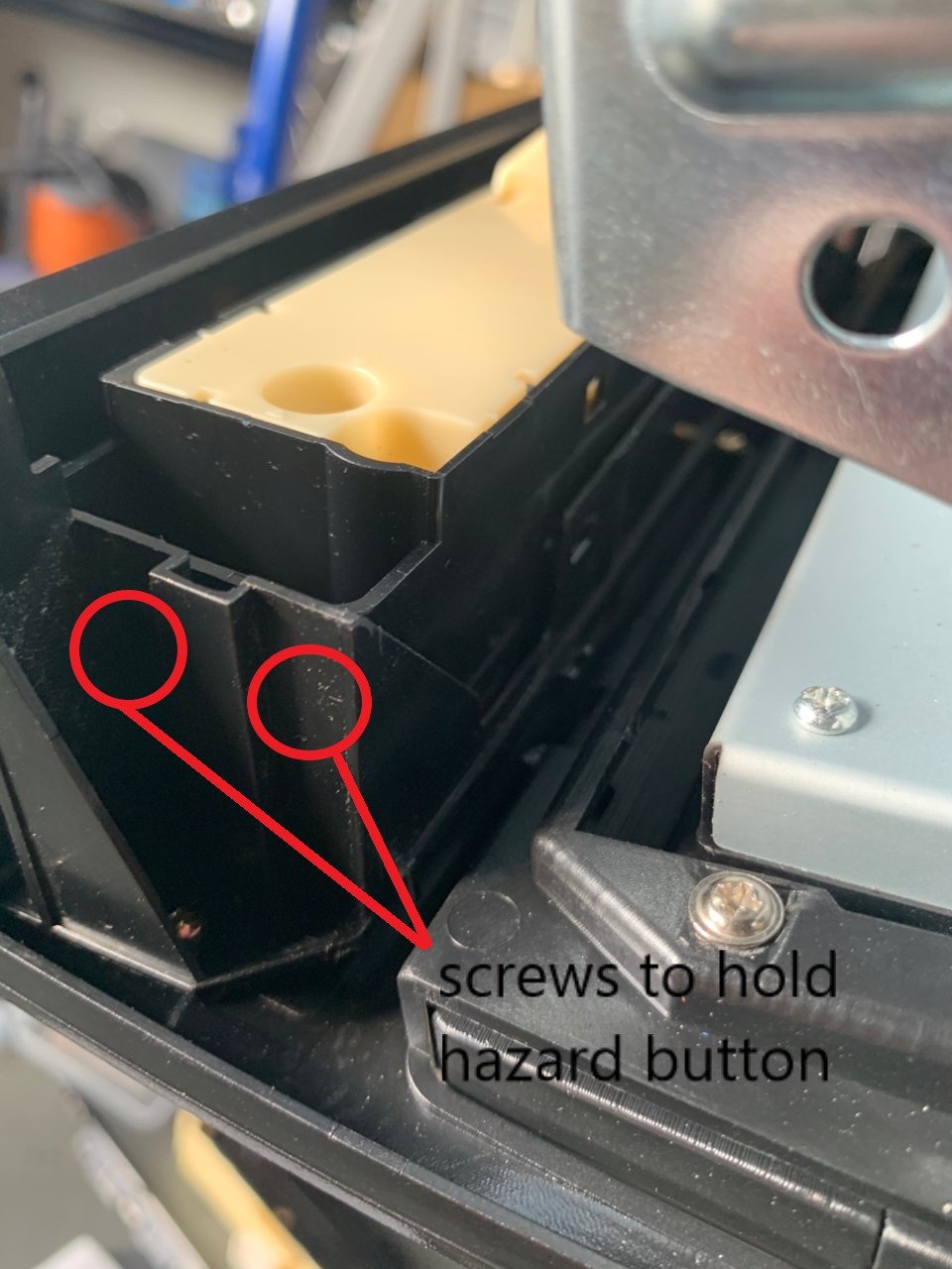

    The bracket fits goods, but my hazard button moves in the bracket a little causing the button to get stuck sometimes. I need to pull the radio and see if there is anything i can do. I am using my 2015 button in the 2005 bracket this might be the issue. The bracket does help hold the bottom of the face plate on better because it now uses the clips to secure to the dash.
    I am probably going to put two screws shown in the picture below to help hold the button from moving.

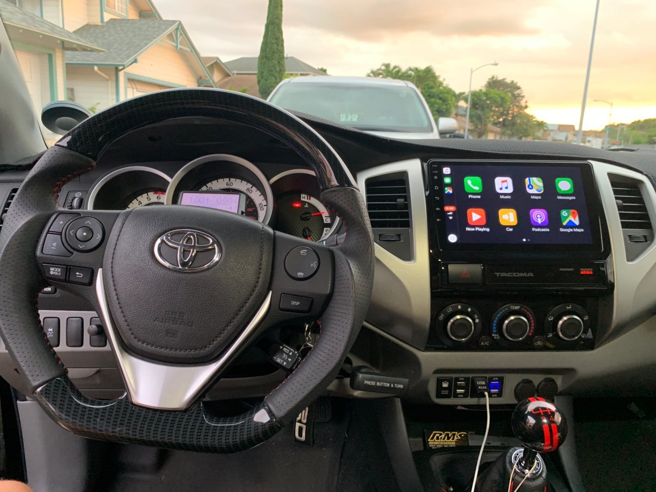

    For my 2013 the Dasaita was completely plug and play. There were three plugs for steering wheel controls on the headunit but the truck only had two plugs and the controls work great.
    I kept the camera in my rearview mirror so I cant comment on that.
    I used the GPS antenna that came with the unit. I coiled the cable up and used the double sided tape to actually stick the receiver to the top of the unit. There is only plastic above it inside the dash and I haven't had any issues with reception.
    Between the top level Seicane unit and the Dasaita it seems the plastic dash frame is basically identical as is the screen. I think the internals are what differ. I wanted the extra internal storage because I loaded about 40 gb of music onto my unit. I also wanted the DSP for sound control as I am running aftermarket components and amps. I can't compare to the seicane but the PX6 cpu and the ram in the Dasaita seem to keep it nice and snappy.
    One note to make is that the seicane seems to have carplay built in and the Dasaita does not. I purchased a carplay dongle on eBay for 45 dollars and it works flawlessly for carplay. Personally I am an Android guy so I use Android auto with the headunit Reloaded app and it works great as well.
