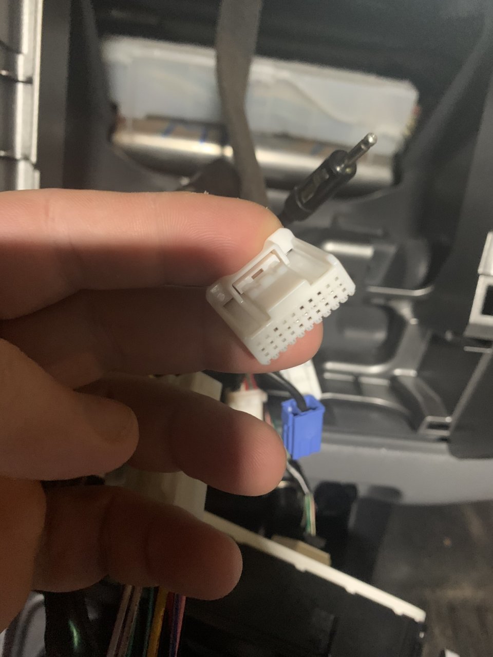

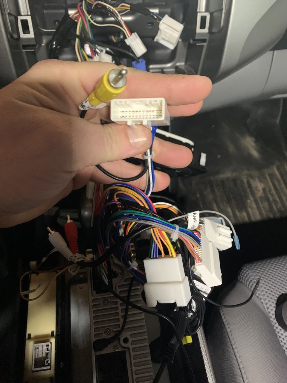

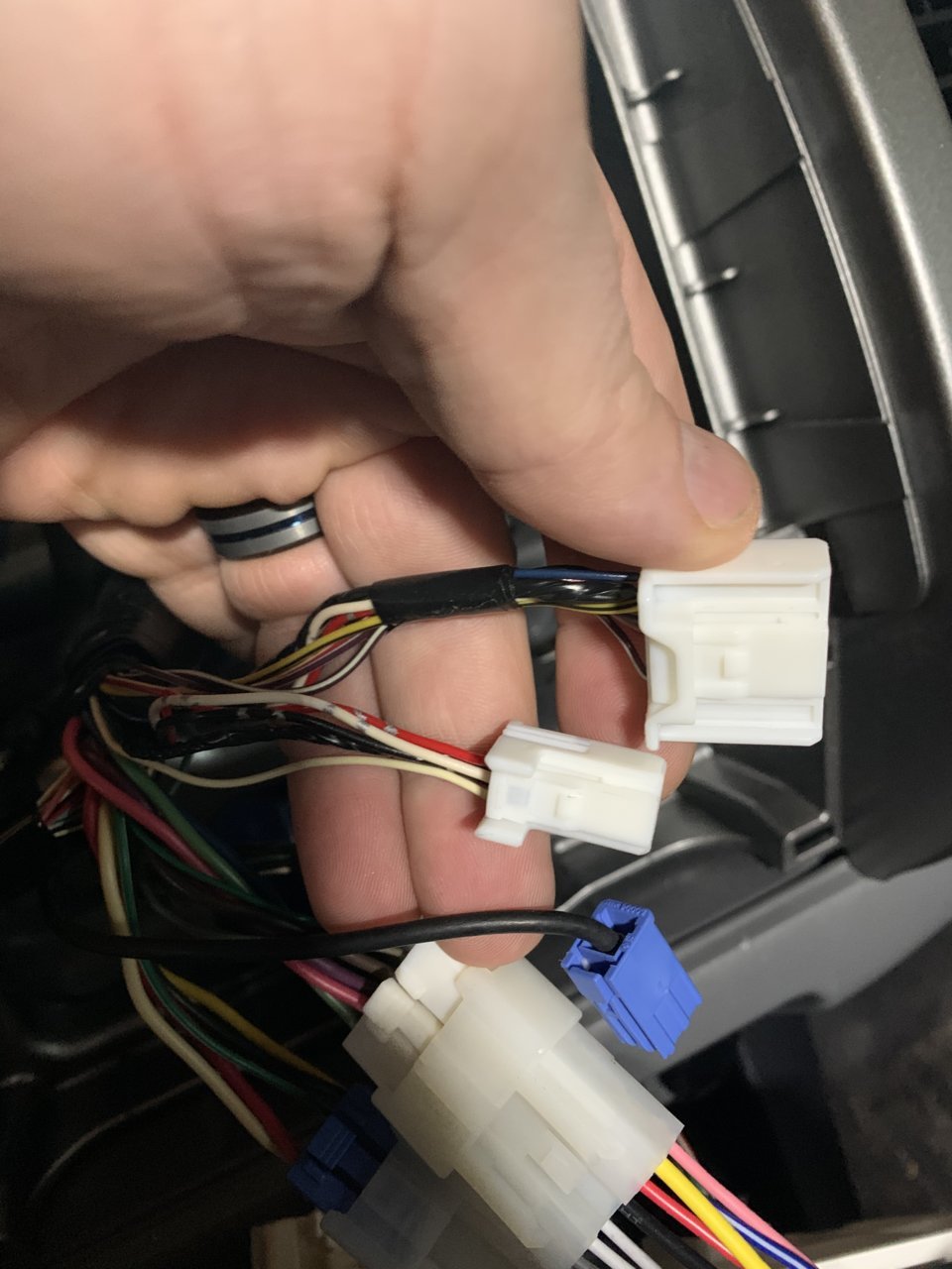

    you mind if I bounce a few things off you?
    First this is my OEM deck
    this is my dasaita

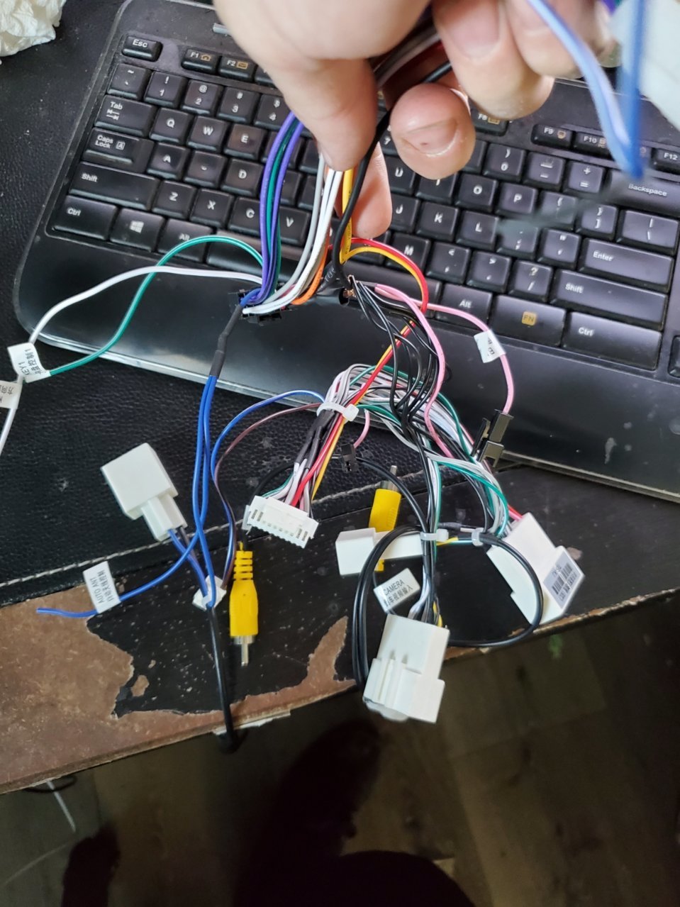

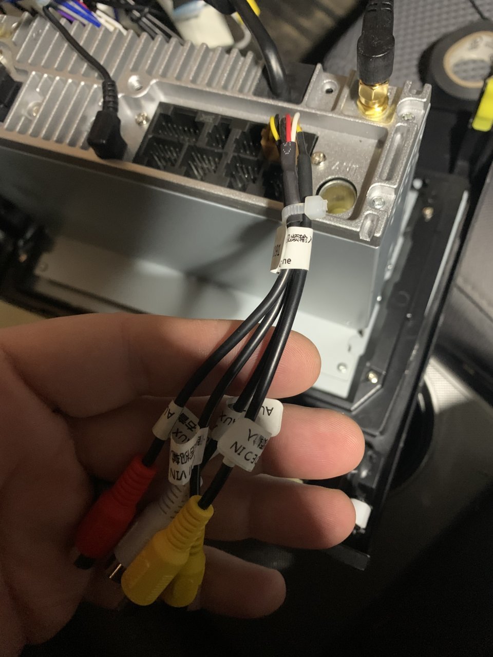

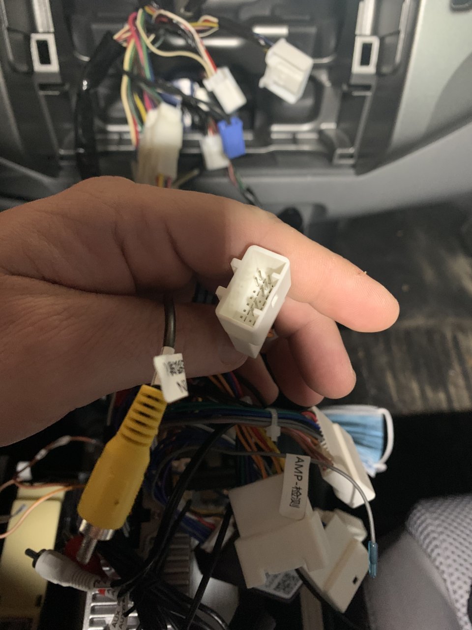

    They sold the Canbus as plug n play, yet I have these 2 wires, are they for the steering wheel controls
    Both rca video plugs attach to their own white plug on the Canbus that has nowhere to plug in to the car side connectors
    15A8453A-D8A5-47FD-BD3A-6530319F7807.jpg 232F072F-9B39-403E-832F-7BD7D3060D42.jpg
    This connection doesn’t seem to do anything deck side
    These are the unused car side connections

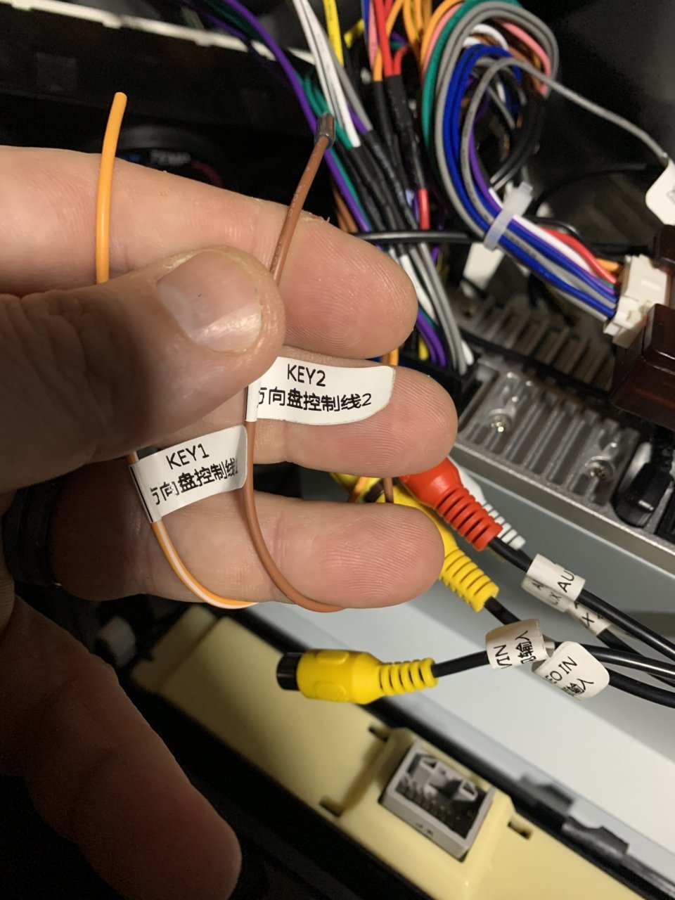

    So SaitaNav is sending me a DYX004 cable to see if this addresses my steering wheel controls not working. From what I can gather from taco tunes is this cable is what I need to connect to on the vehicle side.
    And the CB004 does not have this plug.

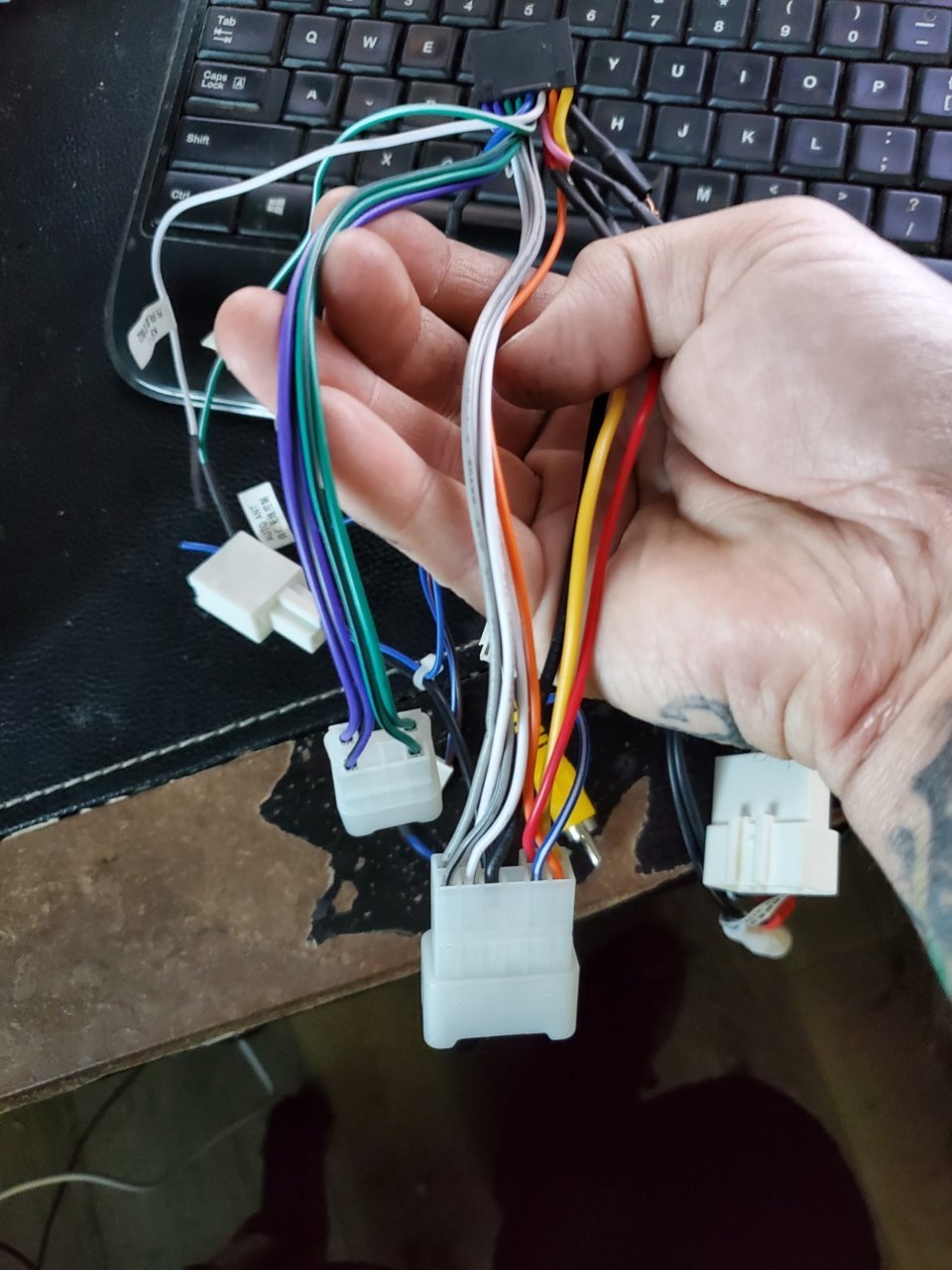

    so far i only use these..
    i dont use all this
    there is a lil black box that connects to one other plug but im pretty sure it does nothing lol

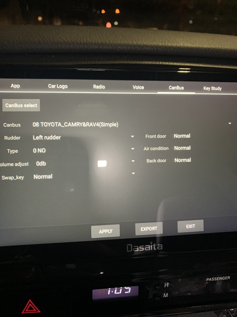

    Ok - Steering wheel controls now work!!!!
    Camera doesn’t and I’m not convinced it’s supported with their kit. That’s ok because I have it in my rearview mirror.
    SaitaNav had me switch to Canbus in the factory settings, I switched back to SWC and it all started working.
    Prove me wrong, but with the non jbl deck, regardless of factory backup camera, you do not need the CB004 on 2.5g

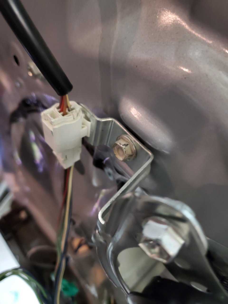

    DTF race kit, DTF front bumper, king 10"dual rate shocks, URD CAI, total chaos upper control arm brackets, method race wheels, 35/12.5/17 bfg ko2, mcneil TT bedsides, custom SLX Motorsports front fenders, fox bump stops

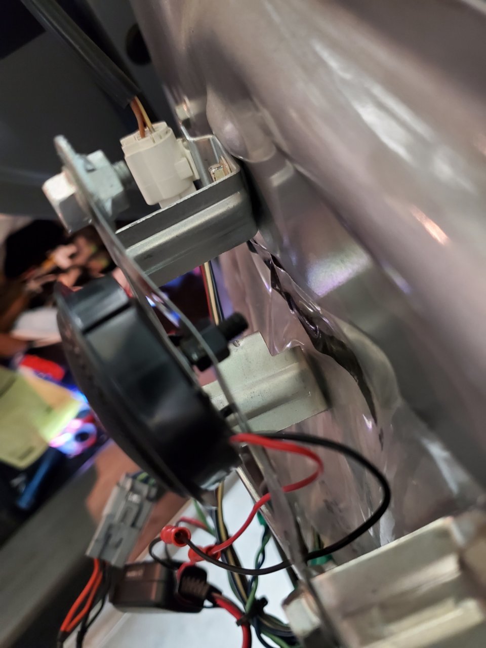

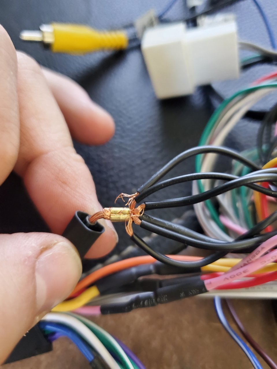

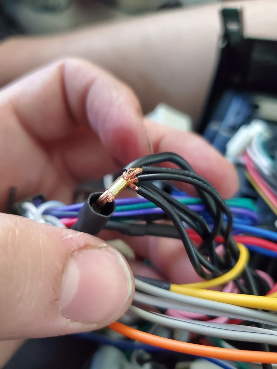

    well...... im pretty sure i just found the problem... im no expert, not sure how to fix this.. im guessing with a ground.. but where? or some insulation between the door and mount? was just messing with the tweeter and spark and music when out.. and it would come back when it sparked again.. explains why it would go out when i was just driving.. the bass vibration would make it spark and go out.. im guessing this would cause the static on this side to? heres a link to the spark show https://www.youtube.com/watch?v=zR5oFPuuIXQ&feature=youtu.be
