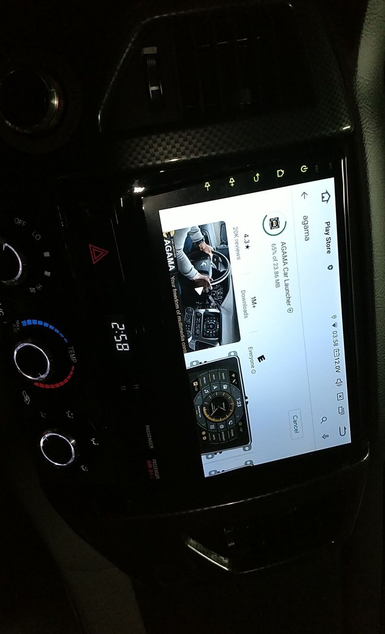

    Got it installed! It's awesome. I used a glue gun to secure the hazard housing.
    I downloaded Agama and boy is it sweet.
    My rear view camera is in my mirror so I'm not doing anything yet. But mine came w the converter wiring.
    I ordered a OBD2 reader and downloaded Torque.
    I ordered a USB 3.0 CD/DVD Player for $15.
    More updates will follow but I'm really stoaked about it.signal-2020-12-08-145844.jpg

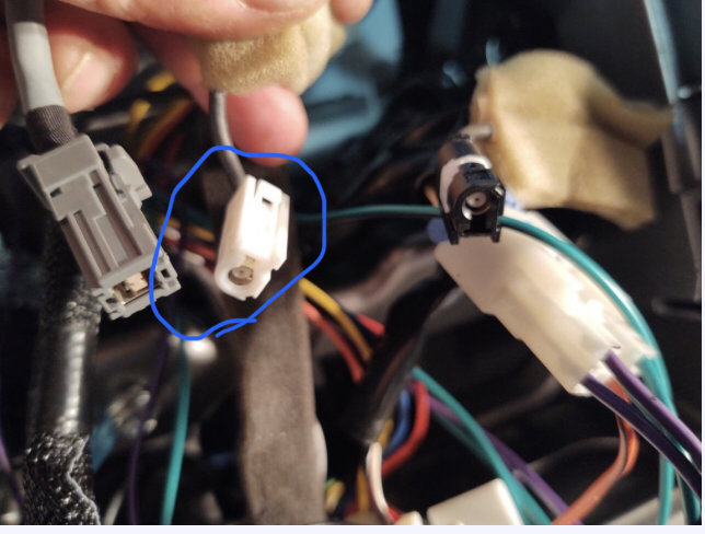

    Ahh, I found a pic of it this morning. @Arrowshot did you figure out what this one is? FFAAADF7-4D2F-4BE1-8B28-5005CDDC529F.jpg 717

    Any ideas why my screen would blink fast:annoyed: It’s not turning off the unit. Doesn’t matter where I go in the apps or settings, music plays fine uninterrupted, I can log on the internet, watch YouTube, whatever I want to do. I turned the truck off for a bit and let it sit and turned it back in and it’s still flashing. It does feel warm on the screen to the touch, maybe it’s hot and in a protection mode :notsure: I went from blown away cloud 9 super stoked to I’m about to punt this back across the ocean to China. :frusty:

    I hunted it down and found this link tucked away in the Tundra forum. Lol, I was digging deep today. Easy fix... turn down the brightness to 90%. I did it and zero issues since. Well from that, I managed to epoxy my hazard switch:facepalm:I hot glued it and didn’t have any luck first. I had some clear gorilla epoxy. I taped everything up and dabbed it in there with a couple pop cycle sticks. I managed to get some in the screen too. Rubbing alcohol cleaned everything up really nice. I was to free up the hazard switch which a utility knife and dilute the epoxy was which the rubbing alcohol and a q tip. I kept working it till it would pop in and out on its own. I kept working it every 5 minutes or so till all the other epoxy got hard. For the record I didn’t put it on the switch it ran a big glob over there when things were still soft:anonymous:

    Not my pig, not my farm. But that looks vaguely coaxial. Could it be the OEM radio antenna and gps lead respectively?
    I've got a 2013 non-JBL without nav. That lower left looks familiar in that way.

    I just left it unplugged and everything works fine. I think it may have been for the USB. I ordered up a new usb outlet, backup camera harness and snagged some M4 screws, lock washers and washers. I’ll go back in there when I buy an amp, front camera and finish it all up. I think once all the little bugs and quirks are worked out these are a pretty sweet unit.

    True that. If you used the Dasaito provide GPS, then the OEM GPS is surplus. I plugged the traditional antenna plug into the radio, but didn't realize the harness part was disconnected. On top of that, the unit came with the incorrect Americas frequency selected. I could just barely make out a station and it took a while to hunt down all the places to get it corrected.
