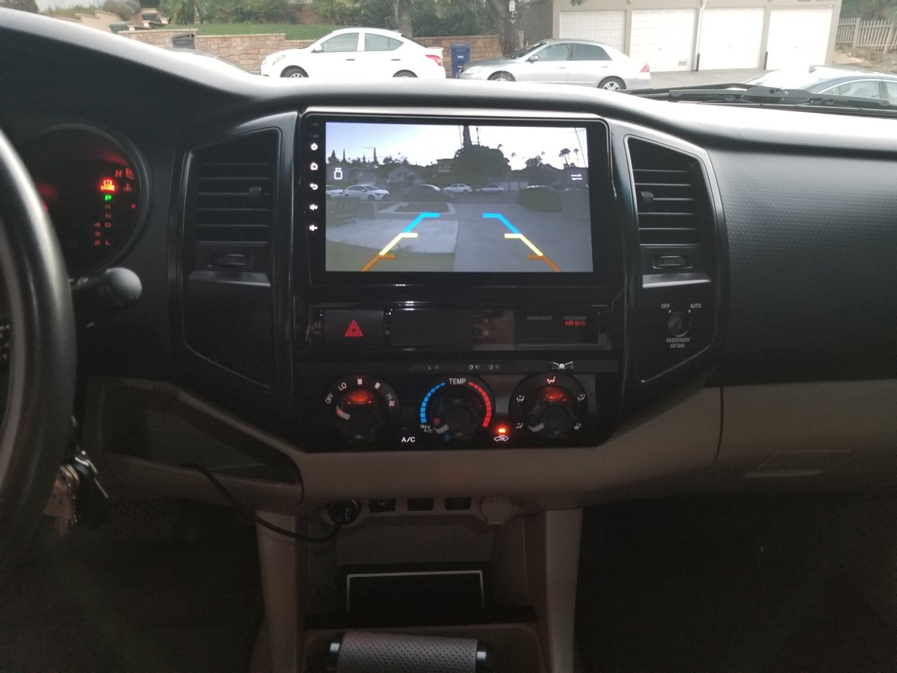

    Looking good buddy!

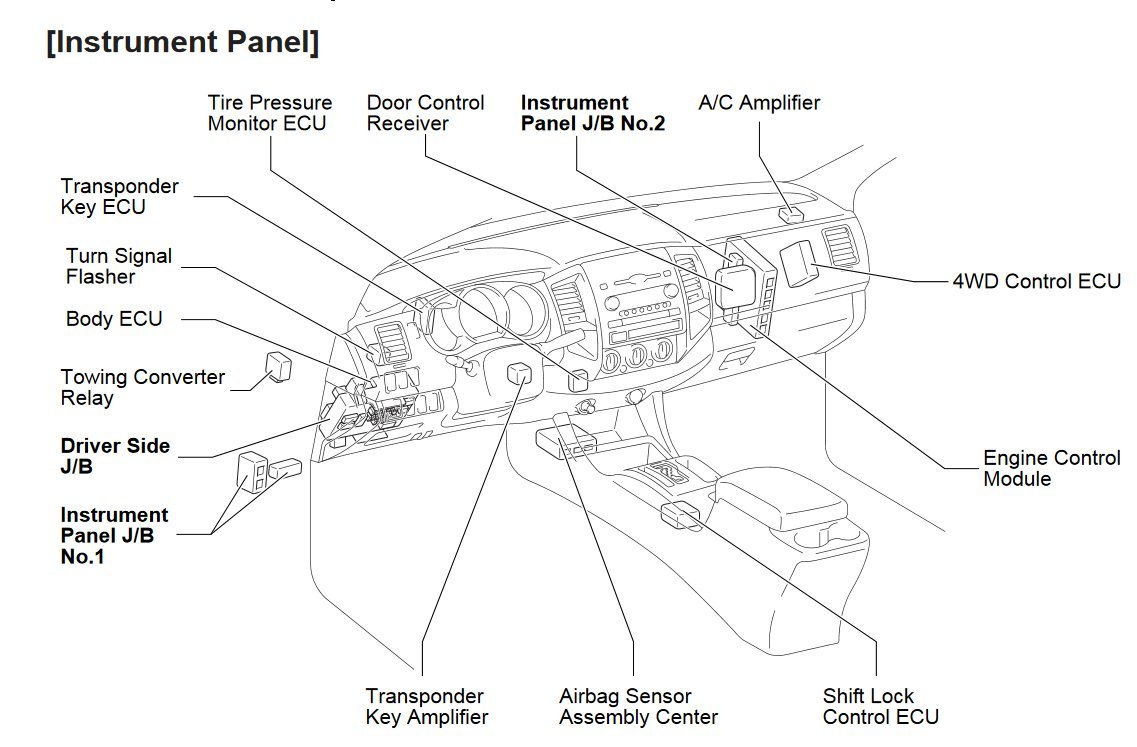

    Ya, I remember you would have to buy the whole dasaita tpms system and I was told you would then have to replace all four (or five for spare) tpms sensors in the tires and then sync them with the new harness connected to your headunit. :burp:
    But now these are the way I guess. Kinda sketchy, very easily stolen IMO.
    https://www.amazon.com/dp/B077QRN6ND/ref=cm_sw_r_cp_apa_i_SBl-Fb643N513
    As for where the OEM tpms receivers location? Should be below the climate control.
    As for the engine temp through the odbII reader. I use torque as well but only for thrown codes and I haven't really explored it much. The engine temp is always readable on the dash :D

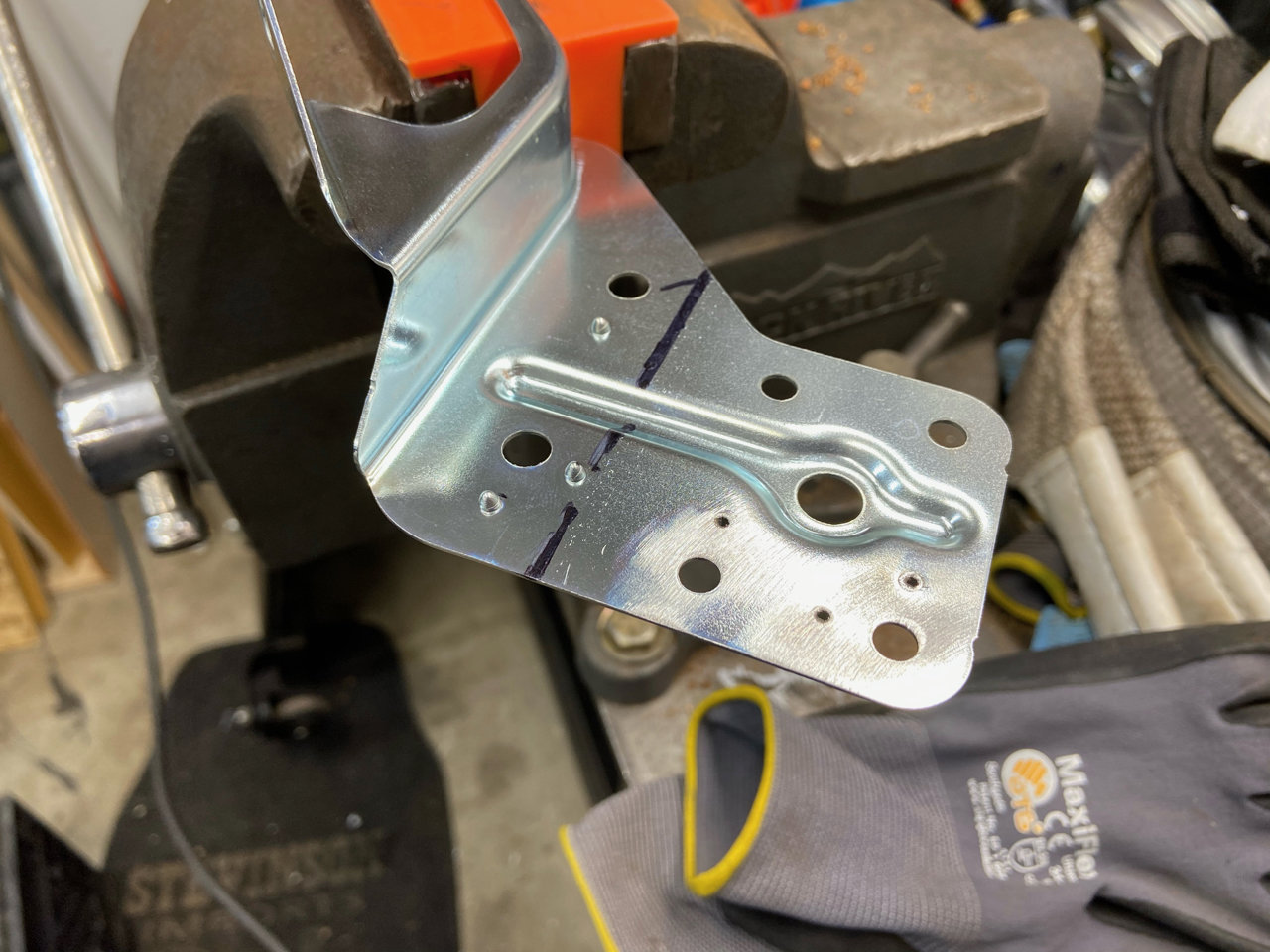

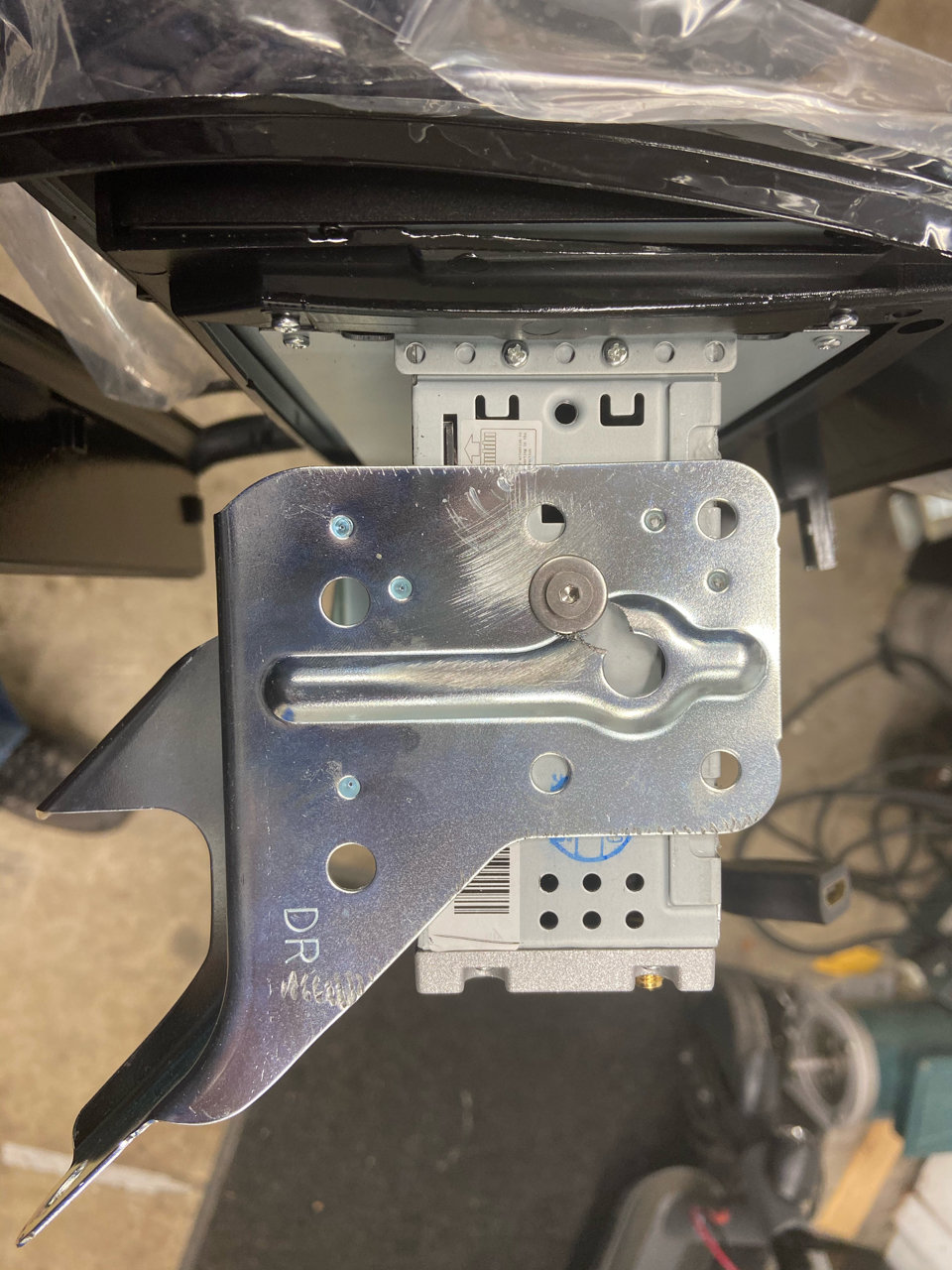

    Success! I was able to get my 2013 hazard and clock to be securely mounted in the Dasaita unit. I had to purchase a stereo from a pre-2011 truck.
    Step 1 - disassemble to reveal screws for bracket (screws already removed)
    Step 2 - Remove bracket by held in with 5 screws and a couple clips
    Step 3 - Install 2011 and newer hazard switch into the bracket, it's held in perfectly with all the clips
    Step 4 - Only the center screw boss and the two edge ones line up. The clips on the bottom also line up. This feels plenty strong.
    Step 5 - trim the tabs, You need to remove the pin on the center tab and remove the other two completely.
    See, only the middle tab works. there are still two more screws on the outside edges and clips on the bottom.
    Step 6: Success - I needed to buy some additional clips as I lost one behind the dash and the new stereo did not come with any for the hazard bracket.

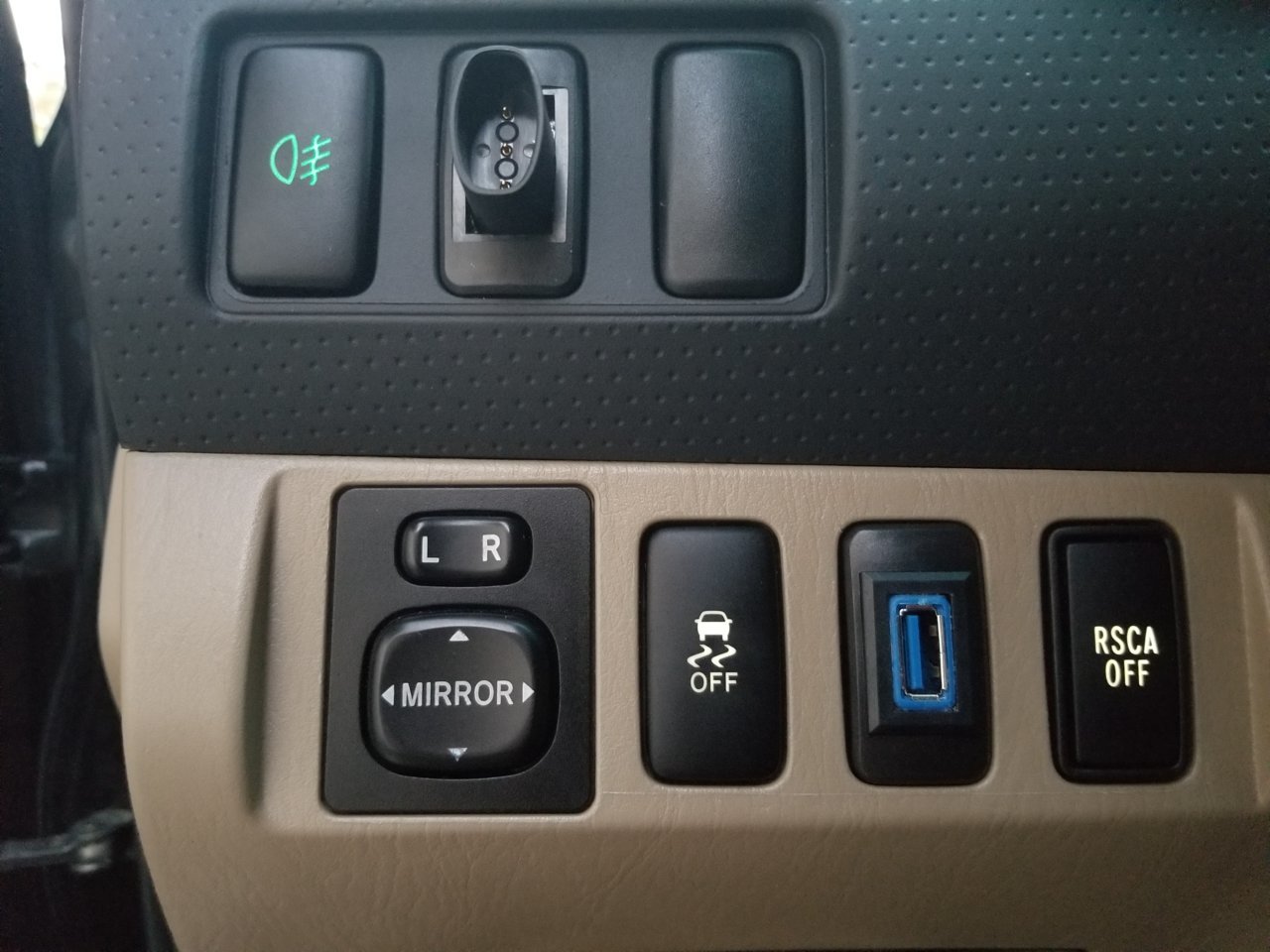

    I got the stock USB plug to work with a Scosche TAUSB01B usb adaptor. Plugs into the socket behind the dash near the stereo and then plugs into the Dasaita USB port. I cheaped out and bought a no name brand one that did not work. I bought this slightly more expensive one and it worked great.

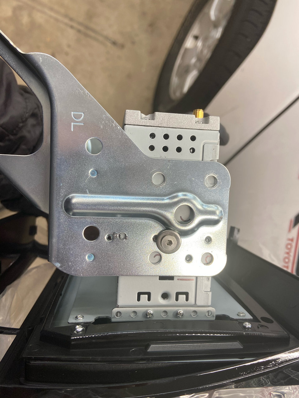

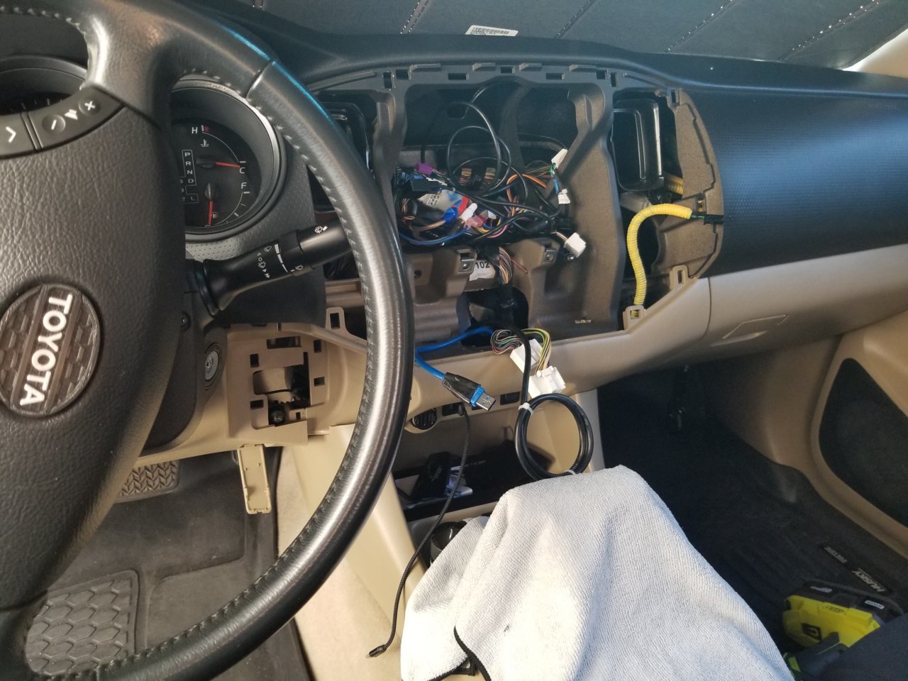

    Out on the Mojave Road my head unit was flopping up and down badly on every every bump and over the miles and miles of washboard. When I got back I found the earlier post of the guy who reused the OEM brackets and I got mine mounted. I also needed to slot the hole and use modified large diameter washers, no way the brackets will line up correctly with the head unit and bolt in place without doing this.
    Now there is zero movement, rock solid. I also put felt tape (rattle-reducing flocking tape, https://www.mcmaster.com/7417A2/) around the bezel to prevent creaks and groaning from dashboard movement and expansion & contraction.

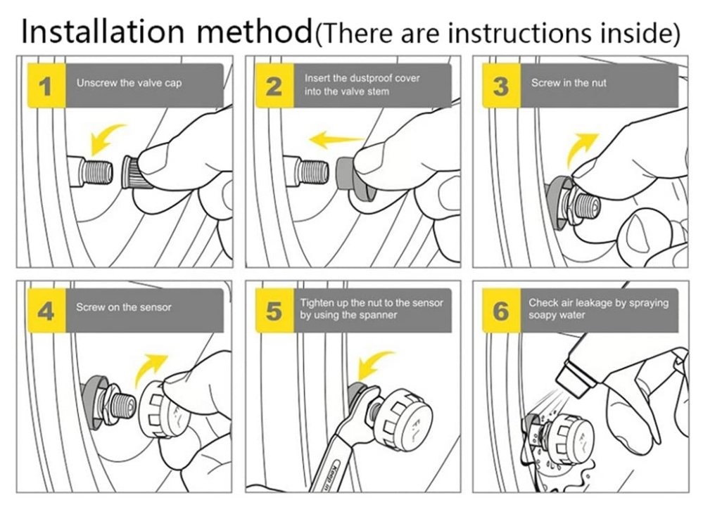

    After convulsing through the various OBD/CANBUS urban legends on tire pressure access, I took a chance on this inexpensive TPMS solution. I wanted something that would work with the FCCLauncher that I use now. It's a pretty straight forward system. Four replacement stem caps with back side locking nuts on the stem, a USB receiver and a USB stick with software. The caps are marked with Right/Left and Front/Back and should be placed accordingly. The receiver should be placed far away from the head unit.
    I was a little paranoid about using the USB stick for software and the FCC supposedly had native support. However in order to use this TPMS sensor (as app and as widget), you need to install a plugin from a FCC indicated google drive to gain the functionality. I guess if I trust the FCC as the launcher, then I'm reluctantly trusting the plugin. After the fact, I did bring up a small Raspberry PI with TinyCore just to interrogate the USB stick. My paranoia was not founded in this case as everything was benign. YMMV.
    Once installed, it immediately fired the low pressure warning as it acquired all the sensors. So at least that part works. I changed to PSI and F measurements for my tastes. I was pleasantly surprised that it included tire temperature as well. I was expecting some drift in the pressure reading, but they were in agreement with my manual pressure gauge and portable inflater gauge. I was also impressed that the FCC plugin also showed the battery strength in display.
    I'll try them out for a while to see how reliable and how long they operate. They also offer an internal stem unit that might be in consideration when I buy a new set of tires. Initial impressions are favorable. We'll see how it unfolds.

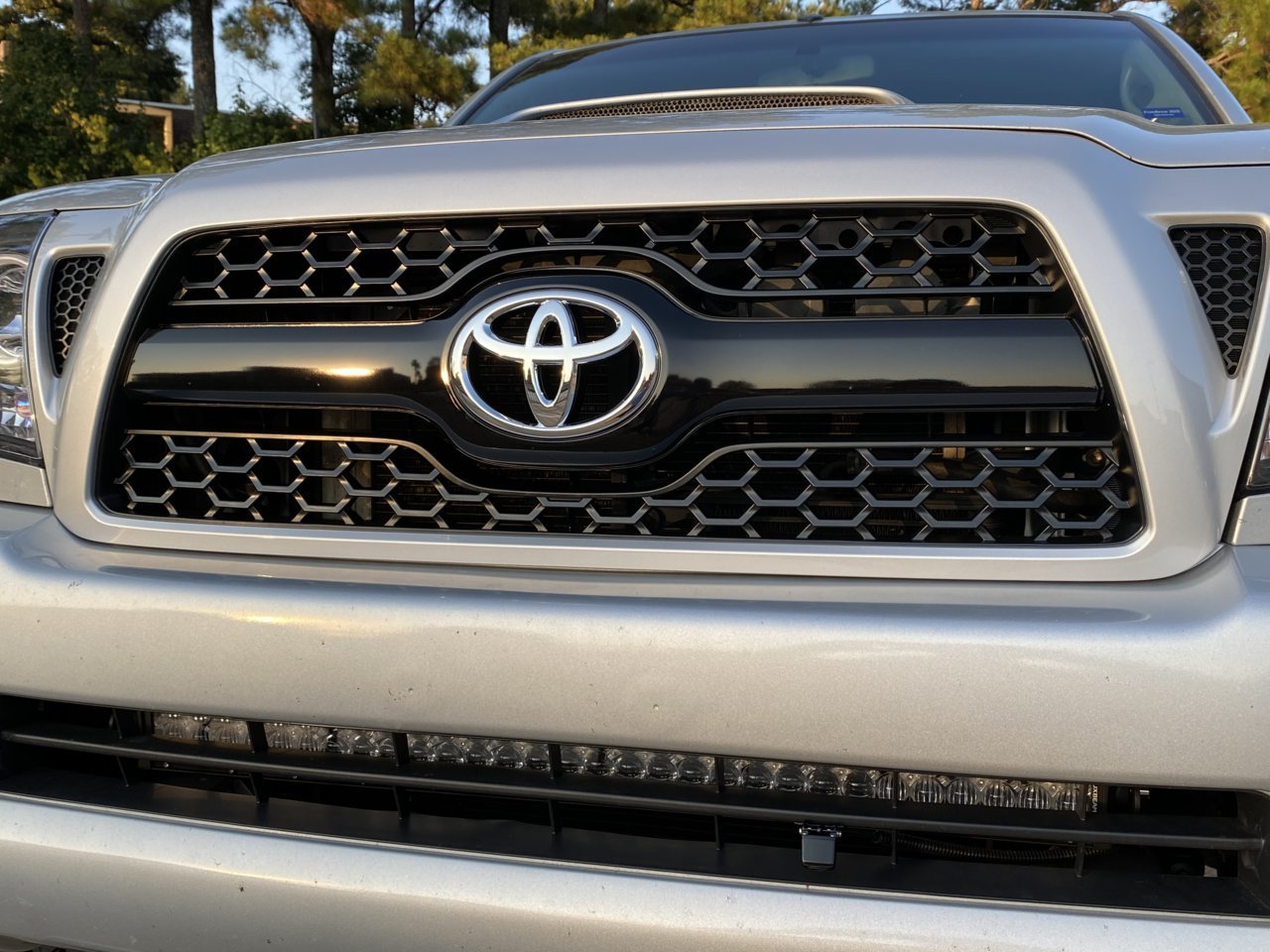

    Natika Backup/Front View camera, same as the rear. I don't have it mounted yet, the 2011 grille is not that easy to find a good place to install it. I'm probably going to print something to mount it near the top. It'll have to be off center but that's not a big deal.
