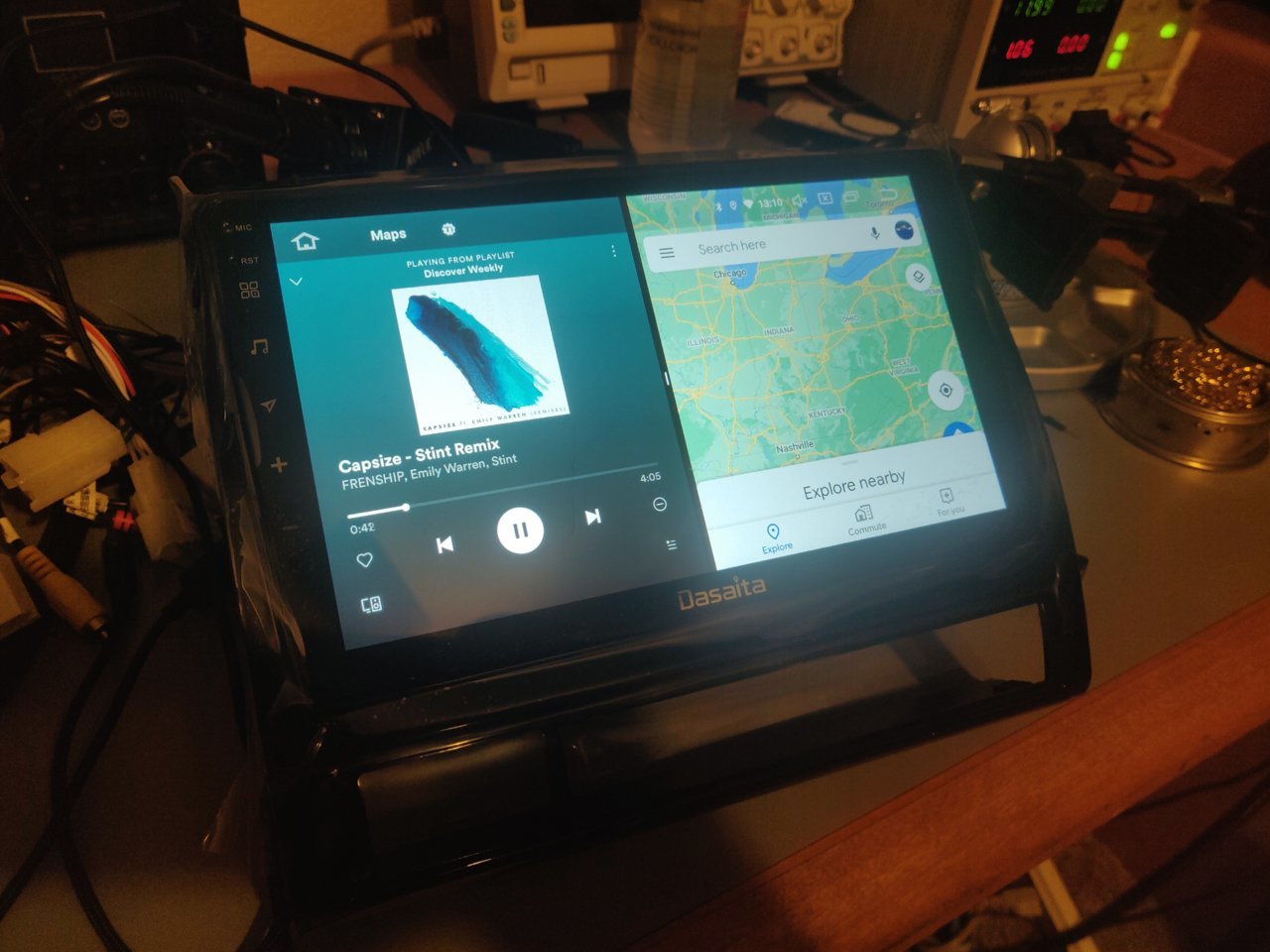

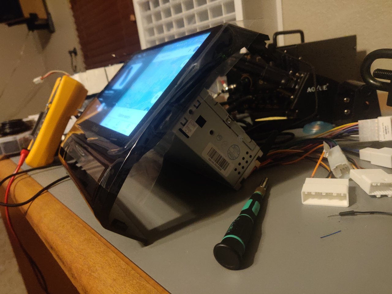

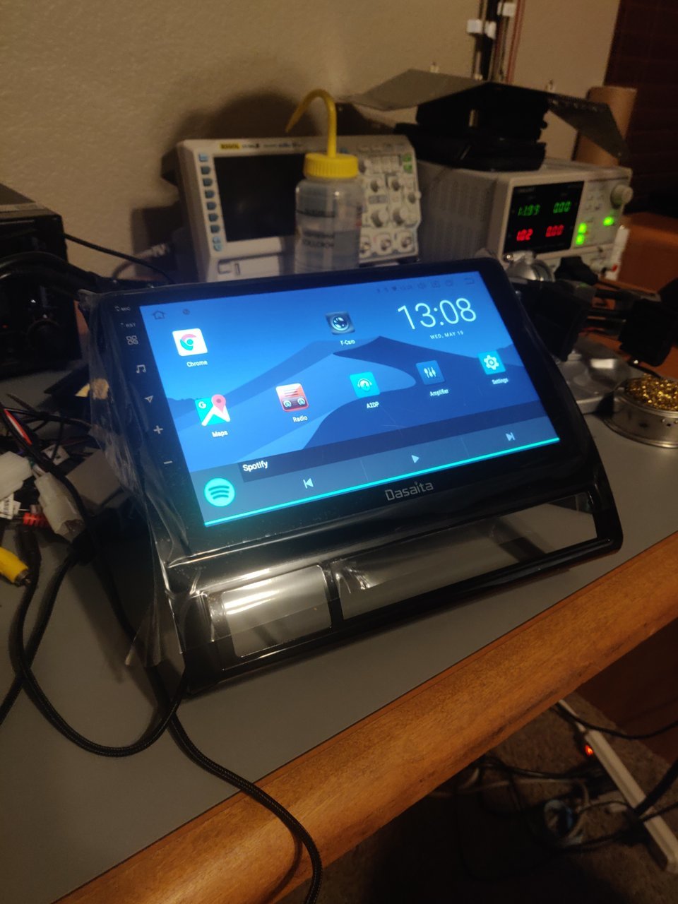

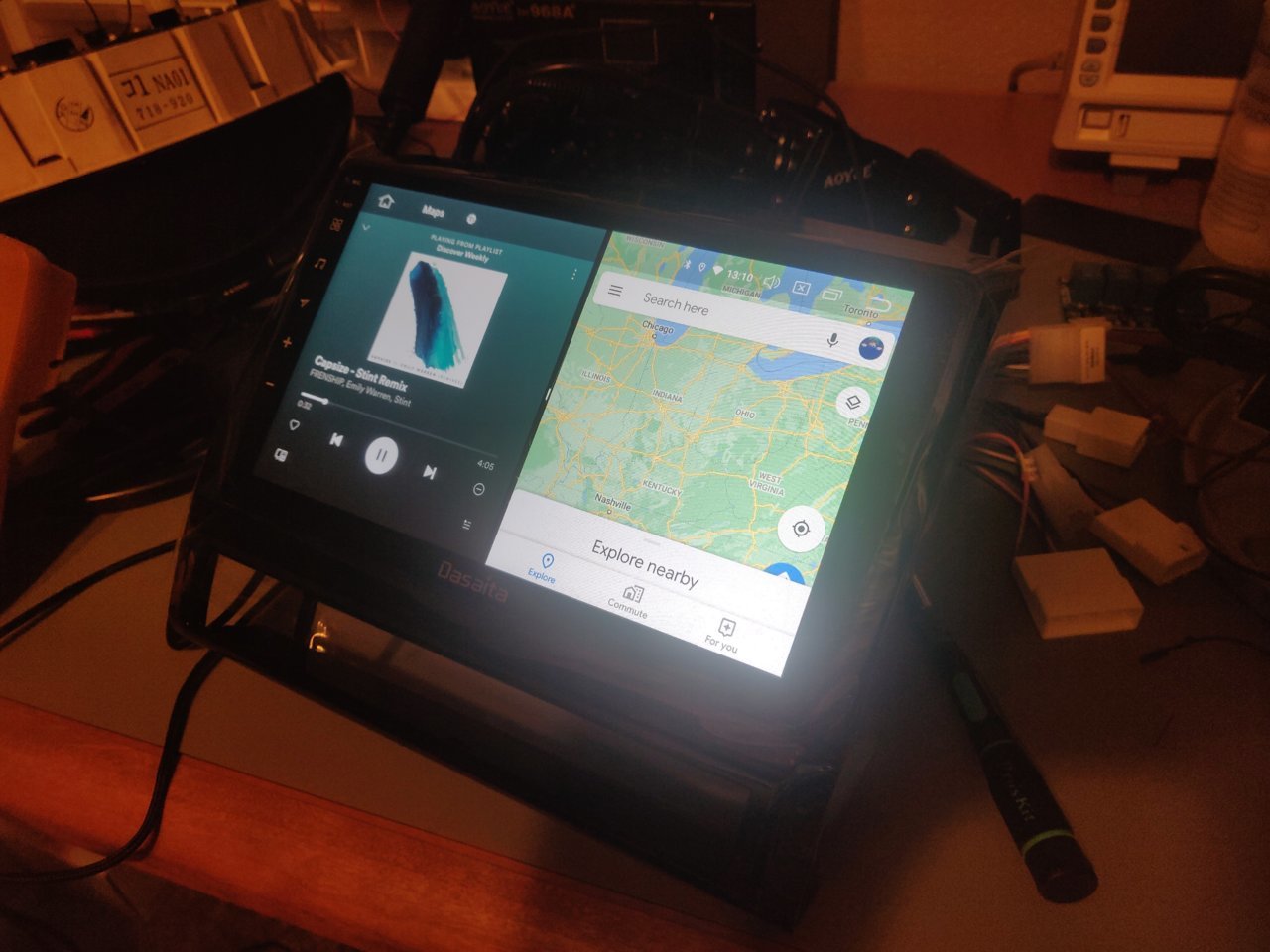

  16. May 18, 2021 at 10:21 PM
    #896
    Gadgethm
    Gadgethm Member
    Apr 12, 2021
    #362428
    7
    2014 Silver Tacoma TRD OR DCSB
    This is the unit I picked up. It actually shipped pretty quick all things considered...
    https://www.amazon.com/dp/B07Z96B5RB?ref=ppx_yo2_dt_b_product_details
    I'll post some pictures of the install as I make progress! This evening I just spent booting up the unit on the bench, rooting it, and changing out the default interface with Nova Launcher. Still need to install some icon packs and make it look better, but its already miles better than what it was haha.
    Attached some pics of it on my messy workbench.
    kingston73 and theolee like this.
