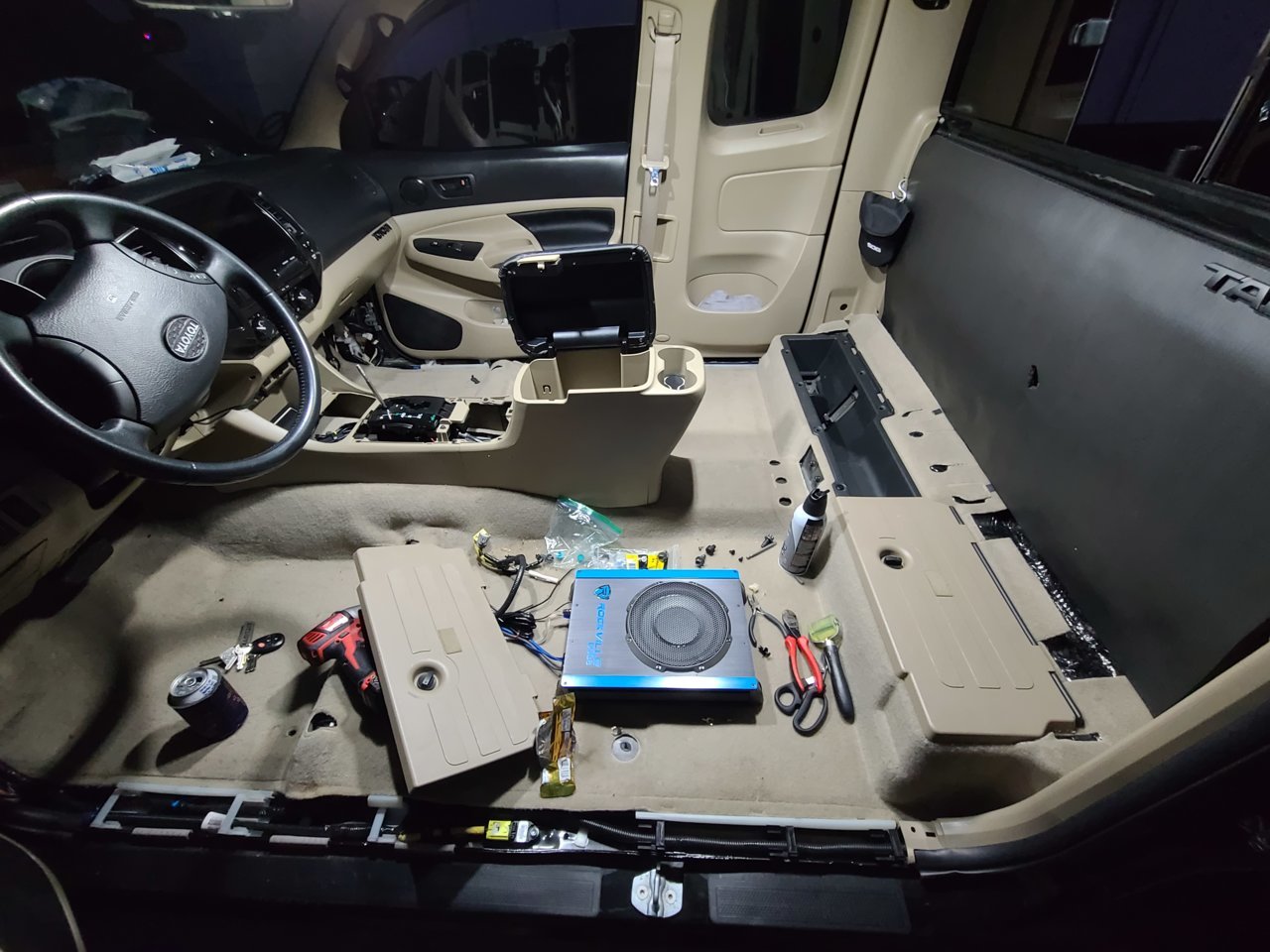

    I did what your wanting to do. It made about 70% noticable difference to the sound system. I can only imagine how hard the bass would hit if I had a regular 10" or 12" sub box sitting in the back seat. But I've moved on from setting car alarms off years ago. For me, the little under seat amp/sub is more than enough.

    That's on my future projects list. I bought a 8" LOPRO8 from SSL awhile back. It's on my workbench and taunts me every time I pull in the garage. I also bought some seat jackers in case I need extra clearance. I intend to delete the air vent that is under seat and try to locate as far forward as possible so I can preserve as much rear seat foot room as possible.
    Any tips from your install that would help me out?

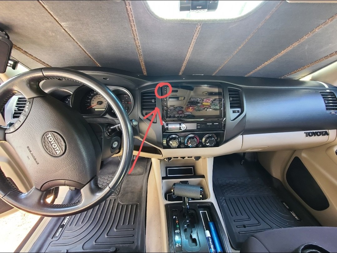

    Wait, do you mean the mic that came with the stereo when you say stock mic? Or you mean the mic that is built into the tacoma? I'm talking about the microphone built into the taco between the map lights on the roof, that one isn't plug and play with the harness I got, and it needs a 5V supply to work properly. Interesting that the one on the front of the head unit works better than toyota's microphone.

    I am curious as to whether or not the experience is the same with the factory Toyota microphone. Its entirely possible the integrated mic is still better, given that the car was made back in the earlier days of bluetooth handsfree calling. Guess we will find out!
