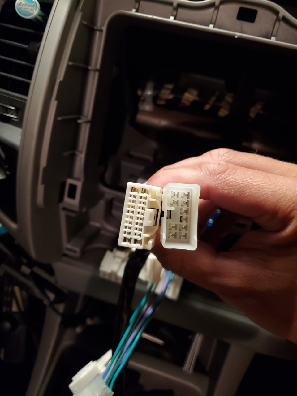

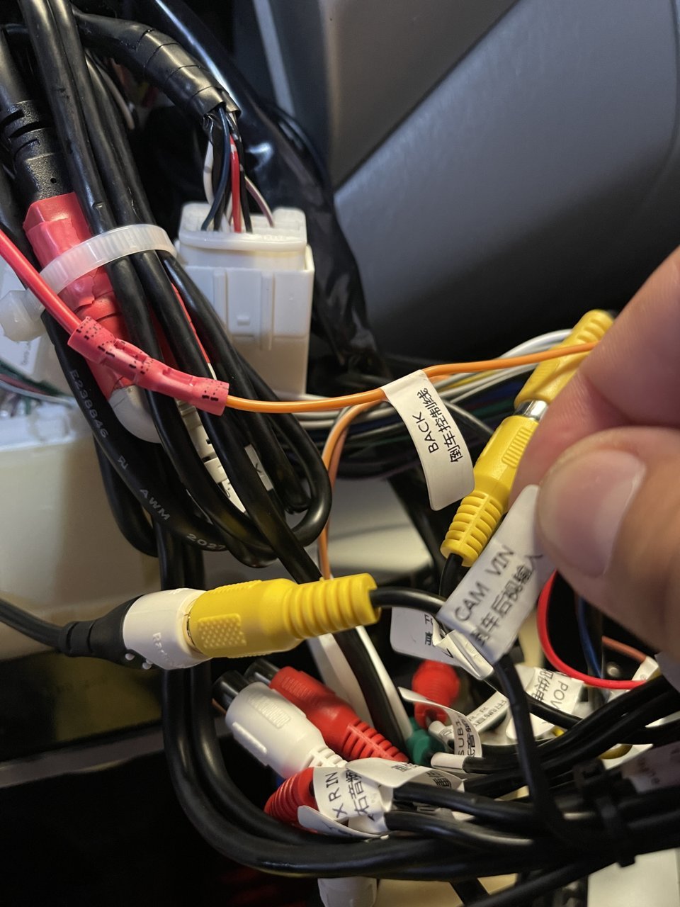

    Quick question for you gurus out there. I bought the unit pictured in the first image. But the power cable connector is not compatible with my stock cable used for the oem radio. (Second pic) I take it I need to buy an additional cable or cables. Anyone know what adapter I need or what cable to buy?

    Did you ask them if the sell the required harness?

    Yes via email today. But I know it takes a few days to hear back so figured I'd ask here as well. I just recieved the HU today and after reading this entire thread it seemed as though it would be plug-n-play but not the case with the one I recieved. Just a bummer is all but hey, it's from China so....

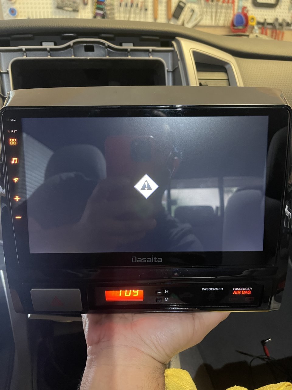

    Hey everyone,
    hoping someone has the expertise to help:
    I followed along this video to install my factory rear view mirror camera to the Dasaita head unit:
    https://youtu.be/baOHaIaxv1I
    The problem is I get the error screen pictured.
    I soldered an extension to a spare RCA, plugged the male RCA to the CAM VIN input on the back of the Dasaita. Then I ran a wire from the reverse indicator to the orange “back” wire on the Dasaita harness.
    the reverse trigger clearly works, I’m just not getting any video signal!
    Any advice?

    What year / model is your Tacoma? Do you have factory JBL? Mine was fully plug and play, so I’m curious why yours isn’t working.

    Finally got my factory rear view mirror camera to display on my Dasaita head unit. Was the last piece to the puzzle for me. Now I have everything working 100%!! If anyone needs to do this, I can talk you through it.

    That looks interesting. I was afraid the resolution in the rearview mirror display would be excessively blocky on the HU. It looks pretty good in your picture. What did you do to have it displayed in both and how difficult?

    The resolution isn’t HD by any means but it isn’t bad at all. It wasn’t difficult at all. It took a little trial and error. I will try to get a write up going ASAP, but basically I got an RCA to wire cable off Amazon and an additional stretch of 16g wire, ran that from the HU to under the dash on the driver side. There’s 2 harnesses you need to tap into. One is for the reverse trigger and one is the RCA video tap.
