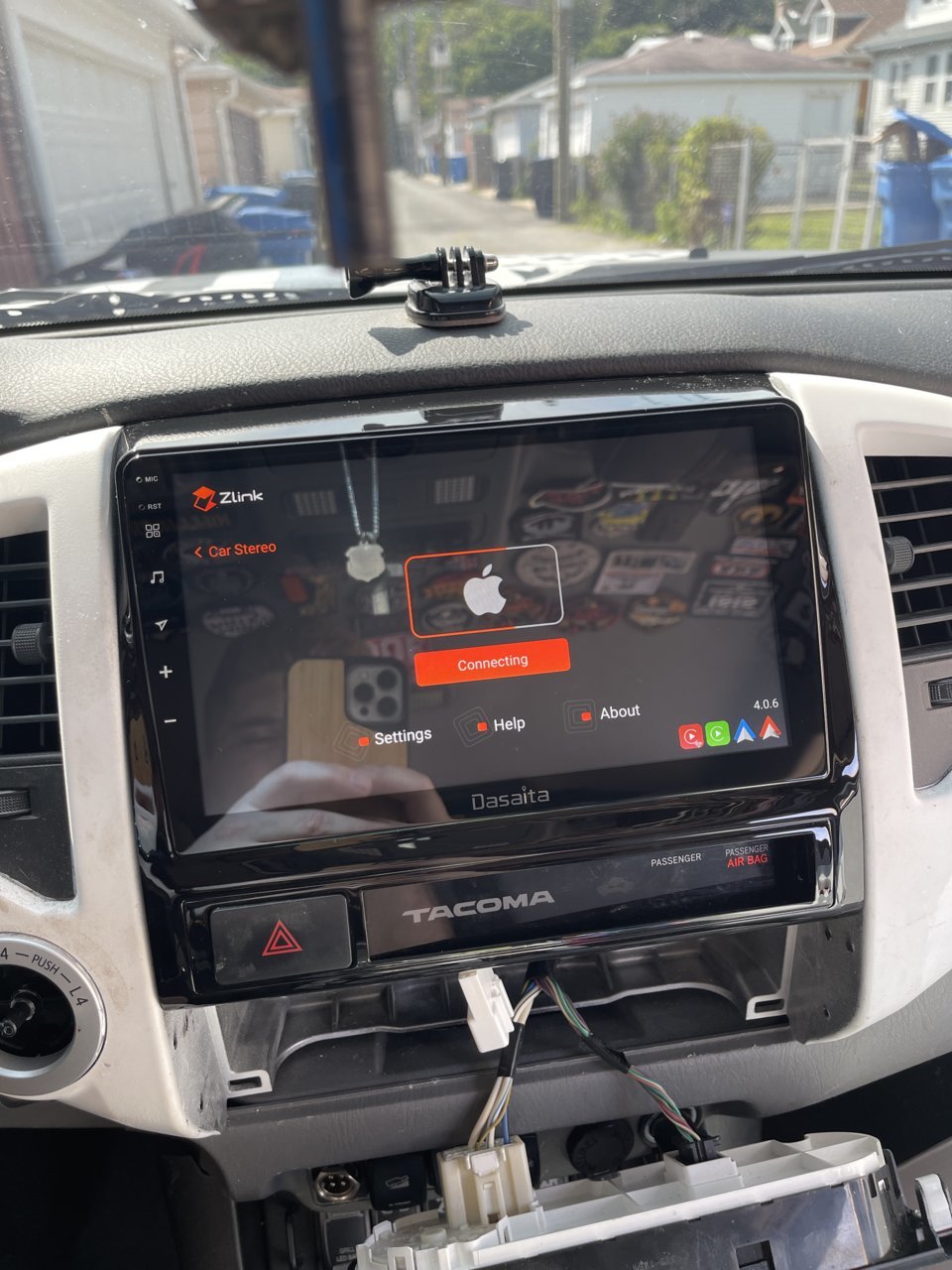

    So I ordered the new wiring harness and it did nothing. I plugged everything in and o luck. Wouldn’t even turn on. Plugged the old wiring in and it was fine. I found the antenna I was missing for Wi-Fi so I got CarPlay to work but now I have to figure out how to get my camera up. Link for what I got but I think it may be the wrong one. Emailing Dasaita
    https://www.amazon.com/dp/B08DTZXPQ3?_encoding=UTF8
    Disregard the climate control knob missing. I took it off to gain access to the radio.

    Interesting I would give it another go in case it wasn’t Connected all the way. I’m sore it was but maybe bad harness. Also not sore you even need the wife antenna. I have no idea where mine is and it broke anyway

    I tried a few times last night with no luck. i messaged dasaita on ebay last night and they replied but i was already out so i sent them more information this morning

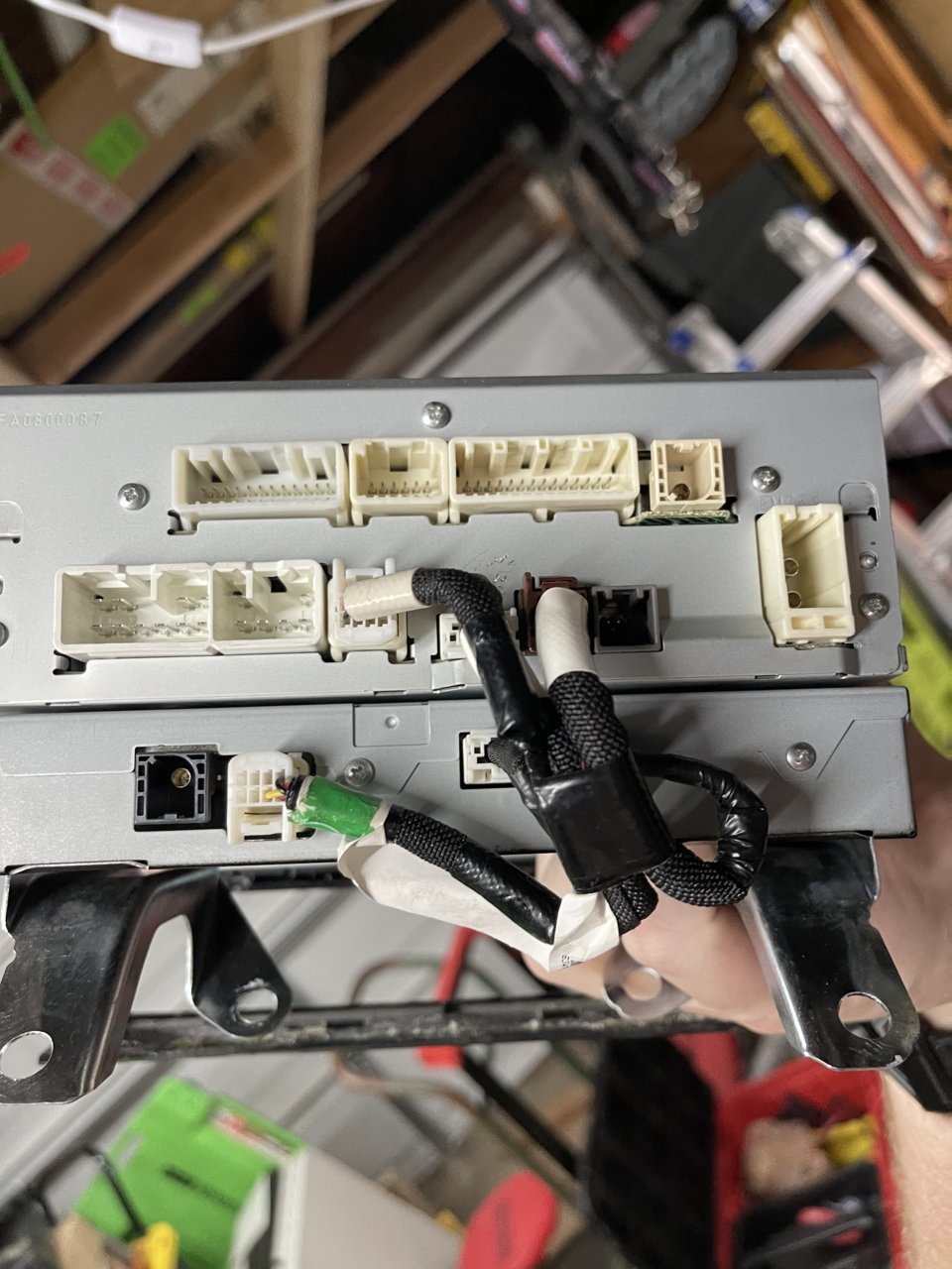

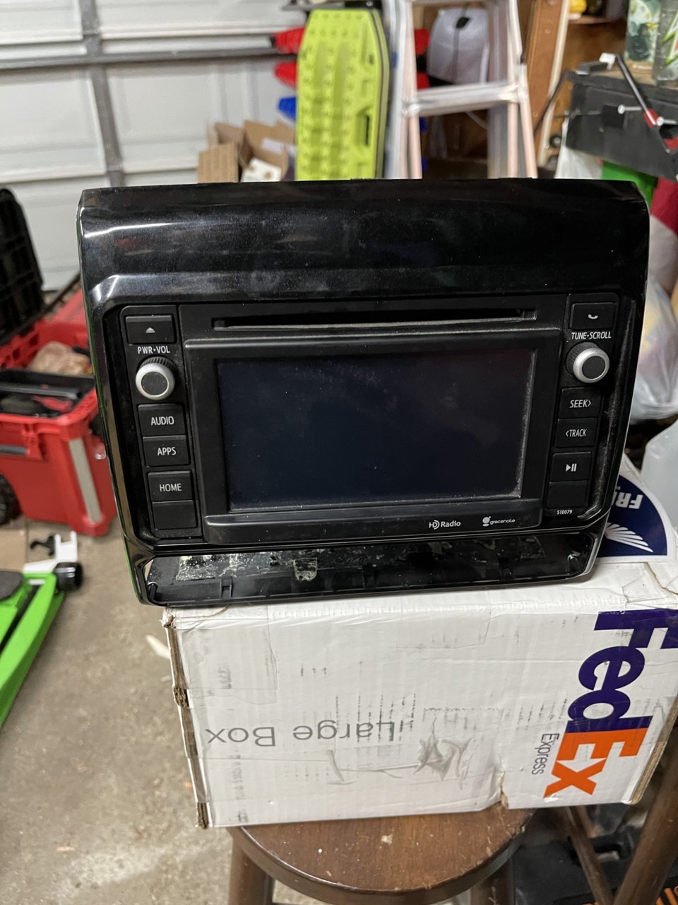

    i just pulled out the radio. I don’t have jbl on mine. This is the unit I pulled out.

    #1031
    Shadmaxx
    Shadmaxx Member
    Aug 7, 2021
    #373478
    6
    David
    Portland, Or
    2015 TRD Tacoma Blue
    Alpharex Luxx Headlights, rear backup camera upgrade to 600 tvl, Atoto Android Stereo, Alla Lighting H11 duel LED amber and white.
    Yes, you have the exact one as me!
