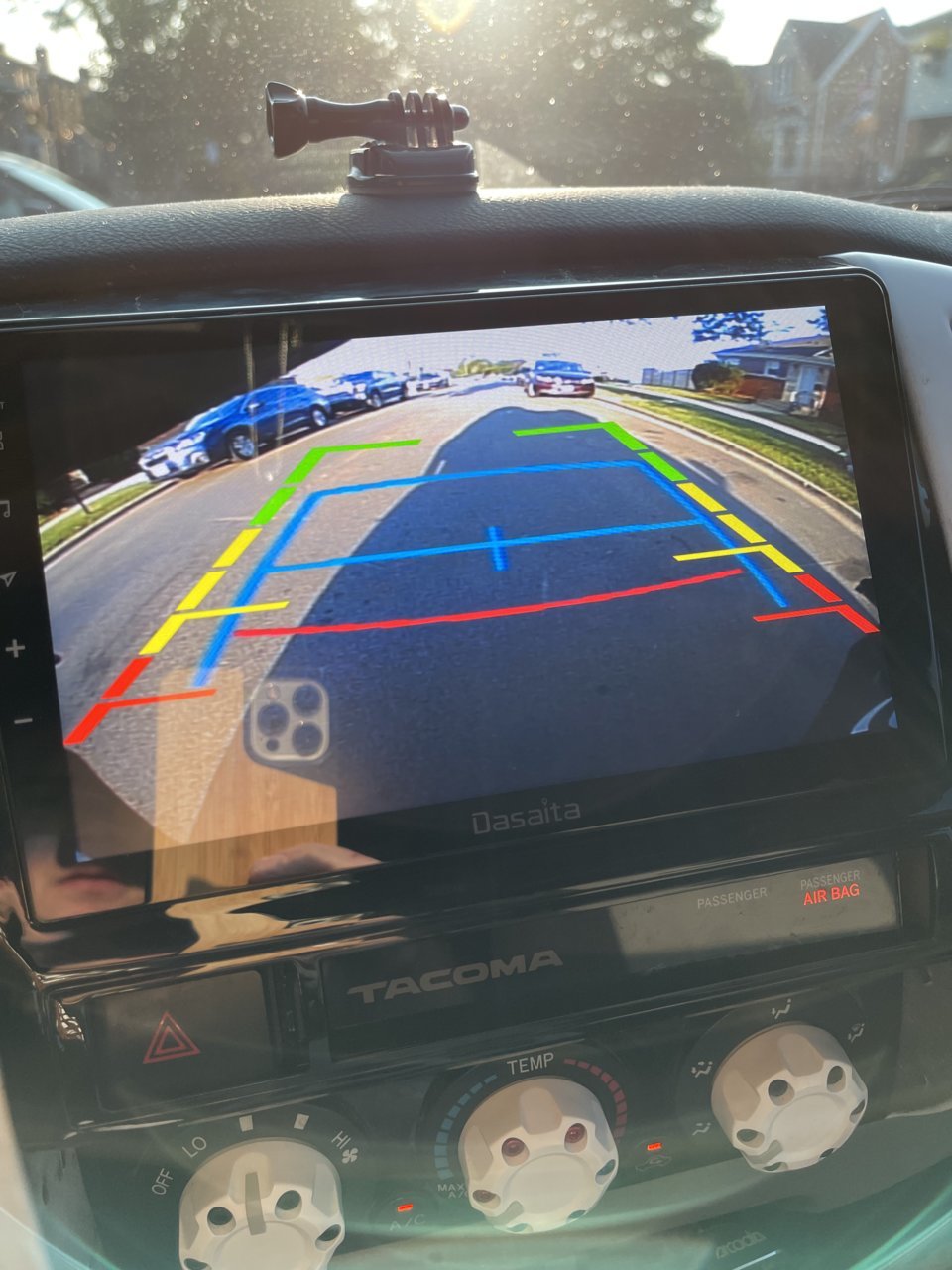

    So I FINALLY got the correct harness and everything is working. I have to double check the buttons and figure out why CarPlay won’t let me set it up. I also was able to grab an older head unit on eBay for $18 and that includes shipping and tax. Thank you eBay auctions.
    EDIT: Everything is working perfectly. Had to reverse the mirror display because it originally came up backwards

    How were you able to get the Apple CarPlay to work? Did you need to purchase a CarPlay dongle? I’m struggling to get it going on my unit. Also did that harness allow you to run your factory backup camera?

    it connected once I had it all hooked up and yes it allowed for it. Make sure you go into settings and setup your canbus

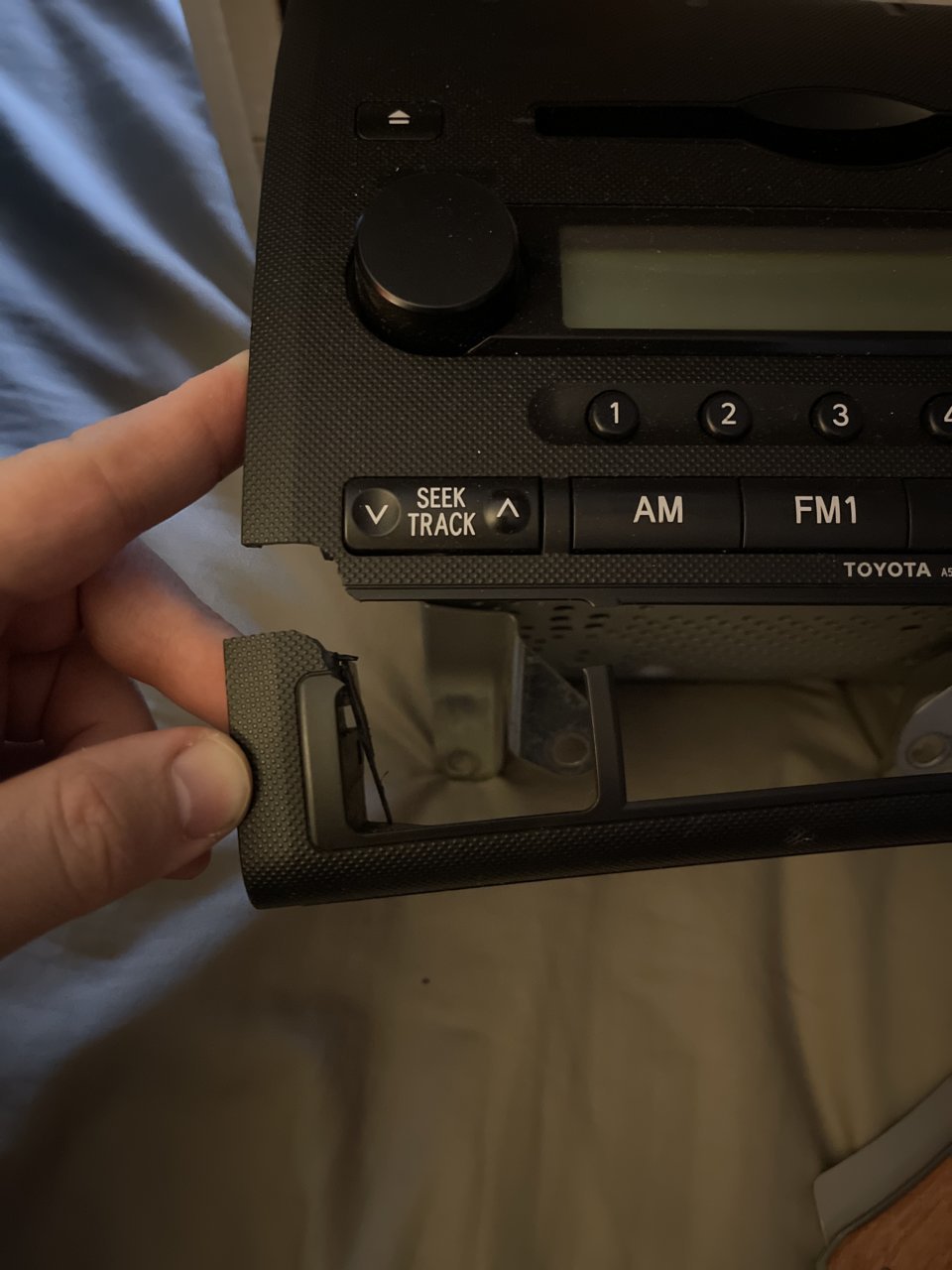

    So I got the radio early but I’m less than happy. I paid under $20 but it arrived damaged in the one area I needed

    I messaged the seller telling him it arrived damaged and his response was "okay"
    5 minutes later i got a full refund so
    Now its time to take it apart and see if i still cant use it to at least hold the hazards in place because I was looking at replacements last night and they want 5 times what i paid.

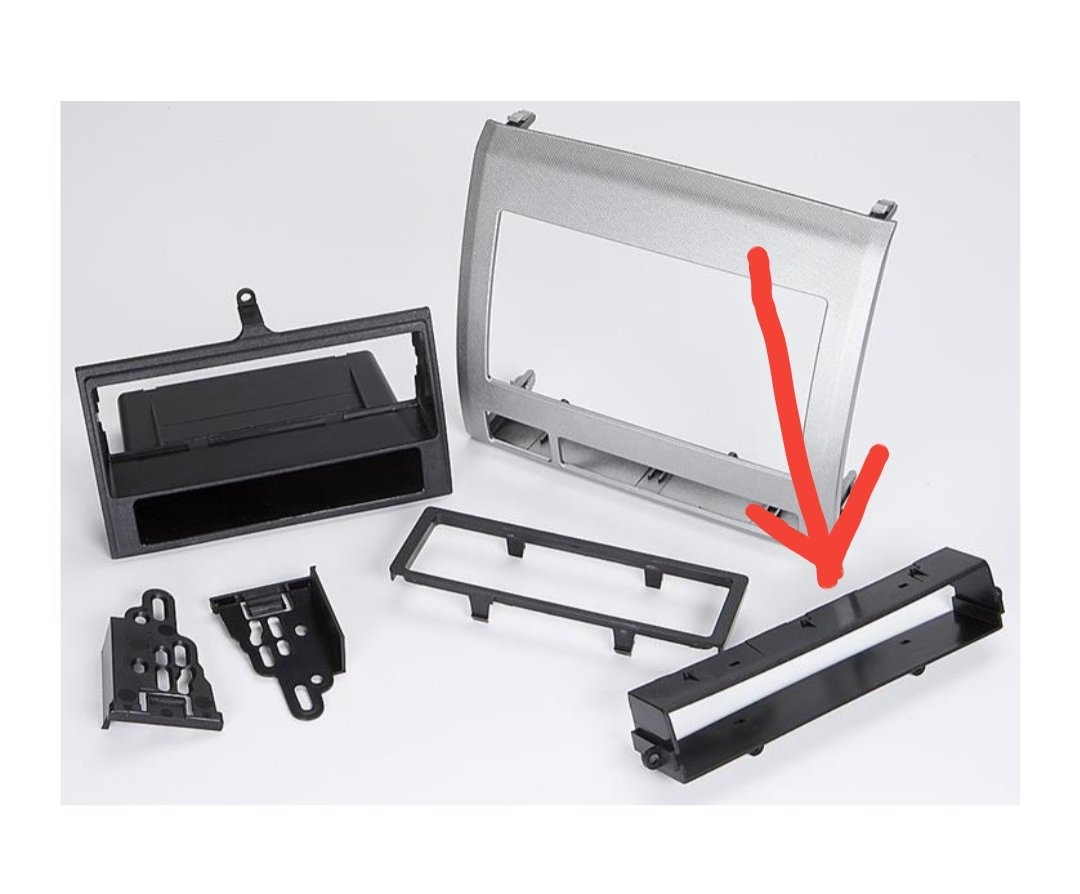

    The hazard bracket you need looks like it's missing in this shot.

    Like @ZColorado said. It looks like the piece you needed wasn't even included ....

    It fell out when i pulled it out of the box. its broken bc they didnt package it well so it crunched it like potato chips. And i appreciate you keeping an eye out. I just need the piece not the unit.

    That won’t work. Unless it’s a diff version. That was the first thing I tried. Ended up picking up an eBay shell. Also came busted but what I needed was there. Funny it wasn’t even a full radio just the face of it but luckily it had what I needed. Even then it’s not perfect but did the trick.
