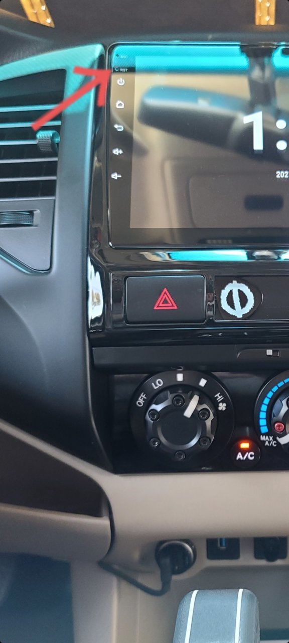

    Anyone in cold climate experience it shutting off and restarting? It mine worked fine yesterday but it keeps restarting after being on for 30-60 seconds.

    Yea it'll do it once then be good, and not everyday

    Ok. It’s been doing it all day today when I get in my truck. 30 min drive to and from work. So idk what’s up with it. Hopefully it’ll be fine tomorrow but if not I’ll have to reach out to iris. Anyone have a contact for her?

    Mine did that awhile back and froze a couple times. I used the restart button and it worked for me.

    Yea, i reset it this morning and on the drive to work it was fine so im about to leave and we shall see

    Damn never realized that's what it is!
