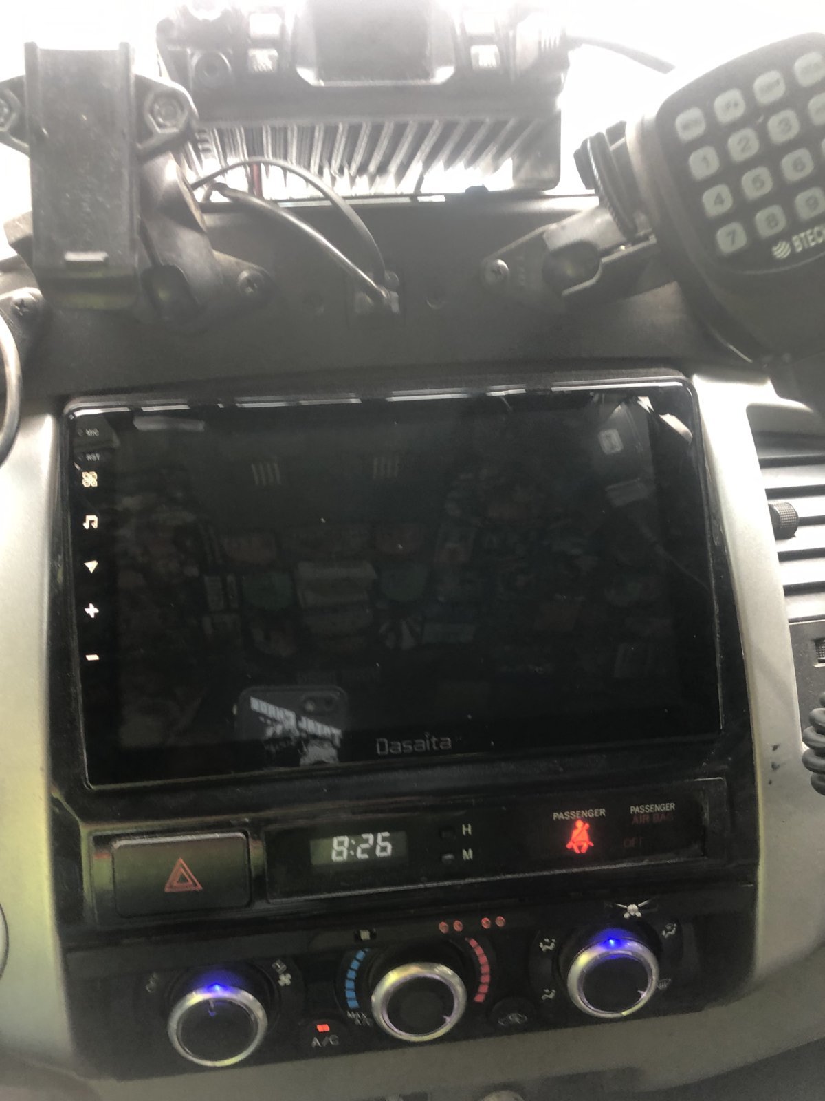

    IMG_7749.jpg IMG_7749.jpg Anyone get a black screen of death? It made a pop sound then tried to reboot. It took a long time. It connected to Car Play. Nothing actually worked or at least the touch screen didn’t. I got to work and turned off the truck. When I turned the truck back in my screen is black.

    I have now checked all my fuses and the are good. I unplugged everything from the back of the unit and let it sit for 10 minutes while I was checking and still black screen. What is the RST button?

    Tried the RST button and nothing. The back lights on the left side were turning on with the headlights now they stopped working.

    Bummer! Hold the reset button in for like 6 seconds. Then the buttons on left should flicker and the CPU should reboot. Careful when you do it, I finally cracked mine screen while I was driving lol.... Bone headed move and super lame.
    I hope your screen didn't burnout..
    There's also a fuse on the back, did you check it?

    I checked it. Googled up Dasitai black screen and tried everything. Finally took it apart and unplugged everything and plugged it back in. I’m talking the ribbon wiring in the unit. Put it all back together turned on my key and it fired right up and connected to my phone. I put pandora on and my phone was buffering. When I went back to touch the screen it wasn’t responsive and about 5 seconds later went black again:frusty: I thought I had it fixed. I’m going to eat dinner with the battery undone and see if I can get it to work again and try to get into the screen brightness and turn it way down. It’s not super bright but I had a problem before with the screen brightness. Who knows. It’s about to get a cracked screen too:smash:

    Well it kinda worked. Made it into settings and it was maxed out brightness. Turned it all the way down about 3 minutes later black screen of death. I’m over trying to fix it and will order another one.
