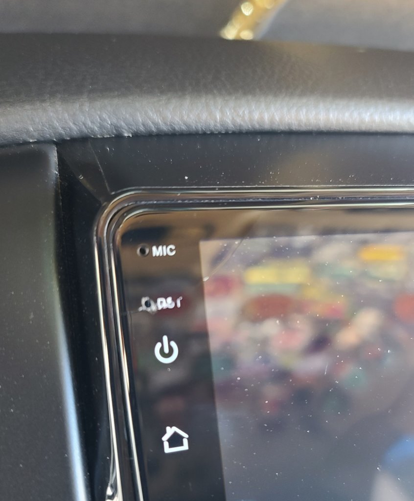

    Has anyone seen any mandatory updates? It's been quite awhile since I updated this thing :smash:

    Don't drive and RST :facepalm:

    That thing is hard to
    hold for 8 seconds not driving.

    Seriously. Oh well, could of been worse.

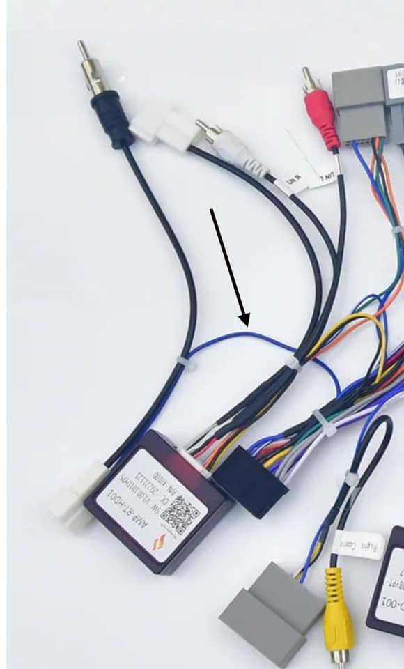

    Something I hadn’t thought of…
    Who here has this unit with a remote amp?
    I don’t see a specific wire labeled for an amplifier remote turn on (usually blue and white).
    I do see a probable solid blue antenna power wire, of which I could use. I don’t have any am/fm antennas left in my truck anyhow.

    id have to look at my old one. Manual does not have any info? I was chatting with the Dasaita folks at SEMA this year. They have a small amp they are going to start selling as well so there def is a remote turn on wire back there.
    Ive been debating upgrading to the one you just picked up @Sterling_vH111 Looks great when I saw it and my OG T9 Dasaita starting to show its age.
    Is there a blue wire that says amp, may have a rubber cap over the end of it? May be on one of the different connectors that may not be needed or try the antenna wire. You can tap into this. I have seen this one referenced a bunch.

    That blue is exactly what I just tapped into. Works. Good enough for me.
