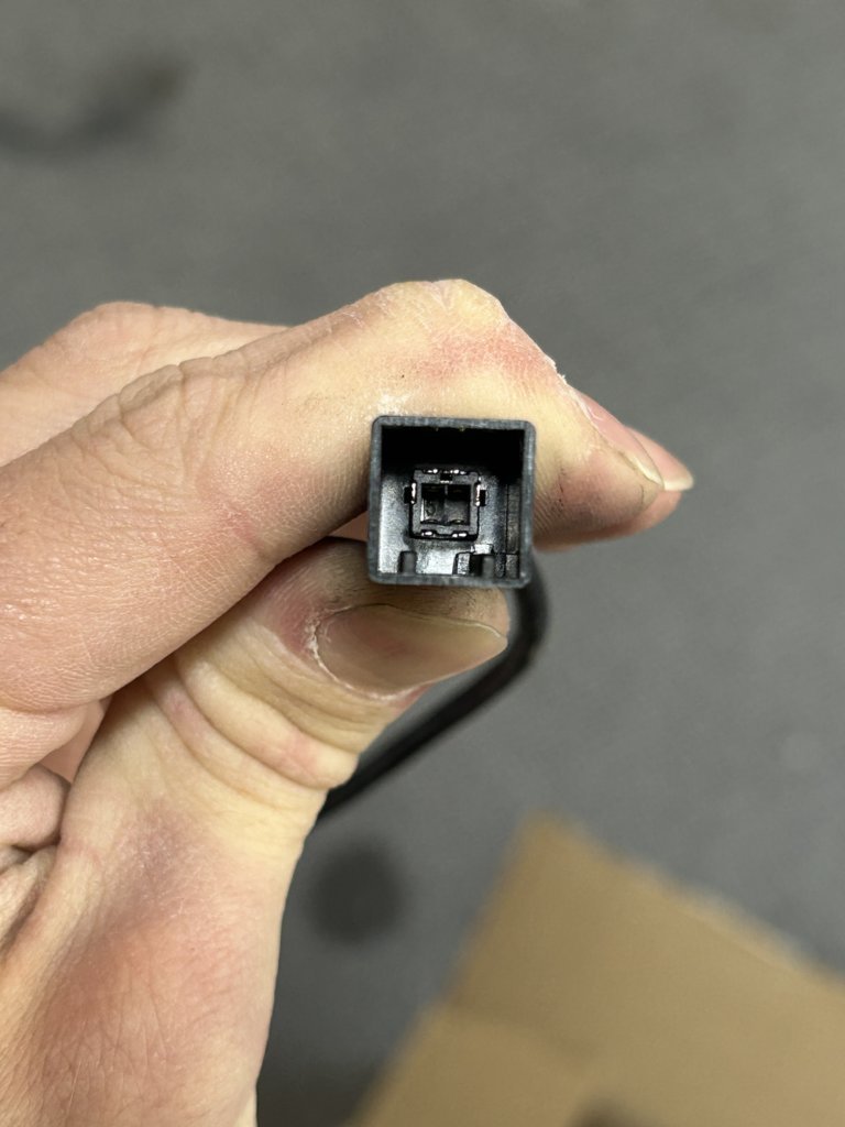

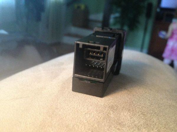

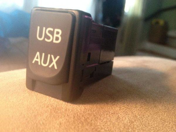

    In case you still needed help, for my 2012 base radio I got it working with my joying. There is a short adapter needed I believe I bought the scoshe brand called Toyota factory usb adapter, the kicker is it plugs into the USB plug at the multimedia ECU behind the glove box, and the adapter is so short you end up needing another USB extension cable to go from the adapter behind the dash to the back of the radio.
    Looking at upgrading to the 10 inch G13 or the Mekede DUDU7 11 inch and buying the dash adapter separate, but the prices are hard to justify when I already have a working Joying.

    Thank you, I shall try and get this and the OEM port. I somehow have thrown mine away after the years.
    So the oem plug on the lower dash below the AC stays plugged into a factory harness, and the adapter plugs in further up the harness behind the glove box? Then from adapter to new radio.
    I have a decently long female usb on it right now just dangling through the open port below the AC controls.

    Yes the factory usb wiring does not go up to the radio, it stops at the multimedia ECU, you unplug it from the ECU and just use the harness side, the ECU is no longer needed.
