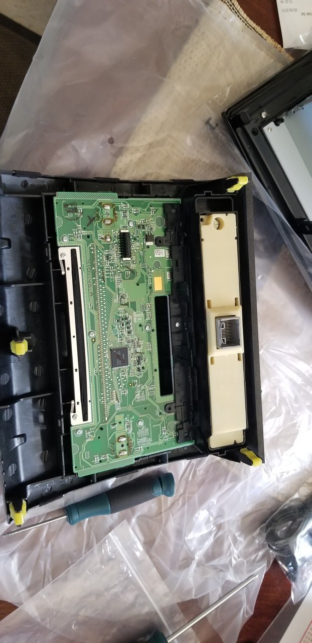

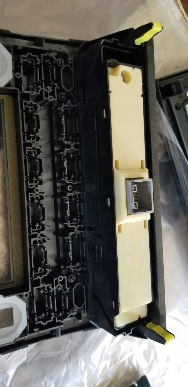

    Aug. 24-30th

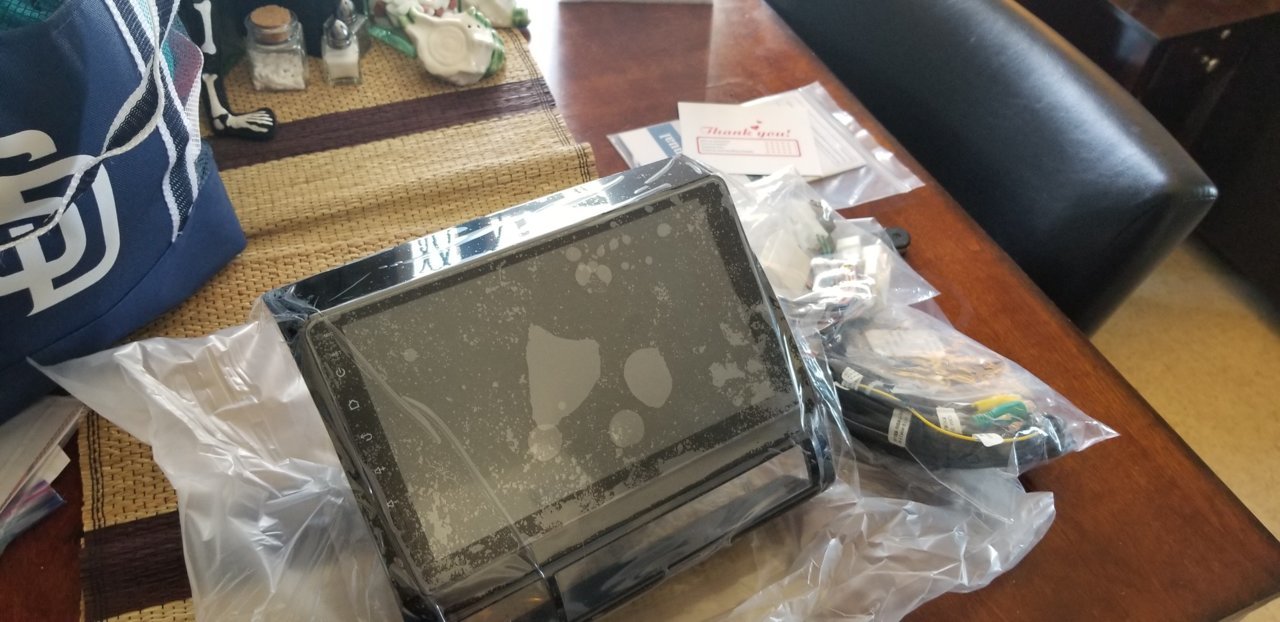

    Just ordered my Dasaita Android 9.0 yesterday. I went back and forth with "Iris" from Dasaita on price for a couple days. Started out at $478 and talked them down to $430. My offer did expire before I had the chance to purchase the unit. So I went ahead and called eBay to sort things out. I ended up purchasing for $450 and credited $20 promptly. Days before I made the purchase, I stopped by a local stereo shop and asked their opinion and they were impressed with it. They also told me there would be no way they could match that price and that I should go for it.
    Sept. 1st
    Received a message from Dasaita tonight. They wanted to address any fitment issues before they sent it out apparently. They asked for my make and model, a picture of my stock stereo and if I'm running a factory amplifier. The language barrier is kind of rough and the response time seems to be about 24hours.
    Sept. 2nd
    Update: received a quick response. "Iris" promised that everything should fit fine. (We'll see) 1-10 business days. Will update when it arrives and take photos of installation.
    Sept. 8th
    Expected delivery Monday
    Sept. 9th
    Arrived, going to try and get it in there ASAP
    Sept. 10th
    Out of the box and ready to roll

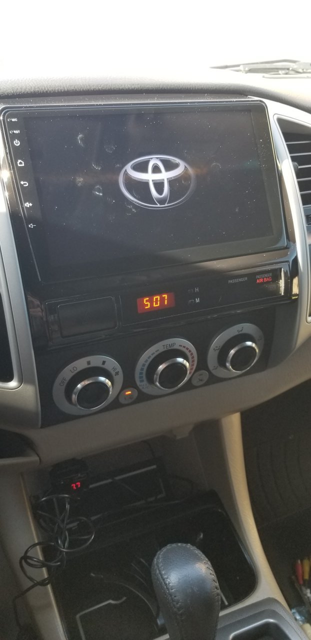

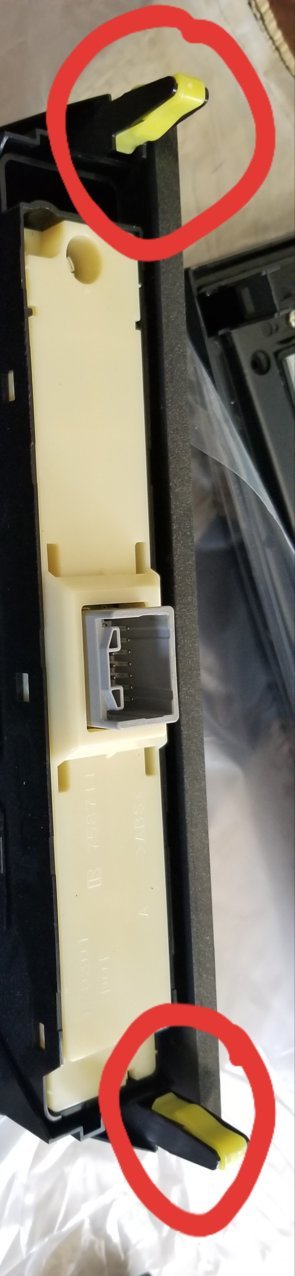

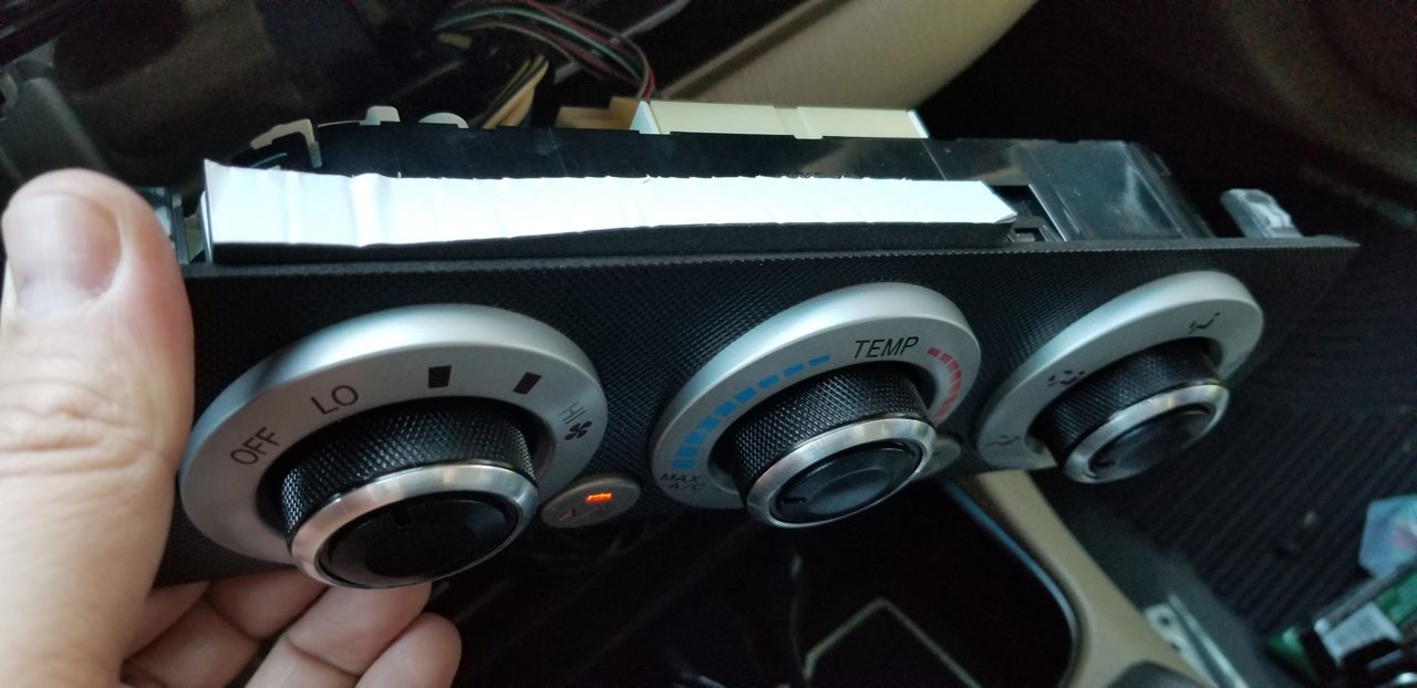

    Just a few things I want to note. The uninstall of the factory stereo was a breeze untill it came down to extracting the hazard/clock. I literally had to take the stereo apart to avoid from breaking it.
    After figuring that out, I came to a point where I think some are having fitment issues with the hazard/clock. Everything clipped in snug but the screw holes did not line up. I just put the larger left over screws from the factory unit in and it securely tightened up. Moving on...
    While I had everything apart I went ahead and painted the hazard light button along with the back part of the climate control panel.

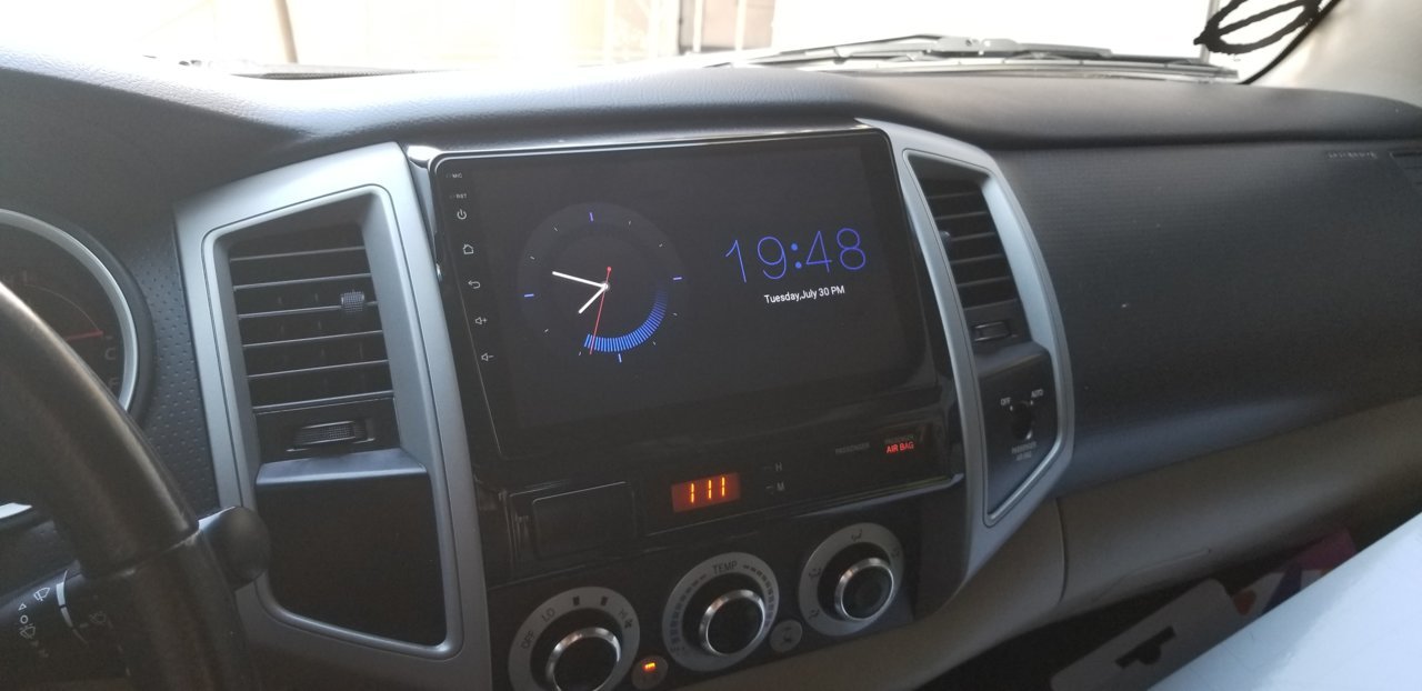

    The process of actually mounting the unit was simple but I did notice that the unit had a bit of a wiggle to it. So I had some left over double sided gaskets from another project. I lined the CC panel and both sides of the air vents. After that, fit snug and secure.

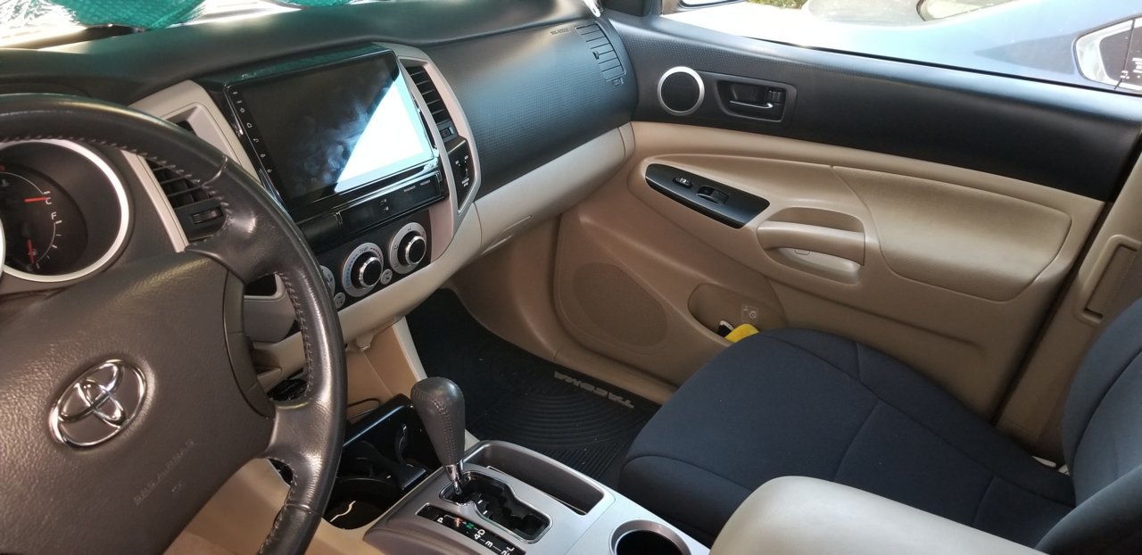

    Wires were plug and play as advertised. Very simple but don't forget to transfer over these yellow clips before install.
    Sounds great, looks great, runs great. Im super happy with it. All around a good experience. Would totally recommend it.
