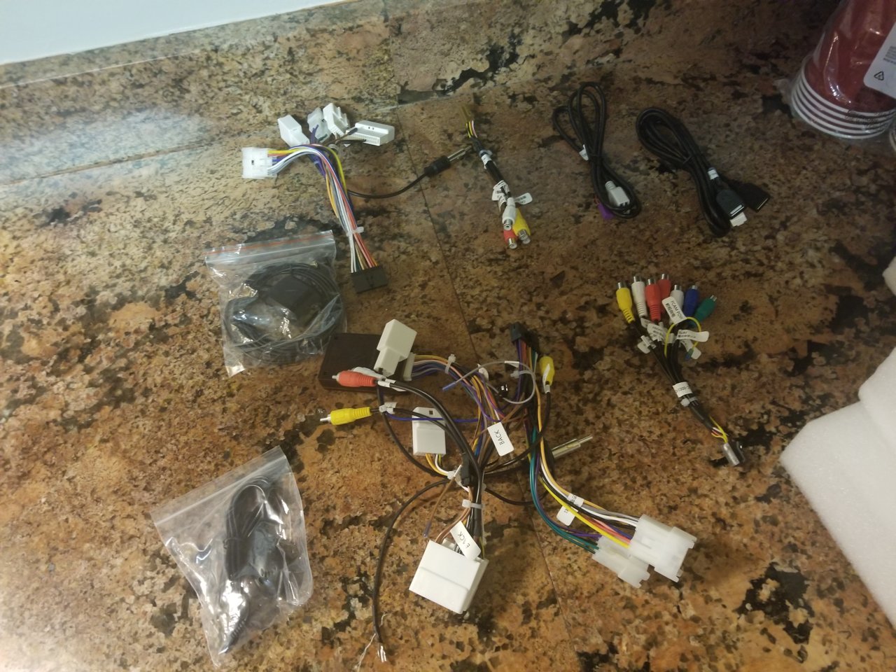

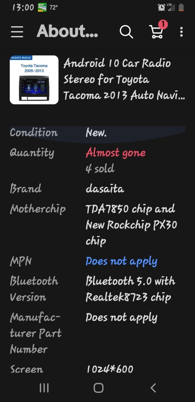

    I was sent two wiring harness , so we used the JBL harness. I'm not really sure but its allowing my sub to turn on. Could this be from using the wrong harness? Also the steering wheel will not program and the camera doesn't work. When I bought the Head unit it said it also had a DSP/HDMI video output which I don't see. Also does anyone have the direction to install the radio?

    Which headunit did you buy exactly? do you have a link to where you purchased it?

    Which headunit did you buy exactly? do you have a link to where you purchased it? Look at this on eBay https://www.ebay.com/itm/184612185615

    Ok I went and rewired it with a friend that has a strong audio background. Now my camera works thanks to the Seicane 12v to 6v part.
    www.seicane.com%2Ftoyota-backup-rearview-camera-adapter-sc71
    got my subs working but just don't sound right so we looked got the DSP can't find it .
    What is it that I'm supposed to have when it says DSP in the Head unit description? Is it an App ?
    As for the steering wheel app on the device to program the steering wheel controls .It still does nothing as if it's all greyed out. I press all around on it with no response from screen or buttons on the truck. Does anyone have pictures of the exact connection for the wires just so I know everything is hooked up right ?
