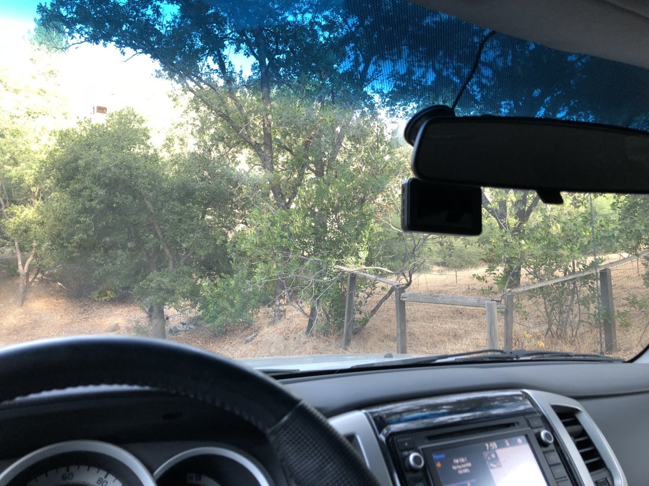

    You shouldn’t have any issues hiding the wire if you’re running it from the fuse panel or cigarette lighter

    48CDD959-0235-4D85-8DD9-F33AFBD329D5.jpg My dash cam is plugged into the cigarette lighter not hardwired and this is the only part of the wire to the camera that you can see

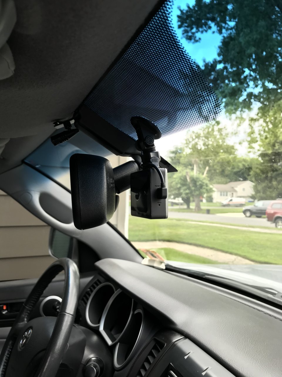

    I hard wired my cam up to the lights where the temperature is theres two 12 volt power sources in there both come on with key . But one goes off when you put your lights on. I bought one of those cigarette sockets and tucked all the wires in the headlinerEFBDB119-E7EB-4787-9734-91261001F1ED.jpg
