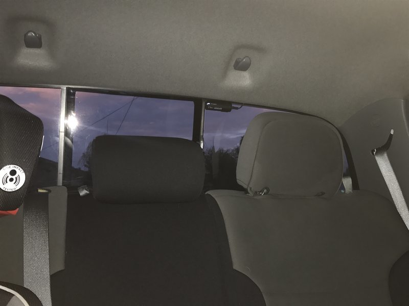

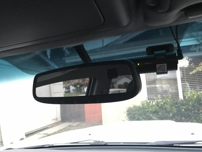

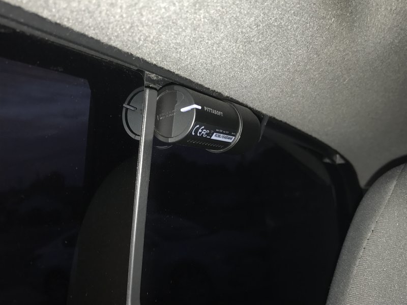

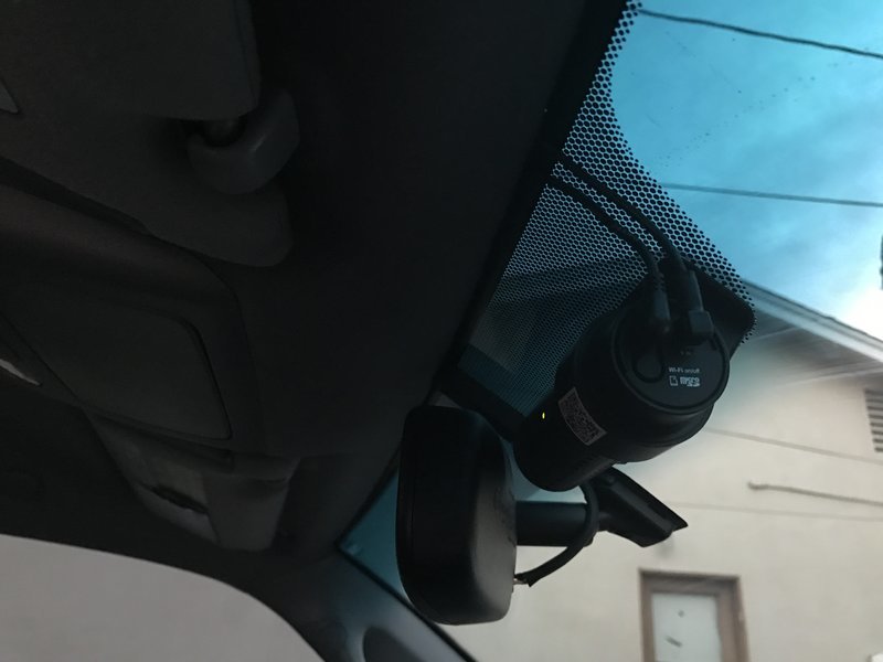

    So the the wires are tucked away underneath the headliner and weather seals. I ran a wire to the driver side and down the pillar to the cell link b underneath my driverside seat ( the cell link b is hardwired to a fuse) and one towards the passenger side all the way back to the rear window. The only wire you will see is the two coming down from the liner into the dashcam.
