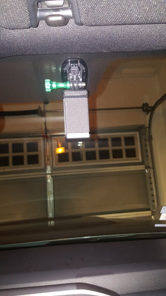

    I use a Mobius on mine.
    Discussed in this thread:
    https://www.tacomaworld.com/threads/dash-camera-choices.415173/page-7#post-13875733
    I decided to reuse my Mobius from my subaru:
    [​IMG]https://www.amazon.com/Mobius-Action-Camera-1080P-Sports/dp/B00DP1WYD2
    It attaches to the gopro mount with:
    clip - [​IMG]https://www.amazon.com/gp/product/B00FZMIJBU
    custom thumb screw - [​IMG]https://www.amazon.com/gp/product/B00IE3JDSU
    3D printed adapter - http://www.thingiverse.com/thing:538670
    I bought an 12v to 5v converter from Amazon that I pulled the ceiling panel out and velcroed/double sided tape to the ceiling of the truck:
    [​IMG]https://www.amazon.com/gp/product/B00O6R9PCC
    I ran a dedicated power line through the headliner (fish tape) then inside the pillar panel (easy remove with two bolts, zip tied to existing wiring out of the way) then fish taped down to the kick plate. From here it runs through a grommet in the firewall to the engine compartment an is then wired to a relayed fuse in my custom fuse box. It has 5v3A of power when the truck is on.
    I could totally take pictures one of these days, but I'm not opening up the panels again.
