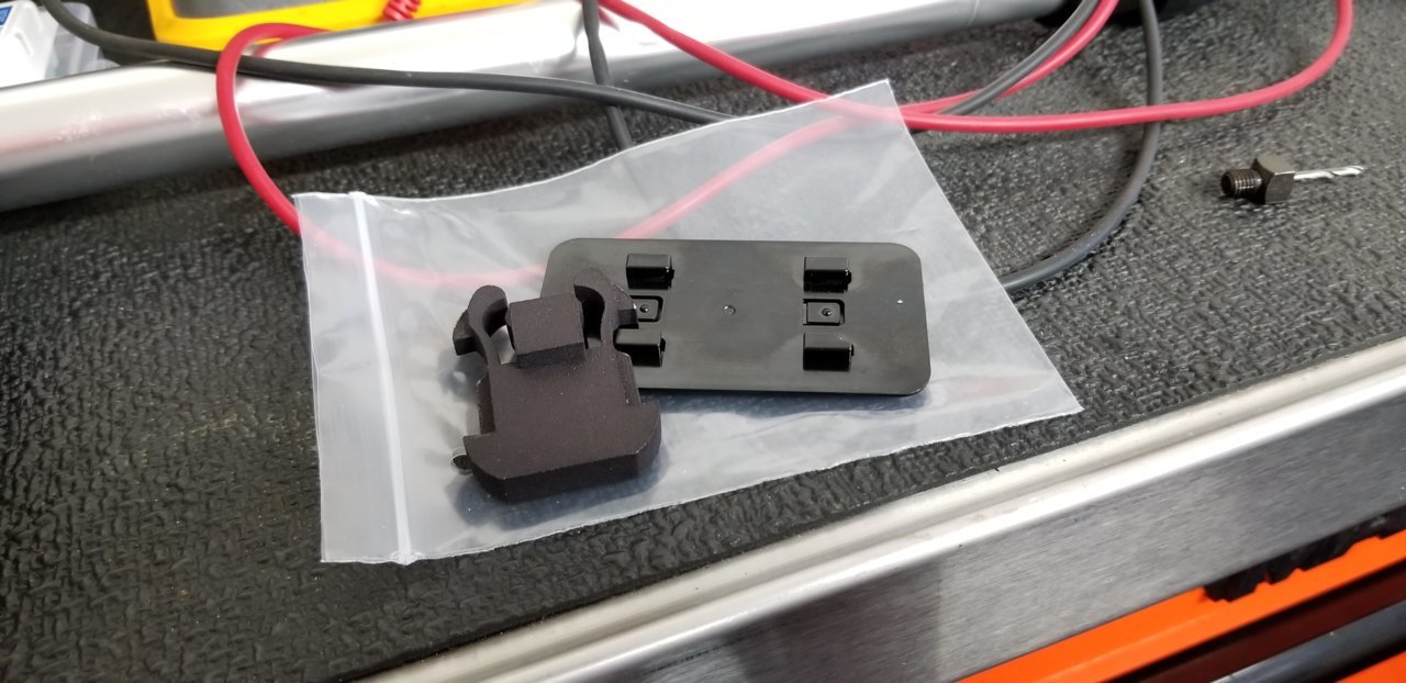

    I used a Rexing V1 Car Dash Cam, Go Pro mount, a Dremel tool, and Gorilla glue to bring it all together. Worked out great, and is a clean and simple install.

    Is this the exact mount that you used? TIA.
    https://www.shapeways.com/product/PJSDBHAWB/gopro-clip-to-rexing-dashcam-mount-best-way
  6. Feb 24, 2019 at 3:44 PM
    #106
    porterx
    porterx Well-Known Member
    Dec 3, 2018
    #274643
    388
    Just trying to wrap my head around this. Is the bigger rectangular piece the part that comes with and is the F800 mount and the buckle gopro piece is the Rexing to gopro adapter that comes from Shapeways? So you'd remove the tab from the Rexing adapter to flatten it out so it'll fit into the builtin gopro mount on the Tacoma and you glue and/or attach the 2 piecies together to make one piece? I think i got it but i just want to make sure since I don't have an F800 but am looking at getting the F800 Pro. Then I'm told Thinkware is coming out with a 2K version soon. Hopefully it'll have the same form factor. TIA?

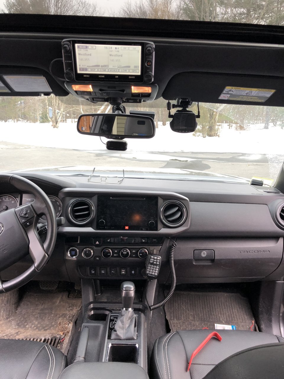

    My front/back dash cam in go pro mount. Details in build thread.

    yes you have it. actually I didn't do it because after further research the TSS camera housing was going to be in the view of the camera no matter how I placed the F800 on the gopro mount. ive got to do a little more R&D probably make a small plate with a joggle in it that will put the f800 lens right on the windshield.

    because of the F800 field of view. If you use the shapeways mount into the existing gopro mount the F800 sits about 3/8 of an inch from the windshield and allows the TSS housing to be seen in the left. you dont get a clean view

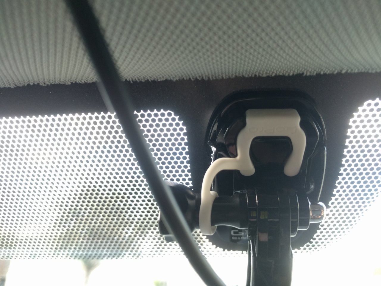

    I had to add the white go pro piece into the mount to keep it stable but it works well. The arm is a motorcycle helmet mount. Dashcam is the Z-EDGE Z4.
