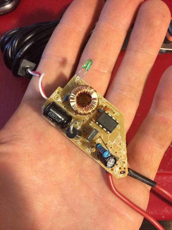

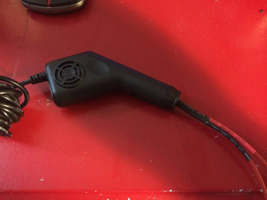

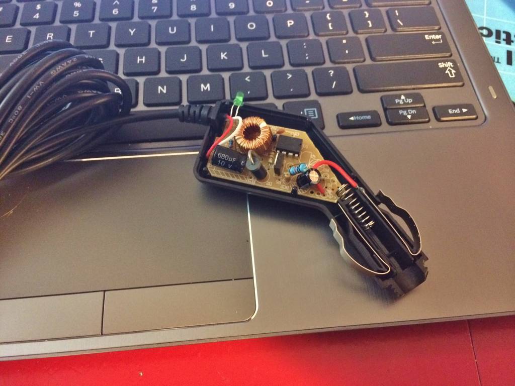

    I'd just run it down the a-pillar. the pillar cover comes off with 2 screws, and it's very easy to tuck the wire up inside the headliner as it goes towards the rear view. my camera operates off of the same voltages as yours. if you run down the a-pillar, there is a ton of empty space behind the dash panel, right next to the left-hand AC vent. perfect place to stash the 12v > 5v converter. you can then tie into the IG-1 fuse slot by the coin holder. that way, as soon as you turn the key, the camera records, and when you take the key out, it shuts down.
    I just cracked upen the 12v adaptor that came with the camera and soldered in leads for hard wiring.

    Well that answers a lot of my questions, will pull console one more time and check for those hidden wires and if they are not usable will power it like Collin did his. Thanks for the pics. Appreciate all the help.
