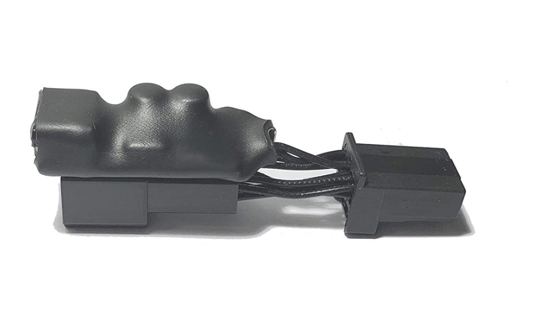

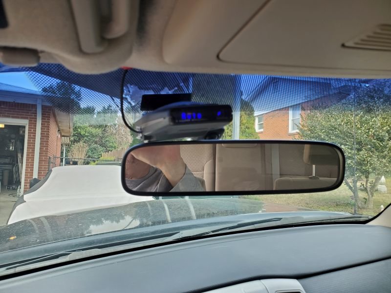

    I have an Escort Passport 9500i mounted in my 2006 Prerunner. Gettin power from the overhead console. Easy to set it up! Go to
    https://blendmount.com/
    to get the radar mount kit and the wire connection to the overhead power. They even have Dash Cam parts too. I have same setup in my 2K Corvette (OO) and 2013 LaCrosse.
      File size:
      82.9 KB
      Views:
      105

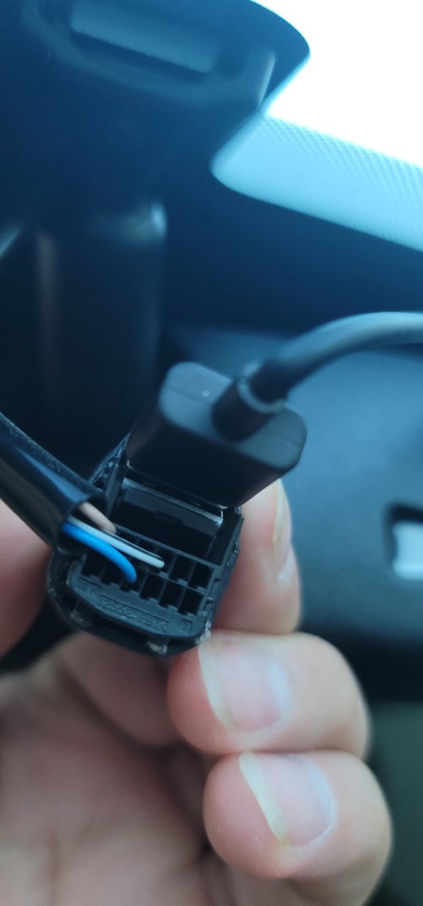

    So I have previously purchased the USB adapter and I have installed behind the mirror. (See attachment)
    It powers my dash cam.

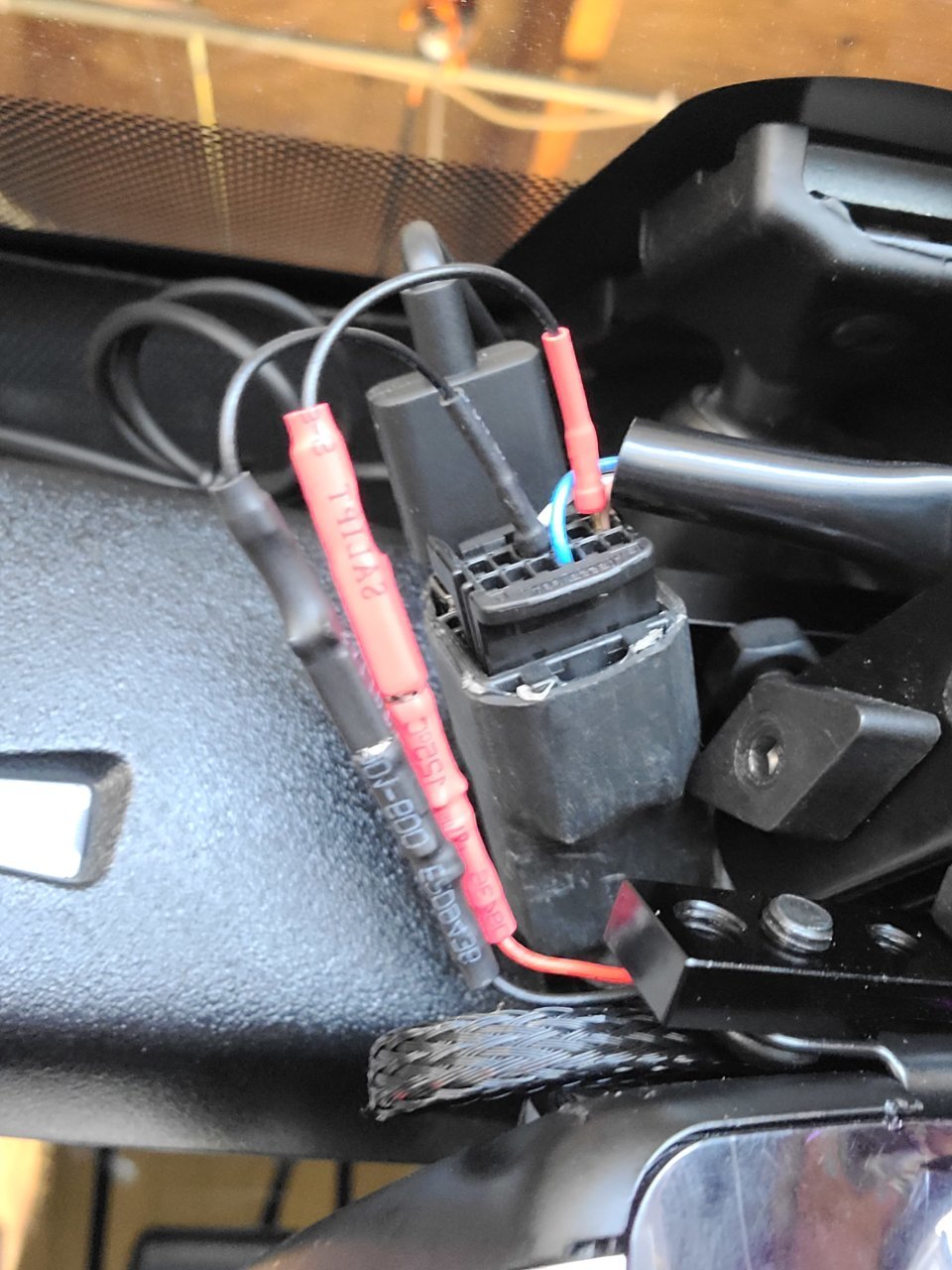

    I am now trying to power my Escort Max II radar detector with a kit.
    (https://www.amazon.com/dp/B00UE35ZP8/ref=cm_sw_r_cp_apa_fabc_YMBBJE2H5QKT02TSZ8XH?_encoding=UTF8)
    I bought it on Amazon its goes from RJ9 (telephone jack) to Two-pins.
    Does anyone know the wiring diagram behind the mirror for 12v and ground?
    I need to insert the probes for power.
    I have attached some pictures too.
    Thanks in advance
    Screenshot_20210321-190218_Amazon Shopping.jpg 20210321_190931.jpg 20210321_190948.jpg

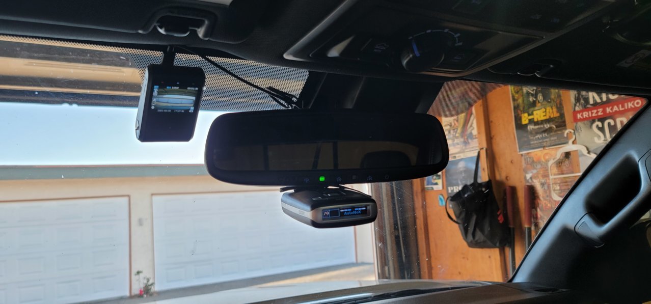

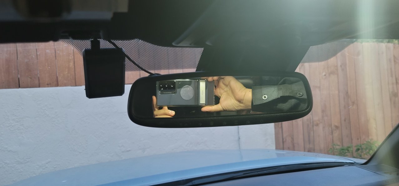

    Update
    See pics below for Dash cam and Radar detector power.20210322_172745.jpg 20210322_172731.jpg
