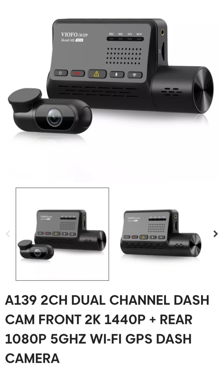

    So I've had it with my current set up. I tried everything. So I settled with Viofo A139, it has everything I want and need for a decent price and I was also able to find a promo code.
    Thanks to @Bannerman for recommending this brand. :thumbsup:
    I'll give my review when it arrives from the other side of the world.

    The new dash can has been an absolute treat. I highly recommend Viofo.

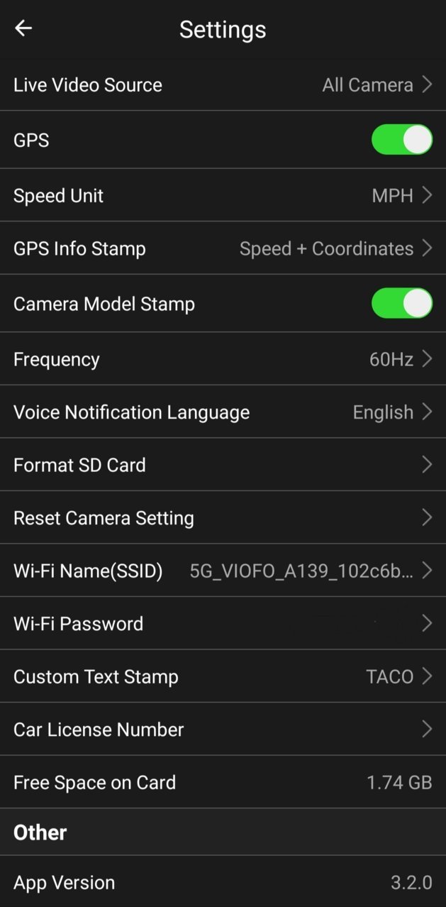

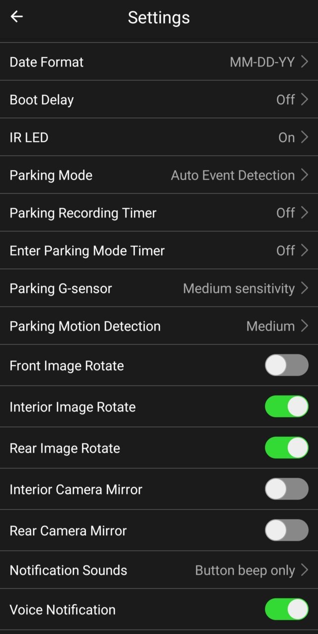

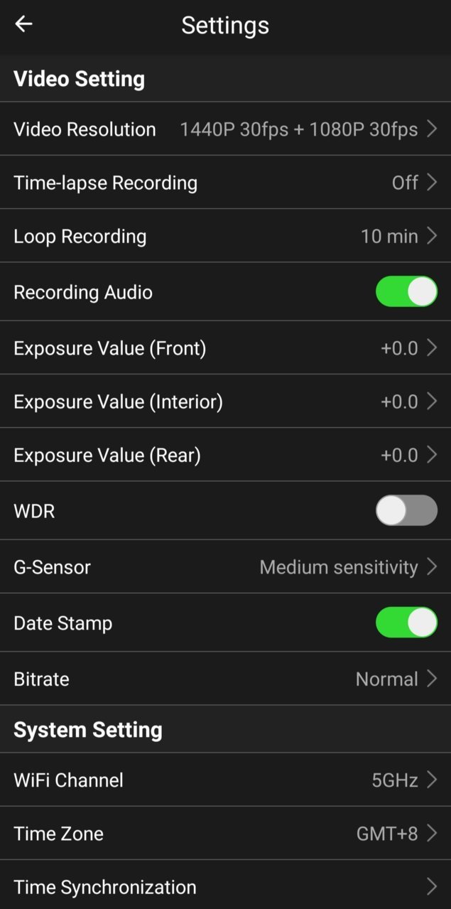

    Over the past few months the A139 has only let me down couples times.
    1. I've come out to my truck to find my car battery is dead. I have the cam wired into my fuse panel and I'm certain I installed everything correctly. Parking mode must be the culprit.
    2. A few times I found the camera has completely froze and had to be rebooted. (I feel like this might also be the cause of my battery dying.)
    But other than that, it's been awesome. I just wish it had a wifi anytime option so that I can check on the truck from anywhere.

    Does it have the parking timer in the settings? If so I would use a timer. Even though its supposed to cut power before your battery gets too low, if you are always running parking mode and not driving enough you eventually are just always running a low battery. Viofo's parking mode is pretty good on some cams, but its inconsistent so not all features are available on all cams. A timer function was something they didn't have a few years ago and when I had reviewed one of the cams for Viofo that was one of the main features I said they should have. If you don't have that feature you might be able to get it with a firmware update.
    I am testing the new Viofo T130 and the parking timer is already in it. I think the A139 did not when I first got it.

    Sorry I just saw your reply. Yeah it has the parking recording timer. :)
    I recently had AAA come check the battery they sold me and the guy ended up replacing it for free. I feel I got a bit lucky there.
    I continue to monitor the voltage on the new one through my head unit. Nothing out of the ordinary yet.
    Ya since the pandemic started I haven't been forced to drive as much as I use to. What would you recommend I set the timer feature to?
    Also, What would you recommend to help it from freezing?
    Thanks :thumbsup:

    I personally always used 12 hours but if I parked somewhere sketchy and knew I'd be there longer I'd switch it to 24 hours. I don't often park in public for long periods tho.
    It's hard to know what's best because different cams use different amounts of power. I am currently upgrading from the blackvue dr900x to the dr900x plus which goes from 6 hour timer increments to hour increments. 12 hour was too much for my 92ah dual purpose battery but I use the 4G LTE which has to use quite a bit more power. After about 5 days it was giving me low voltage warnings. That's one of the cool features of Blackvue cloud cams, your phone gets notifications if your battery is getting low. But I also only drive 10 min each way to work, and any typical shopping I do is only a few min out of the way.
    I'd just keep testing your battery. What I did is used a voltage reader to check my trucks battery in the morning to see how much it dropped over night. Now that I have hour increments I am gonna see if I can manage 9 hours.
