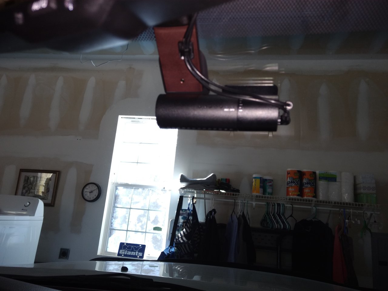

    Installed Blackvue DR590 2ch. the other day. Since I have the ImMrYo mirror relocater on the mirror it was easy to mount but the wires are not run in with the mirror wires. Tucked the wires up under the head liner to the A frame pillar. Pulled the O.S. handle off and the trim pulled right off and pulled the weather seal down,wires went right down. Pulled the kick paned off on the drivers side along with the door sill plates to the back. At this time I wired up the BlackVue Power Magic Pro to the fuse box inside the cab. Since the ACC is a constant on add a fuse there for battery power, and add a fuse to the D RR P/W fuse spot for switched on and well the fuse goes to ground as you all know. Next I drilled and cut a hole in the bottom of the fuse/change holder to pull connector for the P Magic control. Ran the wire for the rear camera alond the door sill pulled the weather seal at the back door, (I have a Access Cab) p to the top. Puller the wire up and behind, pushed up to the headliner and at the rear window pulled the headliner back and grabbed the wire. Idon't use my slidder so thats where I mounted the rear camera in the way that if the slidder was opened the wire would either pull out of the camera or out of the headliner. Put it all back together and fired it up all a ok. Been playing around with settings,have only gone 1/4 mile round trip to farm up the road and back. Maiden voyage wil be Fri. morning.
    Sorry for the lack of pictures but all was done with left arm and right arm restricted I had shoulder surgery a few weeks ago.
    IMG_20171213_090918388[1].jpg IMG_20171213_091019874[1].jpg IMG_20171213_090928561[1].jpg
