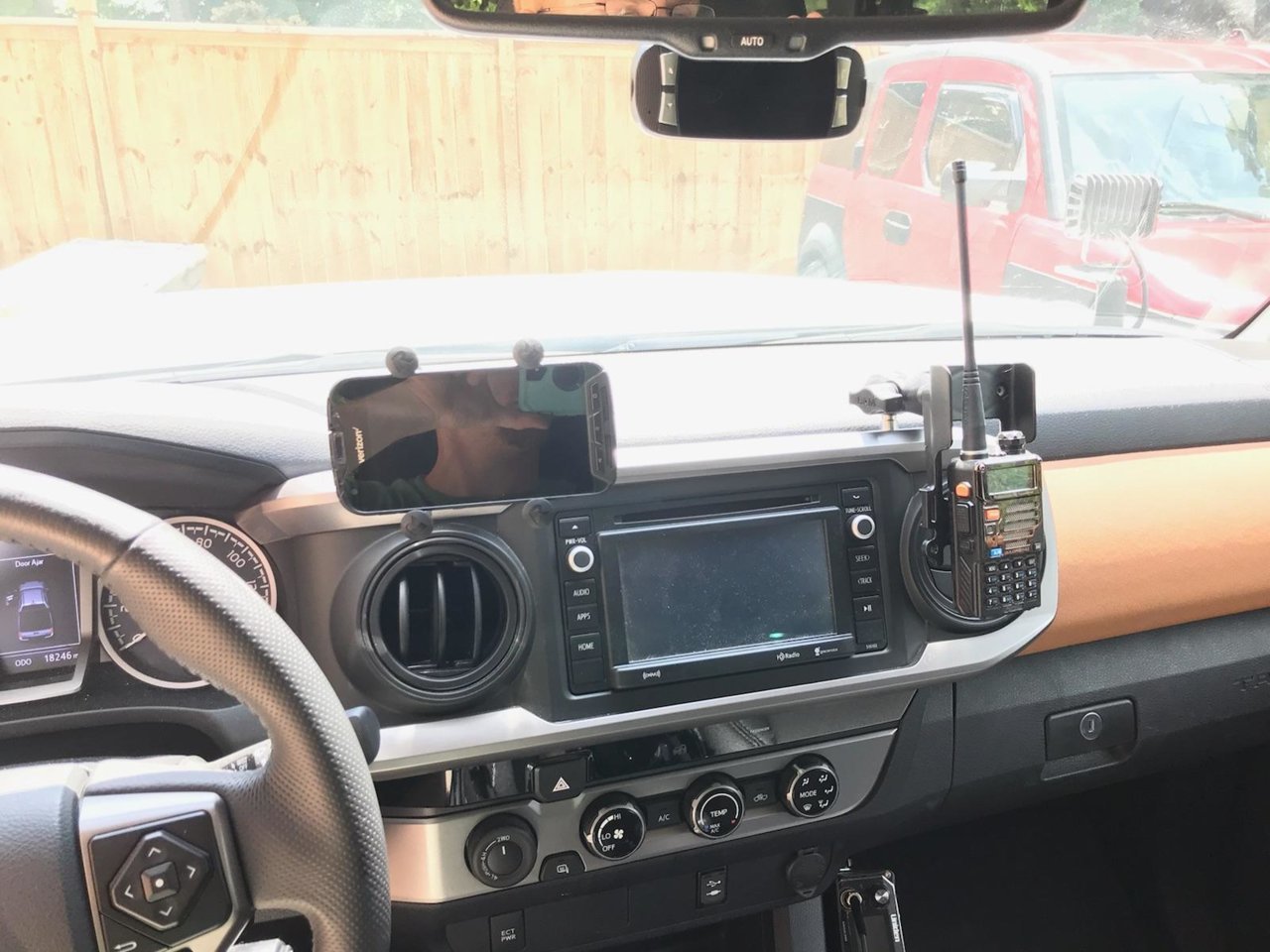

    You should tap in an add-a-fuse and one of these too: https://www.amazon.com/gp/product/B00MH4ZVHO/ so that you have no wires showing. It's a clean install in my Taco. This pic's from the DMM thread, but you can see it's clean and tucked right up under the mirror using that mount:
