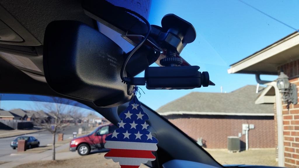

    This is from my post over at Dash Cam Captures of Human Stupidity.
    This is the camera I'm using:
    http://www.amazon.com/gp/product/B00P8F3LD0/
    I have it connected to an aux fuse panel with this converter:
    http://www.amazon.com/gp/product/B00U2DGJOQ/
    For the install:
    I took off the caps
    Used a 10mm deep socket to remove the bolts
    Pull off the cover. And that's where I ran the wire. You'll notice it with the green zip tie.
    Here's the adapter I used
    I put the power cable across the top part of the carpet overhead and fed it to the middle opening. I connected that to the cam.
    Again. This is running to an aux fuse panel that's in the engine bay with always on power.
